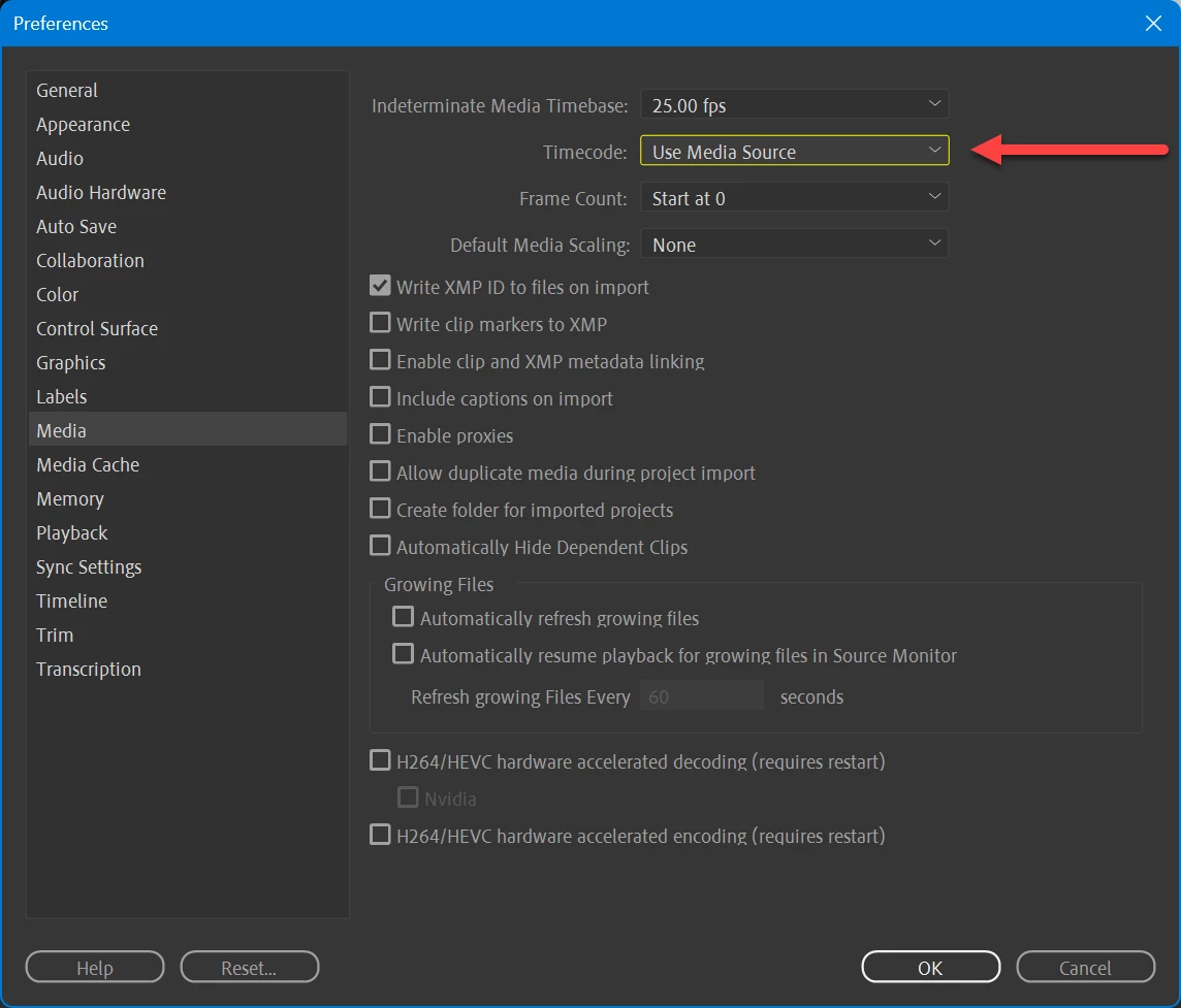

codyh26838561
Jan 31, 2024 8:37 PM UTC
My Timecode setting is currently set to "Use Media Source."
