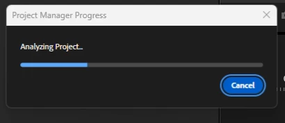

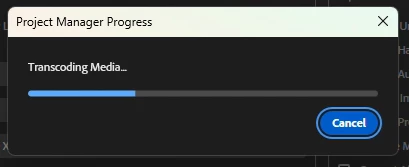

Jun 2, 2025 6:26 PM UTC
The sequence is XDCAM HD422 1080i25. The clip I'm testing with is also XDCAM HD422 1080i25. When I consolidate the project via PPro's UI it all work fine and also see the message 'transcoding media...'
When I do this via the 'SDK Sample Panel' I do not see that message, instead it makes a copy of the project and all I see is the message 'Analyzing Project...'. If I open this consolidated project, the media is also still linked to its original location instead of the consolidated folder.
If it does not transcode the clip, I would at least expect it to be copied, like the PPro's UI behaviour.
