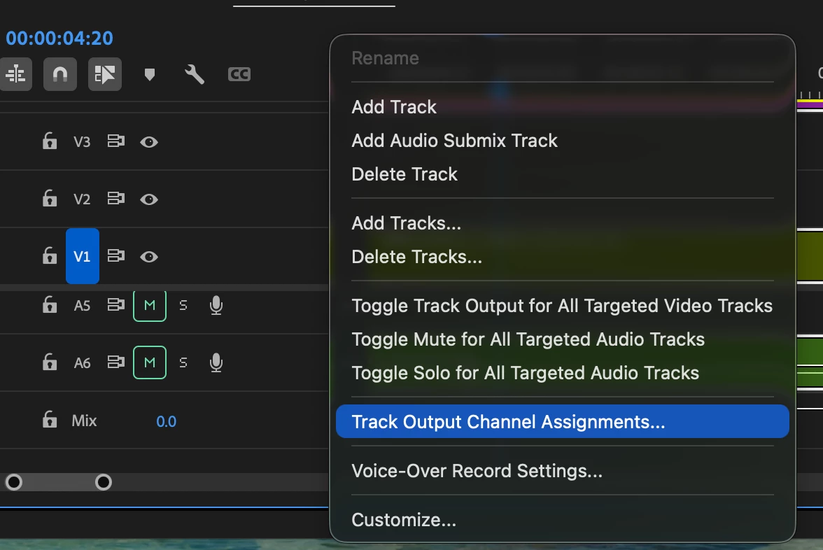

    Hello ​@Lucas Rodrigues films
    Welcome to the Premiere Pro forums! We are glad to see you here.
    ​@rodrigob49755234 is correct that it does sound like a Mix Multichannel sequence. If you can right click next to your tracks and get the option of “Track Output Channel Assignments” then you are in a Multichannel sequence, which may have been how the latest version of premiere interpreted this sequence.
    Right click to right of Mic button on track, before timeline → Track Output Channel Assignments
    Here are some helpful articles for learning how some of the updates impacted audio mixing and routing in Premiere. Please let us know if this does not resolve your issue.
    https://helpx.adobe.com/premiere/desktop/add-audio-effects/advanced-audio-techniques/audio-channel-mapping.html

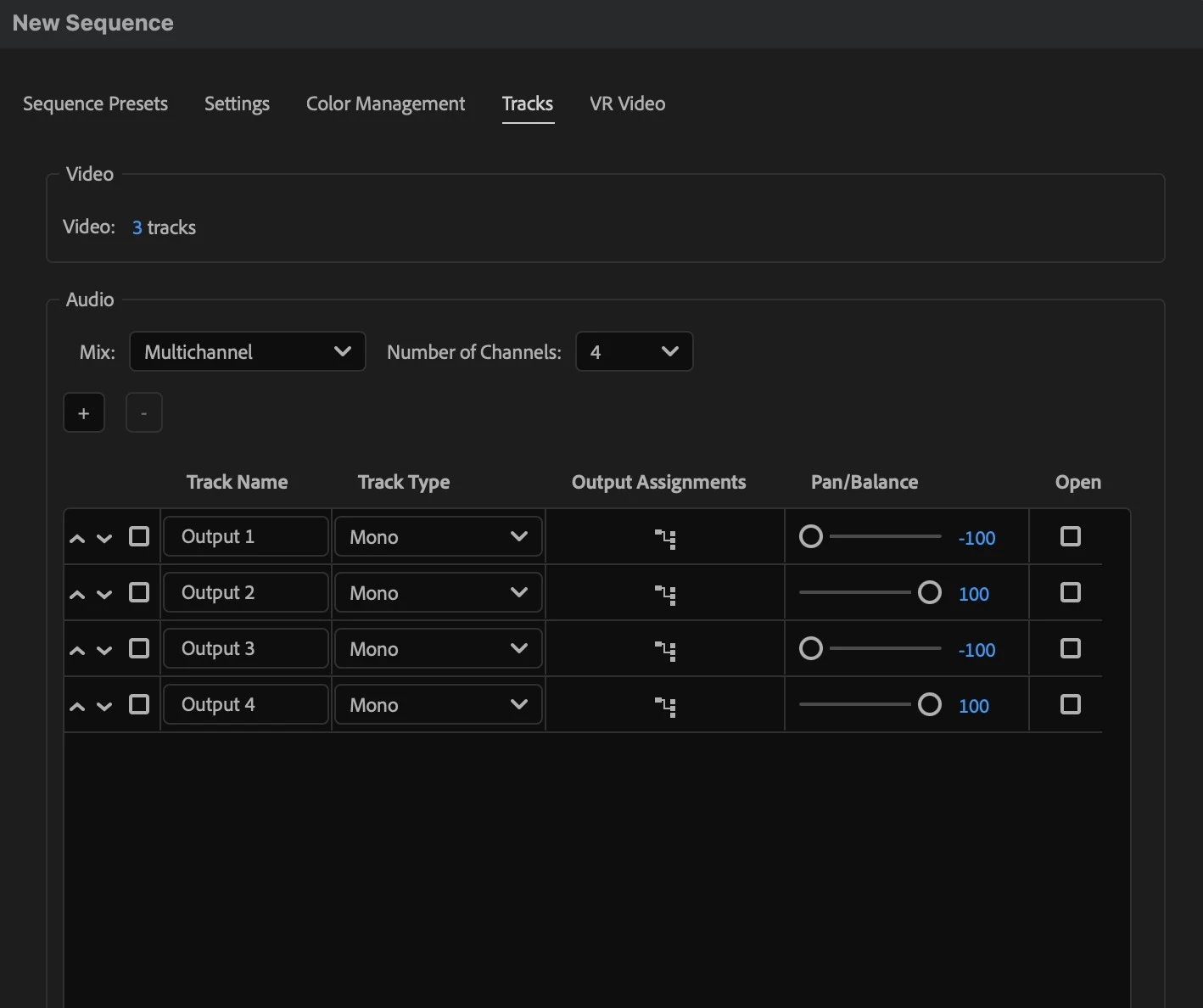

    rodrigob49755234
    May 29, 2026 10:14 AM UTC
    O comportamento que você está descrevendo é exatamente o que acontece se você usa Mix Multichannel em vez de stereo na hora de criar sua sequence.
    Se este for o problem, não adianta você mudar o balance no track mixer, você tem que criar uma nova sequence e ir na aba Tracks e selecionar Stereo na aba Mix.
    Se estiver assim, o audio vai se comportar exatamente como você descreveu.
