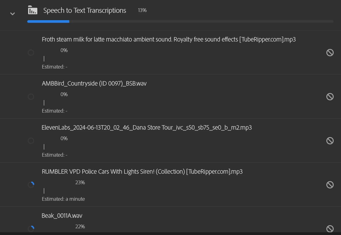

The auto transcription keeps trying to transcribe souf effects with no speech, and music tracks. It keeps doing this, endlessly with no success obviously, no matter how many times I try to kill the process. While it does this my project is unusable, as it eats up every available system resource.
My two options so far are: make those clips offline, which is a pain and only works when I don't need them, or turn off transcription altogether, which then just removes all my existing transcription???

Every Single Time I open the project it tries to transcribe these files, and everytime I have to stop it, while PP freezes or slows down. Sometimes it crashes during this proccess. Oftentimes it also tries transcribing them again later in the day. Nothign I can do permanently resolves this.

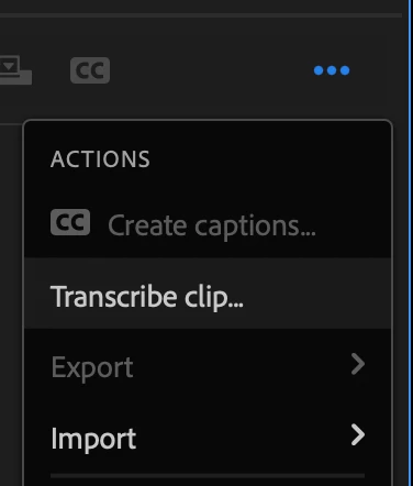

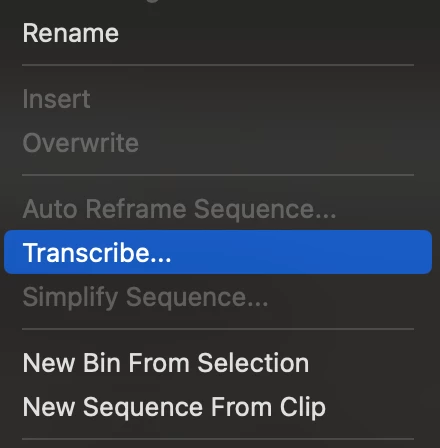

Thanks for your reply - please let me know whenever you can send me a repro or can send me your system config. In the meantime - if you turn transcription off you should have these two options to manually transcribe clips (the context menu in the project panel also works on multi selections):
Context Menu from the project panel:
Flyout menu in the text panel:

Disabling Auto Transcription randomly removed some existing transcripts but not all. I have since re-enabled it and offlined the trouble clips so that I can get the work I need done done. When it was off I tried to use the "transcribe source" feature but that seemed to be missing ...?
The trouble with "Only in timeline" is that I am importing these SFX and music to use IN timelines, so as soon as I drop them in it sets off the Auto Transcribe: back to square one.
Your two suprises:
a) Yup, I have cancelled the transcription on SFX of a milk frother, police siren, and outdoor ambience about 25-50 times each now. They always come back.
b) It kills my resources to the point that editing is functionally impossible. Moving a single clip on the timeline almost crashes the whole program. It resolves immediatly soon as I turn off all transcription.
