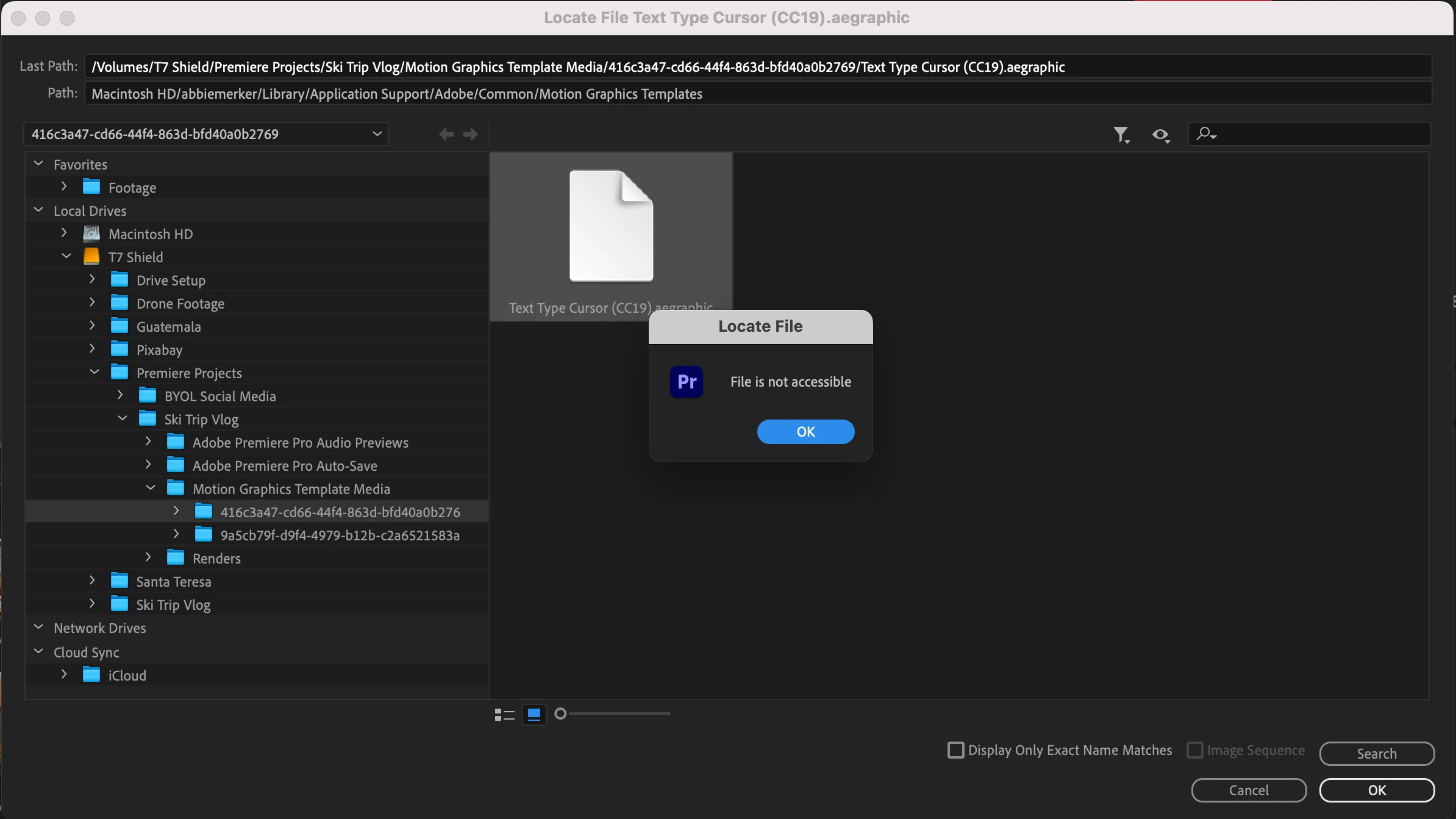

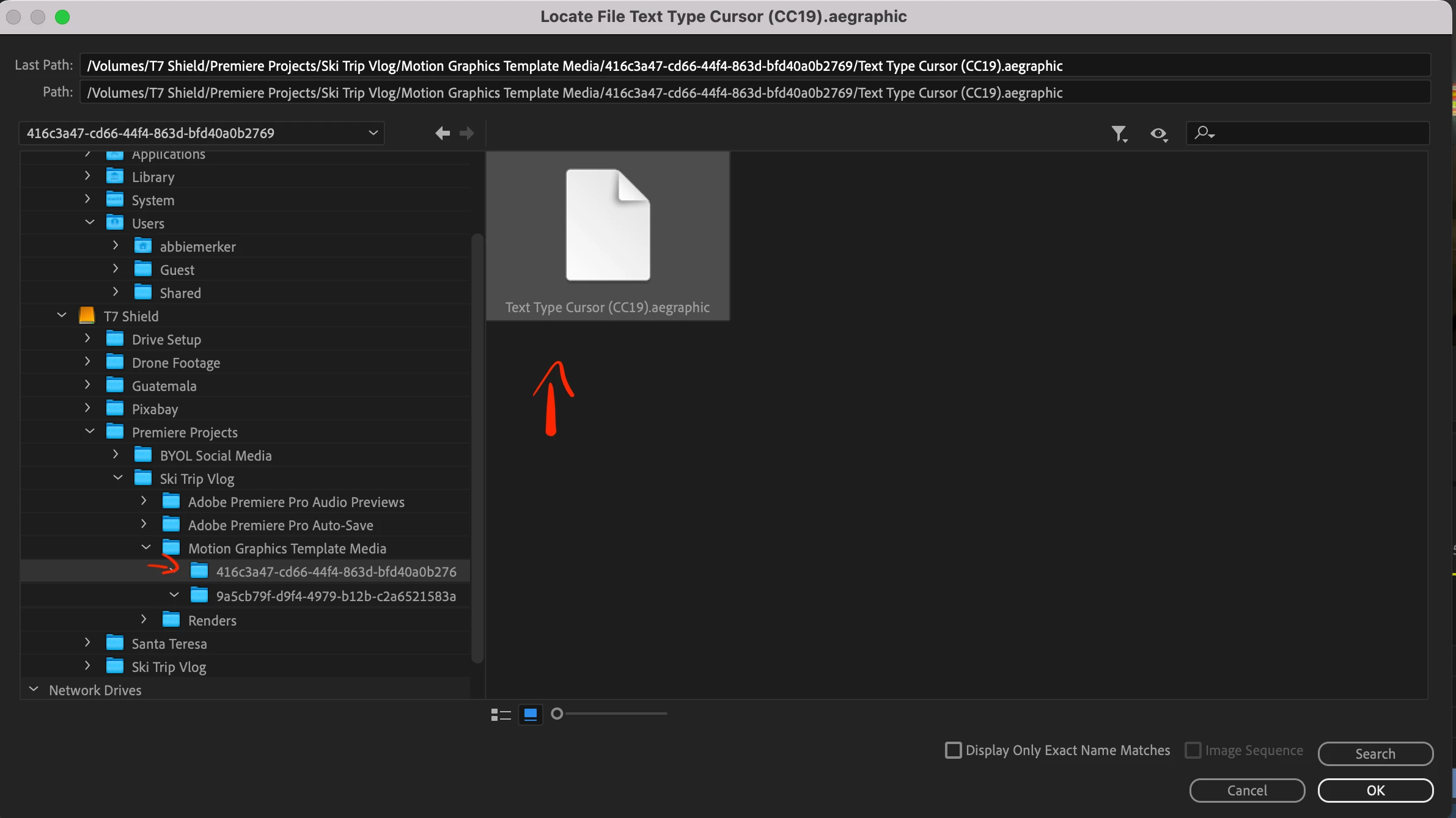

I didn't realize that premiere makes new files for the mogrt after they are used in the timeline. I checked next to my project and saw the Motion Graphics Template Media folder with 2 random letters folders inside, and located my template. I was able to locate the file and relink, but the file is still ofline and red in the timeline after trying to re-link. Here is what I see when locating the .aegraphic file next to my project file:
I also tried using the 'Macintosh HD/username/Library/Application Support/Adobe/Common/Motion Graphics Templates/' file path just to see if it would find the essential graphics panel copy. I tried with and without the / at end end of Motion Graphics Templates/ and both led to this answer:
I can use a work around on this issue and re-do the motion graphics for now, but I am curious how to solve this issue if it happens again.

When it comes to mogrts, they are read by Premiere Pro as an .aegraphic after they are applied to the timeline. A folder named 'Motion Graphics Template Media' is created next to your .prproj file. Inside it will be folders with random IDs, inside those will be your aegraphics. Use those to relink your mogrts.
The folder that the Essential Graphics panel uses for mogrts is
I think you are looking in Macintosh HD/Library/Application Support/Adobe/Common/
