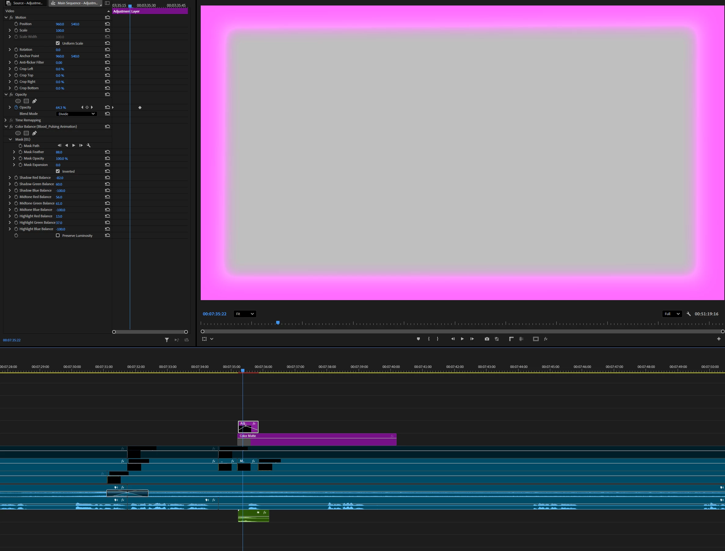

I'm trying to use a simple Color Balance effect to green, with a single mask to make it a little green outline around the edges. It's a short 1 second effect, keyframed for opacity to go from 0% to 100% and then back down to 0%. It generally works fine at first and so I just copy>paste it when needed on an adjustment layer.
At some point in the timeline, this effect stops working. Regardless if it's on an adjustment layer or on one of the videos directly, it doesn't apply the effect.
Currently I'm 7min35sec in. I've used this adjusment layer with color balance effect applied - 6 times. If I go back to the previous ones, they work. When I copy paste the adjusment layer the 7th time now, it doesn't work anymore. There are no more effects applied and blend mode is on normal. There is only two clips running simultaneously. There is still the red line below the timecode showing up, if I render it out, the effect is not applied.
If I try to add a new adjustment layer with the effect. It works again at displaying colour and masked, but if I start keyframing opacity, it does't animate it. Just stays green for the duration of the adjustment layer. All previous ones still work as expected, just none of the future ones.

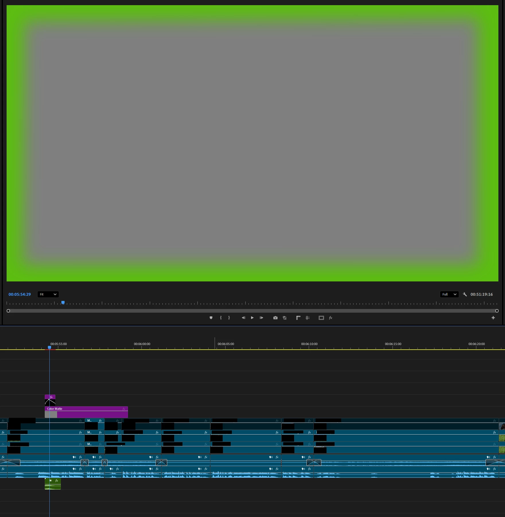

I've tried to play around this time, to get some examples for this post. If I set the "not working" adjustment layer to "divide" blend mode, when certain background colour is present, it works. It's the only blend mode to have any effect, but it obviously doesn't do what I want (Pic3).

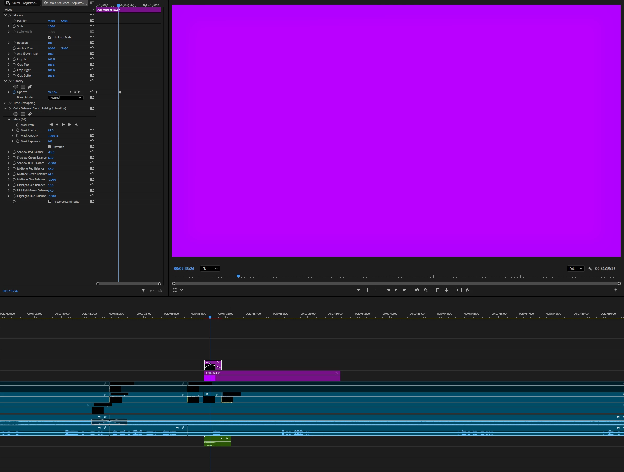

As in my example (Pic2), I've changed the bacground color to purple to reflect the problem on the effect not working. When I've kept the grey one from Pic1, it worked. But if I disable the layer the effect doesn't work on the actual video again. I want to stress that previously the effect worked on the same background. It's a single long take video, it has the same background throughout. The effect works at the beginning, but not later on.
This has happened countless times. Global FX is not muted. If I reload the project, the problem persists.
