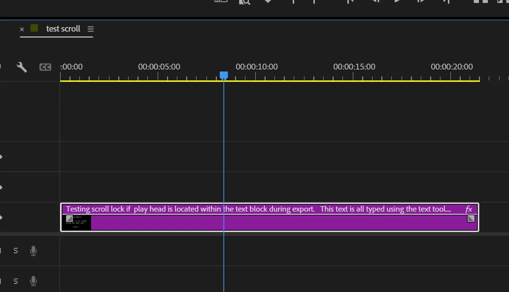

Credit roll frozen in exported file Premiere 26.3.0 Build 93 . Determined that this happens when the playhead is stopped within the credit roll when exporting. Move the play head away from the credit roll and the Export is fine.

    I have made this a simple as possible. A new 1080p 25fps timeline. I typed the text using the text tool. One export with the playhead half way through at 10 seconds (plays with freeze of text), one with the play head past the end of the text block at 25 seconds (plays with scroll).

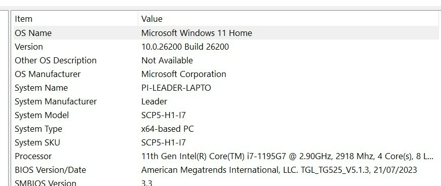

    Hi Amy. Tried all of those. The GPU is my default. All monitors are plugged into the graphics card. Checked the Intel setup - is OK. Curious that you suggested a render, as the timeline is yellow, not red for render (attached screenshot). I did one anyway, but it made no difference. I am still wondering why the issue is there for completely different generation computers and GPUs, yet you can’t reproduce it. Further testing this morning on my entry level i7 Leader laptop (see attached system spec) gives exactly the same results (had to disable a licence on my main machine to enable 2 versions to be active).

    I am using Windows 11 machines, current release - Windows 11 pro 10.0.26200. One is an i7- 8700, 7 years old with a Quadro 4000 GPU, the other is brand new with an Ultra 7 CPU and 5070Ti GPU. Both with 64GB RAM. The problem is identical on each machine regardless of sequence settings. If the playhead is WITHIN the credit text box area of the sequence, the exported credit roll is static, if the playhead is NOT WITHIN the text box area, it scrolls fine. One is exporting a 1080p 25fps from a 4K timeline, the other is exporting from a 1080p timeline. Both GPUs have their current studio drivers. The credit roll was created in Premiere with a Text box and text pasted in from word or an email. I have another major issue with Premiere hanging up, but will report that separately.
