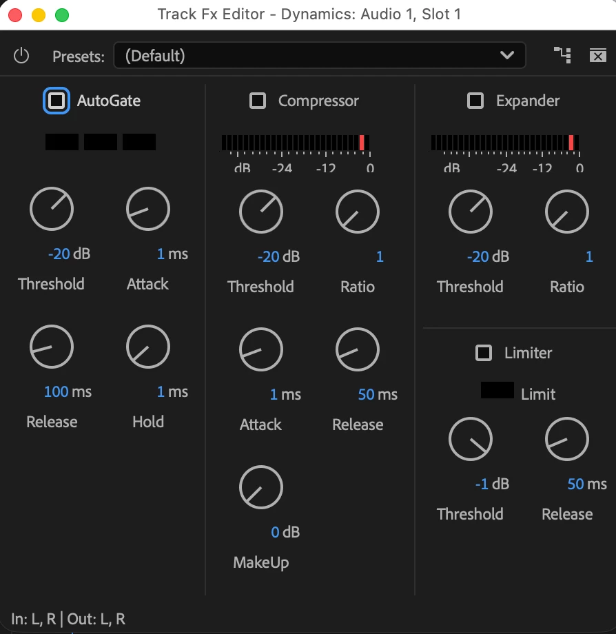

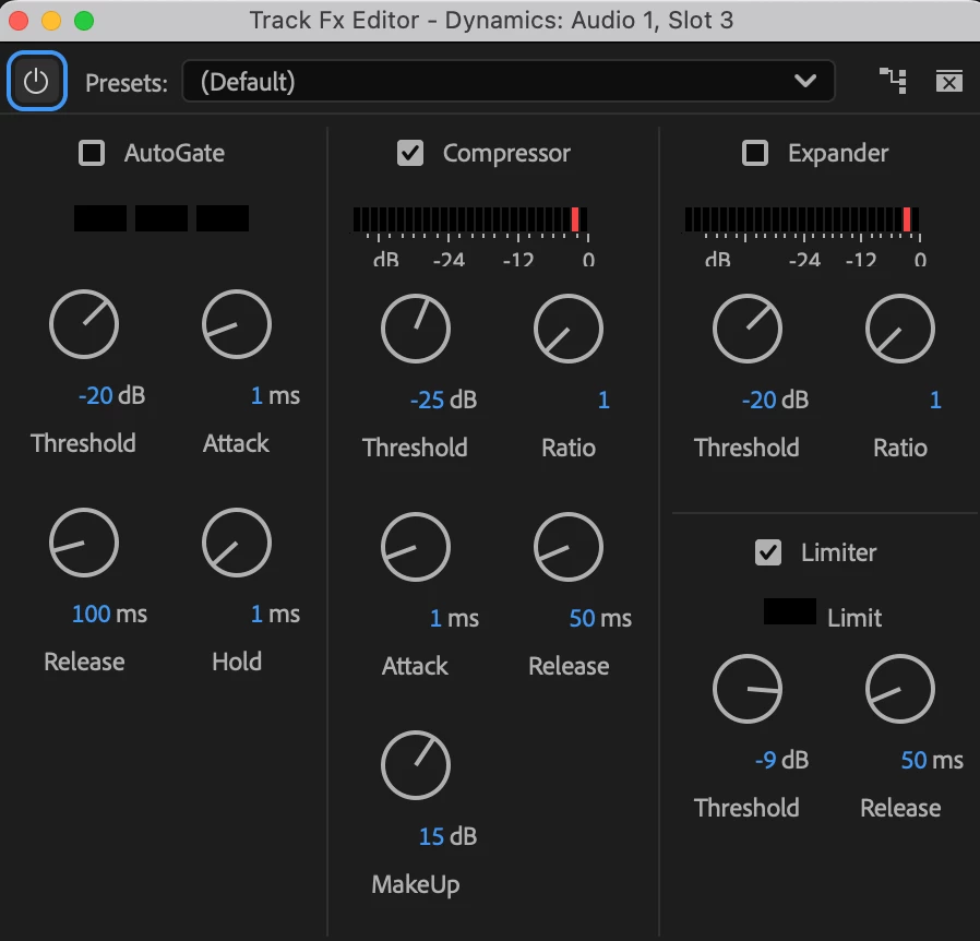

    Hi Katie - can you listen again? In this recording, you can clearly hear clipping happening during the transitions of the two clips while they are on A1. Once I move them down to A3, the clipping disappears (the fades actually work).
    Here are my settings for the Dynamics effect.

    ​@Christina27152685lv9w Thank you for that screenshot with Gate. Ahhh, okay so by ‘clipping,’ you mean that the constant power transition isn’t seeming active on those top tracks where the effects are present, so the audio just cuts out and back in like no transition/smoothing is in there. And then once dragged down some tracks to no effects, the transition is as expected.
    We originally thought ‘clipping’ as in going into the red, pops, or clicks and perhaps I should have clarified, but think we’re on board now. That does seem like rather odd behavior.
    We’ll run a test on our side to see if we can recreate this as well, or we may want to request the simplified project file and a couple sample media otherwise.

    Wonder too, what’s your Dynamics look like with regards to ‘Gate’ - see screenshot. That could be creating extra cutoff than intended but seeing actual settings would be helpful there.
    Give that a go and let us know if that helps! If you have any other examples, feel free to attach here and we’ll take a looksee.
