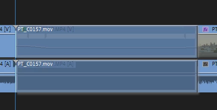

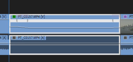

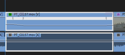

It seems to be working for me. (v24.1 Win11 22H2)
I took a clip and applied time-remapping.
I took that clip from Explorer and dropped it into ShutterEncoder and made a ProRes proxy file
Imported that file and Alt-Dropped that file onto the original, and it seems to have worked.
(BTW: The screen shot below is w/out the Alt key, as my snagit, doesn't work with it pressed - but I did hold it as I dropped it)
