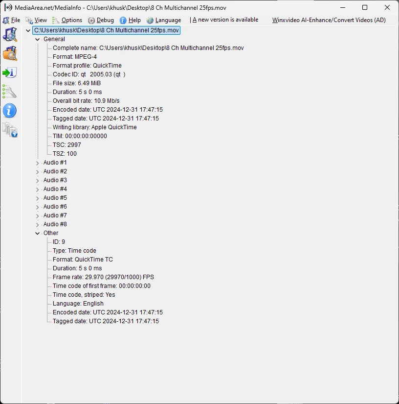

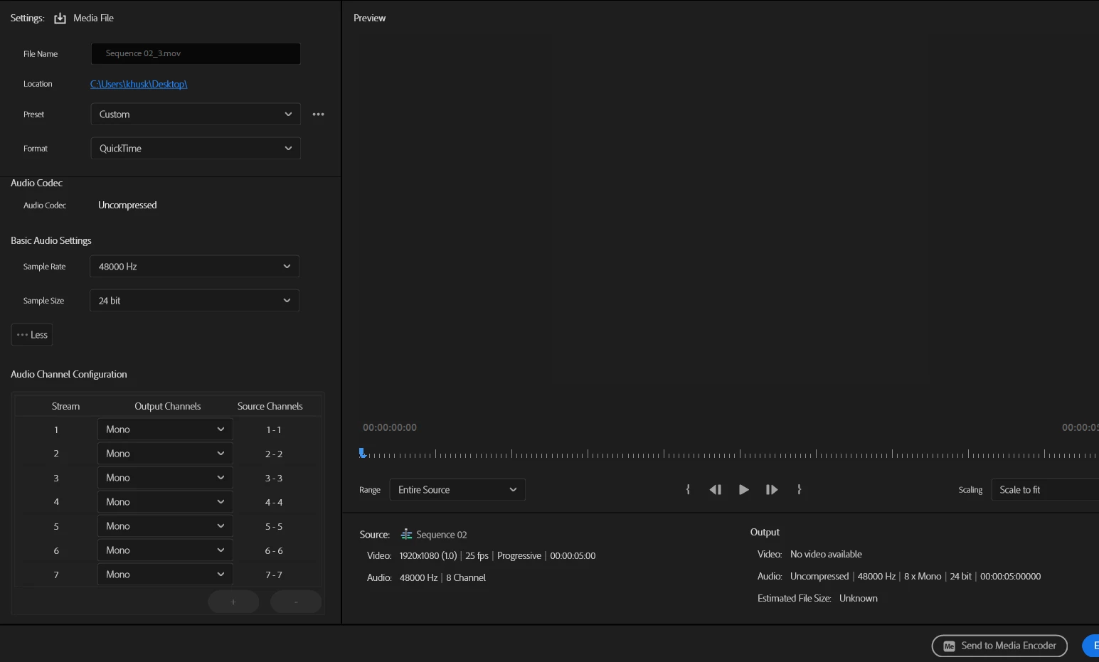

I am able to reproduce this issue when using an 8-channel 25fps 1080p progressive sequence with the following export settings:
All other settings are default other than bit depth, and the discrete 8-channel multichannel configuration.
the resulting exported file has a TSC metadata tag of 2997, and a 29,97 timecode stream according to Media Info, and also Premiere if the file is reimported:
Please also find here a download for the project file and exported file I used to replicate the bug:
https://drive.google.com/file/d/1HDu1e1nNCKajR5dRhXZFC_DF2weafA4h/view?usp=sharing
Exporting the file with video results in a 25fps TSC tag and timecode stream as expected.

Hi there,
Sorry about the poor experience. I am unable to repro this at my end. Would you mind sharing a detailed screenshot of the export settings that you have used? Let us know the version of Premiere Pro & the OS that you are using. It will help us diagnose the issue properly.
