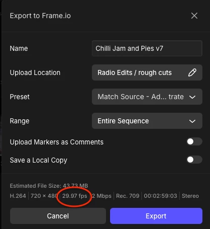

@Patrick Southern  here is a screen grab showing the purported change in frame rate between the sequence settings at 25fps & the export setting mysteriously changing to 29.97fps…

Hi @Patrick Southern I've actually (temporarily) moved up to editing this project on 26.0 Beta to see if that helps with the Frame.IO; there's a couple of weird things that I've noticed with the Frame.IO panel in v26.0 Beta: there's no indication in the panel when a file is actually exporting or uploading (I have to open the web browser version to at least see when a file is uploading); also, I'm working at 25fps, but the export settings appear to indicate that my exports are exporting at 29.97fps (although when I've checked the exports on the web browser, that's showing them as being at 25fps). However, using 26.0 Beta Frame.IO window, at least my markers aren't be deleted & replaced by the markers from previous versions that I had uploaded to Frame.IO!
