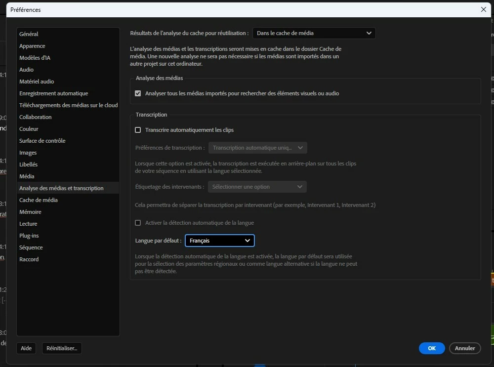

    Welcome to the Premiere Forum and thank you for posting. I’m wondering if this is related to a known issue we just uncovered where an improper language model might be triggered for the transcription of the sequence.
    I know you said you have configured the transcription language to French, and your initial transcription proves it, but could you double check if this is also set within “Premiere → Settings → Media Analysis and Transcription” and that “Enable Language Auto-detection” is unchecked?

    Bonjour,
    Oui effectivement j’ai bien décoché l’auto-détections et bien mis en français. Mais ça ne résout pas le problème
