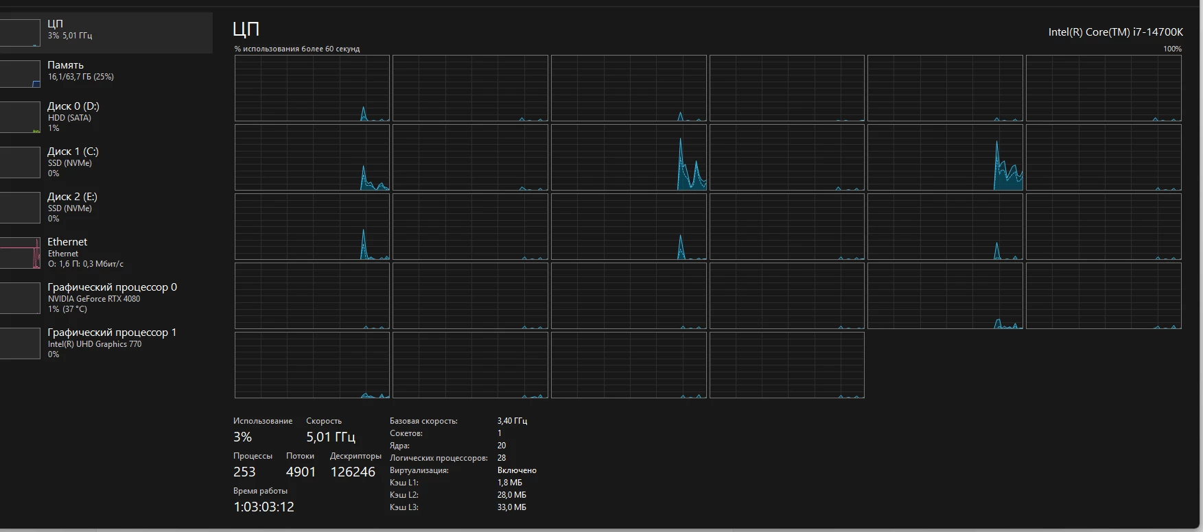

    Hi, again, Rach
    My PC is 14700K, RTX 4080, 64 Gb of DDR5, SSD, MSI mobo. Premiere Pro 25.6.4, Chrome 144.0.7559.133 (it updated to a higher version after I typed it, but nothing changed).
    About the task manager - when I said this “CPU, iGPU and dGPU load is reduced to 0” it was exactly based on the Performance tab readings.

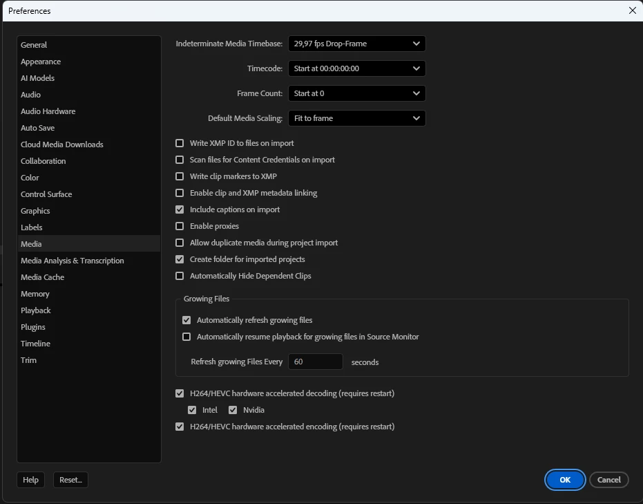

    All my drivers are up to date. I have Intel Driver assistant that loads with Windows and informs me about updates for my motherboard and iGPU, so I install the drivers the day they come out, and I also update NVidia driver as soon as I see the notification. The only thing that is not the ultimate one is Windows - seeing how many bugs there are in Win 11 25h2, I still stick to 24h2. I don’t think this could be an issue.
    Hardware dec is always on.
