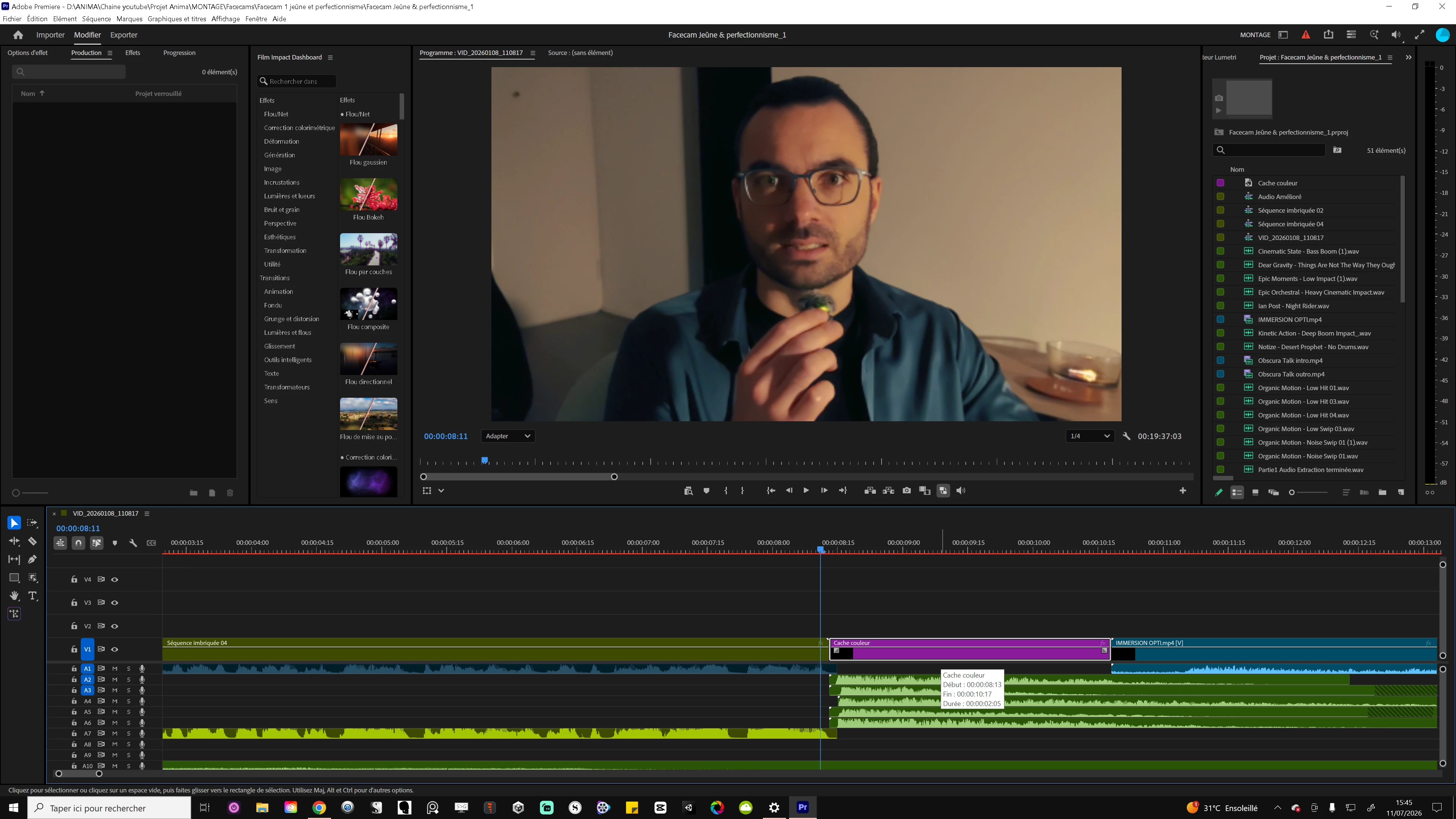

    Syneos
    SyneosAuthor
    Jul 11, 2026 1:49 PM UTC
    Hi ​@Syneos,
    Welcome back the Premiere Forums and thank you for submitting this report about this export freeze. The team will need some more detail to try and help with this:
    • Premiere Version: What is the exact version of Premiere you’re using when the issue occurs?
    • Operating System: Specify macOS or Windows along with the version.
    • GPU Driver (Windows only): Please let us know your video card driver version. We recommend updating to the most recent version; for NVIDIA users, we strongly recommend the Studio version of the driver.
    • Playback Format: Please specify the format (and ideally share a sample video if possible).
    • Would it be possible to share screenshots or a screen record of your Premiere timeline?
    • Does it affect other projects as well?
    For additional context, here are helpful links about Premiere 26.3:
    Best,
    Jonathan

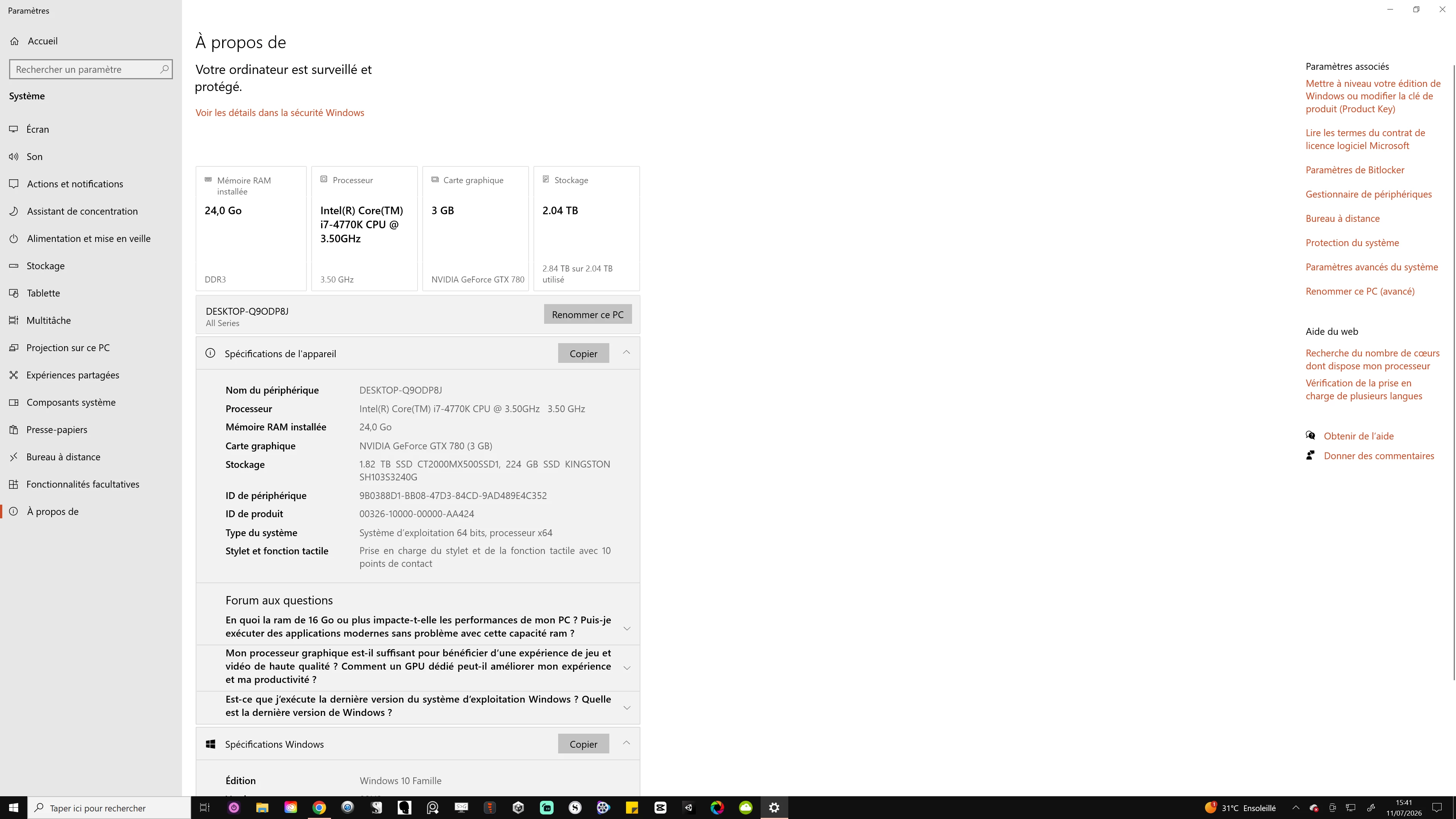

    I am using the latest version of Adobe Premiere.
    Here is the relevant information about my system (I know my graphics card is very old; I get a notification about this when launching Adobe software).
    As for the format, it is 1080x720p or sometimes 4K.
    Examples here: https://www.youtube.com/@syneostudio/videos
    This affects all my projects whenever I try to use that same abrupt transition.
    In the screenshot below, you can see a purple layer—it’s a color matte—but the problem persists whether that layer is there or not. The issue occurs right at the end: the video freezes instead of cutting to a black screen.
