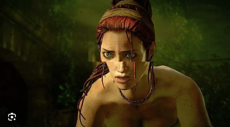

    Unfortunately because of the high client profile nature of the projects I work on (plus NDA), I cannot share a screen recording of the issue or screenshots. But it’s basically like this screenshot, on multiple horizontal lines of the image that moves back and forth when playing down the timeline.
    The refresh rate of the Windows Display Settings for the BMD always matched my timeline timebase. So for ex, if my timeline is set to 23.98, the hz in the display settings for the BMD would be set to 23.98hz. Same goes for 24 or any other frame rate. The timeline timebase is what will determine the hz refresh rate of the BMD in the Windows Display Settings.
