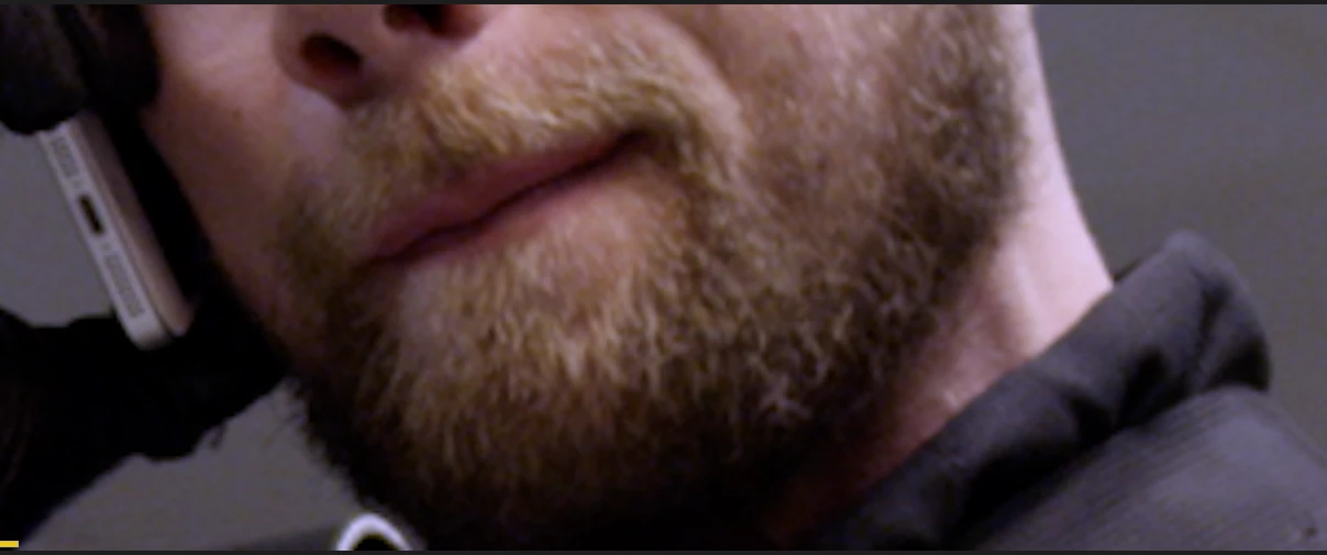

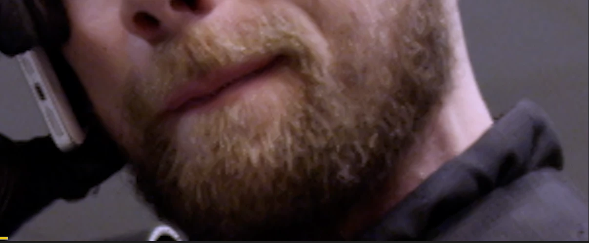

Nov 4, 2025 8:35 PM UTC
Hi Neil,
i know you are trying to help.  But what you have been told by experienced b-cast editors only applies to native interlaced footage.
When dropping PsF material (which is inherently progressive) onto an interlaced timeline and choose progressive during export you are basically de-interlacing progressive material. Which leads to lack of sharpness and jaggies. i have attached 2 screenshot zoomed in that show the difference. Not Sure if the image quaility comes across in this forum.
We flagg this issue all the time during QC because alot of editors dont seem to know the difference between interlaced and PsF.
As for you trying to recreate the issue. Please follow the steps i described.
But most of all i would like to hear from Adobe.
