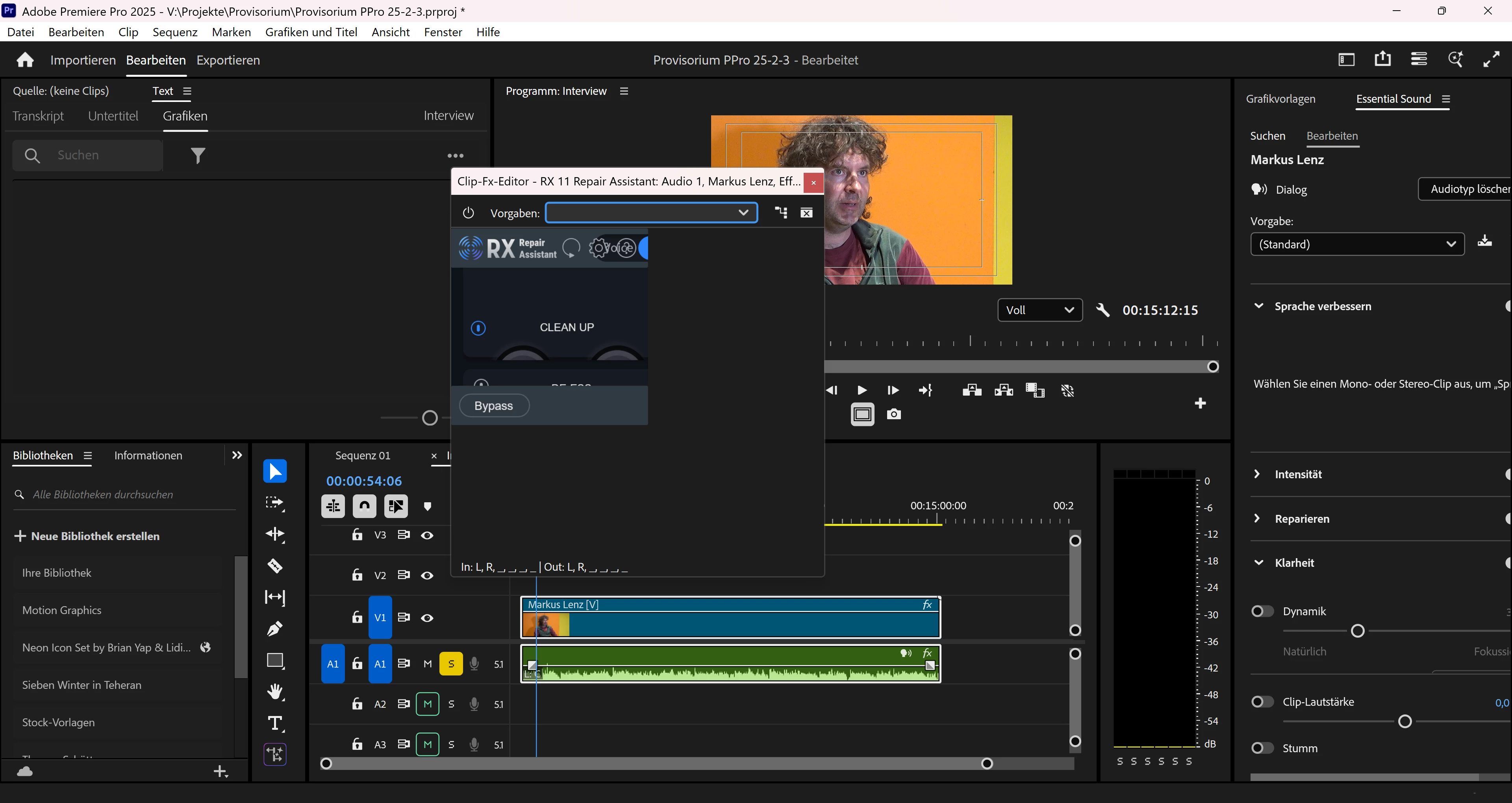

I know that this issue was discussed already in another thread, but since we still got no solution to it I thought I should open a new thread.
The problem: As soon as I changed from PPro 24.6.3 to PPro 25.2.3 (Build 4) the "RX 11 Repair Assisstant" can't be used any longer because the user interface is cropped within a window. I can change the size of the window but that does not change the user interface of RX 11 - it stays cropped. In PPro 24.6.3 ist worked perfectly.
I am on Windows 11.
Any ideas?

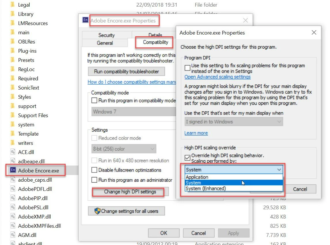

I found an even better solution to my problem. As suggested by Ann Bens in another thread dealing with RX 10 as can be seen in the picture attached. The picture shows how to handle the problem in Adobe Encore but I tried it with PPro and it just works fine.
