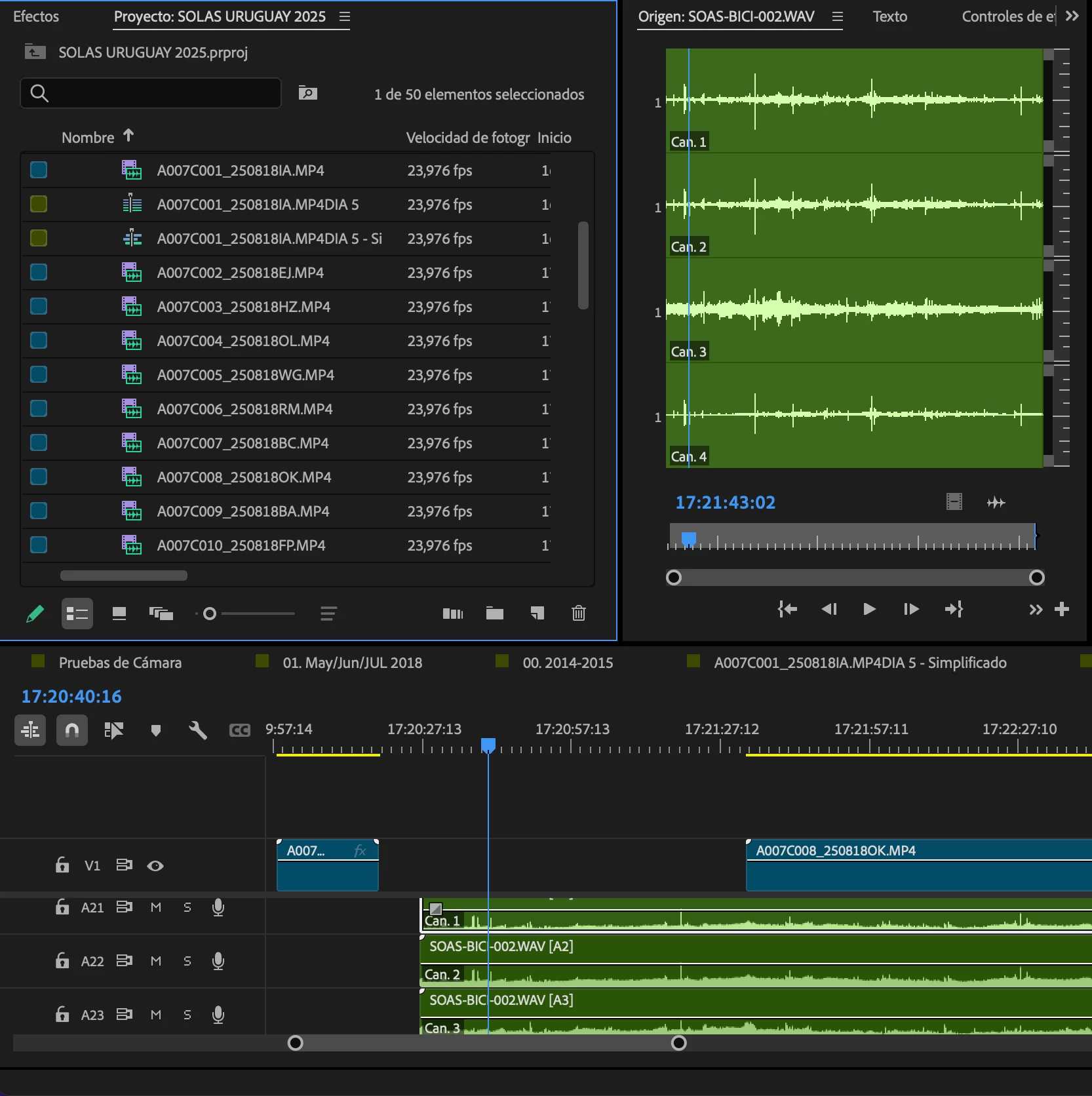

Sadly, it also happens when syncing standalone WAVs with video. It places video in the right time in timeline, but fails to place audio in the right timecode according to the very informetion embedded in its files (as it can be seen in my screenshot with the timeline clip matched in the source panel). If I manually place the audio in the right timeline timecode, according to the audio's timecode, it works. You are almost there!
