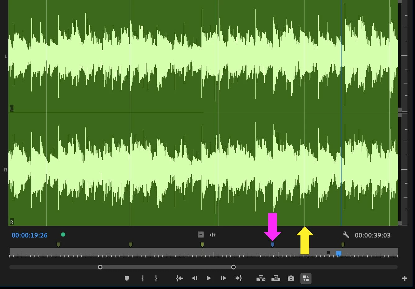

Marker positions are not scaled properly when clip duration is changed: when I add markers to a clip and then add it to the timeline, I expect to be able to snap other clips, or the play head, to those marker points when snapping is enabled. This has worked properly in PP for many years.
The problem I have encountered is when the clip is sped up by, for example, changing the speed to 120% in the Speed/Duration dialogue, the marker icons are also scaled and moved to where they should be on the sped up timeline (good), but the actual snapping point in the clip (shown as a thin vertical line in the Source Monitor) seems to have not been scaled properly and becomes offset from the marker. The result is that trying to snap other clips to the marked points in the sped up clip no longer works properly.
See the attached image: this is the sped up clip viewed in the Source Monitor. The pink arrow points to my blue marker which is where I want it to be after the speed change. The yellow arrow shows the line that things snap to and should also be where the marker! They are linked - if I move one with the mouse, the other moves with it!
