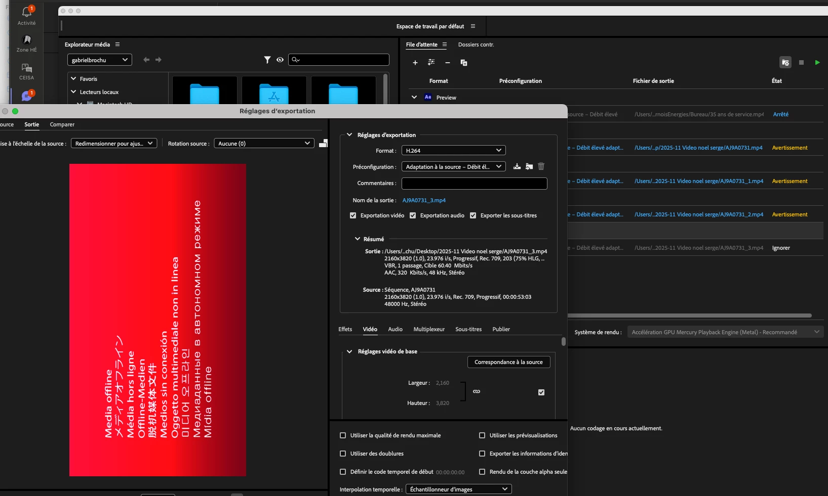

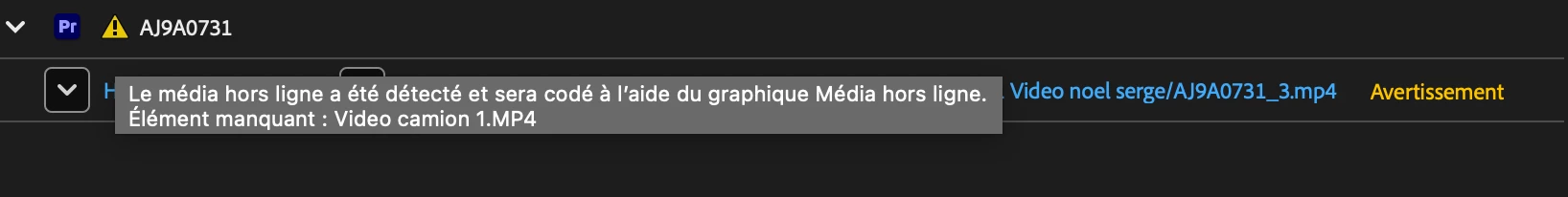

I recently updated Premiere Pro to 25.6.2 and since then I can't export because PPro and Media encoder think my medias are offline. I tried to export previous project I did last week and this doesn't work eithier even tho it worked last week. It gives me the same error in media encoder ( in french, here is the translation ''offline media detected and will be encoded using the offline media graphic'' )
Here are the steps and solutions I tried in order :
- creating a new project and importing media;
- unlinked and then linked the media;
- changed media to a different folder and then linked;
- deleted ppro, media encoder and mac cache;
- restarted my mac;
- rolled back ppro to the previous update;
- opened a privious project that I successfuly exported last week and now it says offline media;
- updated mac to Sequoia 15.7.2 from 15.5.something;
- renaming media and linking it.

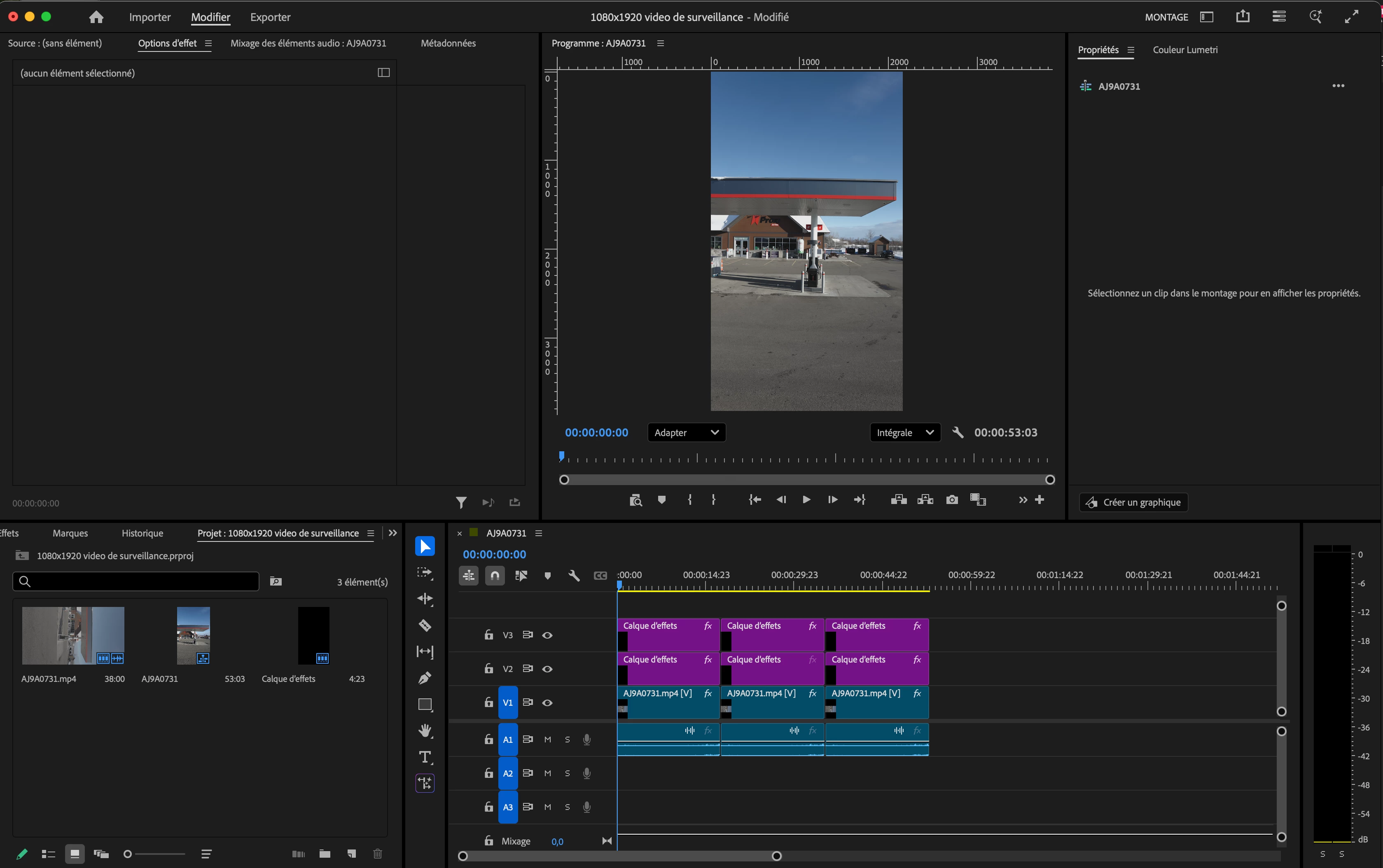

when I work on my timeline the medias load properly and can playback the video without any problems. Also when I look in the event window there are no problems.
The problems seems to be only when I try to export where I see the red frame.
The only solution I have not yet tried is uninstalling and installing Media encoder but I doubt it will work. All my medias are stored locally on my computer in files and subfiles. I have been doing the same method for a long time without any problem and starting to be out of solutions for this problem.

My source media are mp4, the effect I used were wave warp, noise, color lumini and a lut. I can't export even if I delete them. I have tried another project that I successfuly exported earlier this month, but when I tried again on the 25th it did not work!

No! Usually I export my media with the export button within Premiere but the button stoped working too since today. When I click export nothing happen and this is why I then tried with Media Encoder. Media encoder is also updated to the latest version 25.6.
For Media Encoder I found a fix I unticked "Import sequences natively" in the AME general preferences and then I was able to export. Previously this option was ticked and it worked. But I would still like a fix for the export button in premiere to work and for Media Encoder with the option ticked like before!
