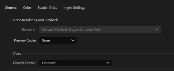

MKV Files Trigger “Frame Substitution Recursion” Error Render Settings in Version 25.2
Could everyone please let me know if, after updating to version 25.2, it’s possible to modify the render settings? It’s not just limited to Premiere Pro or Media Encoder—on my end, all of them appear grayed out. However, After Effects still allows its settings to be configured.

Hi @C27618681pmp5 - Software Rendering has been removed in version 25.2.0 please see this article. Software rendering option removed
Can I ask what you need software rendering for?

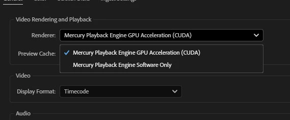

Apr 13, 2025 3:37 AM UTC
I use Influx’s plugin to read MKV files recorded from OBS (using NVENC x264). In version 25.1 (render : CUDA)
, when I dragged the file into the timeline for playback, everything worked fine. However, after updating to version 25.2, the file only shows a black screen, and I keep receiving the following message on the file: "frame substitution recursion attempt aborting after multiple attempts." Reverting back to version 25.1 makes everything work normally.
I have cleared the settings and tried every available reset method, but the problem persists.
On another computer that can only use Software Only mode in 25.1, updating to version 25.2 does not encounter this issue.
It is not that I insist on using Software Only mode; rather, the current behavior in version 25.2 prevents me from working properly.

Apr 12, 2025 2:50 PM UTC
Render settings cannot be changed.
If it's not set to MPE hardware by default, you most likely have a GPU that is not compatible or outdated driver.
AE's hardware acceleration is not the same as Premiere MPE.
Please post comp specs and OS.
Apr 12, 2025 5:42 PM UTC
Is it true that MPE cannot be modified?
I was able to modify it after reinstalling version 25.1. It only becomes grayed out when installing version 25.2.
