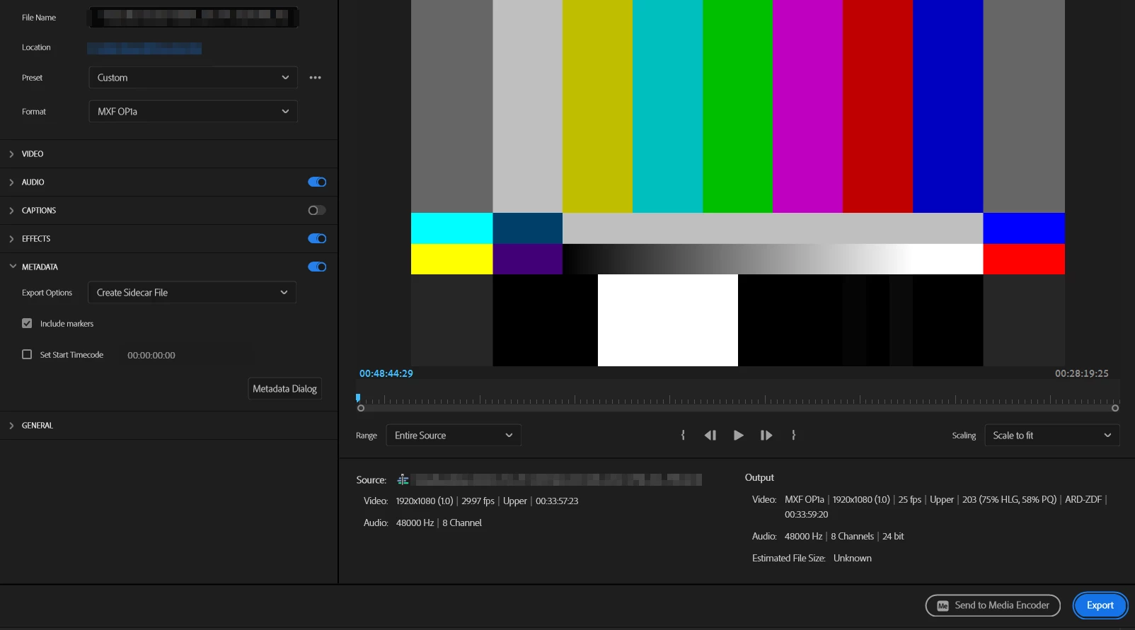

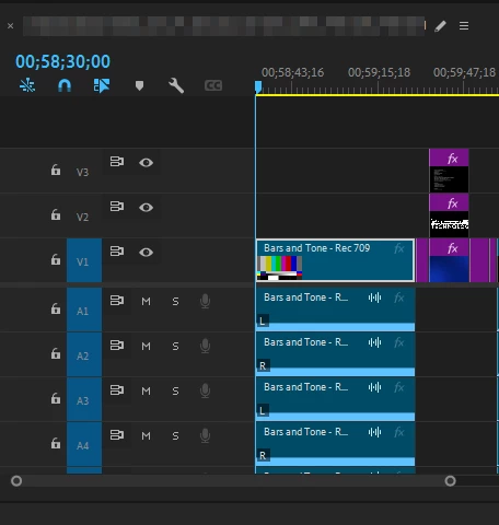

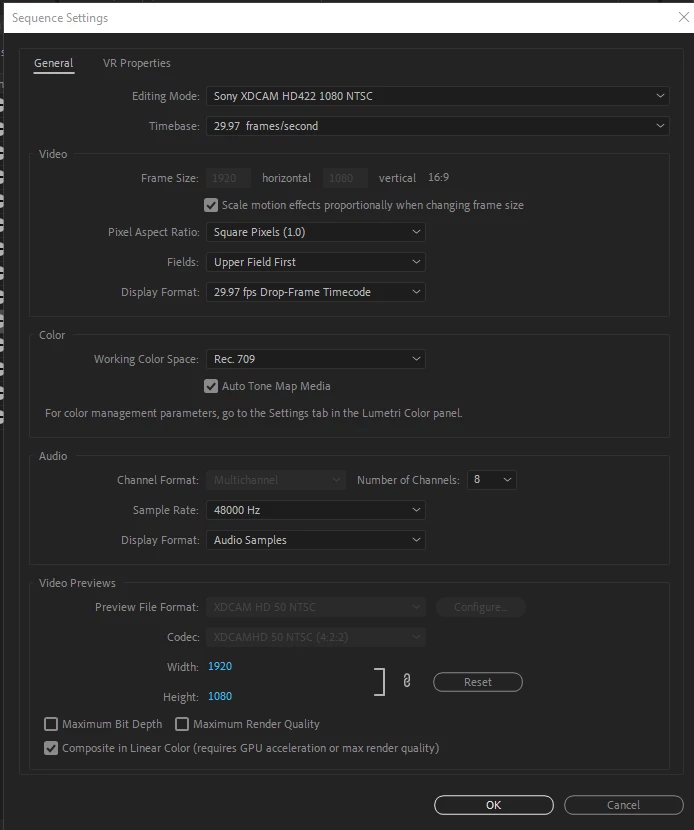

Hi Bruce I hope you are well, about the Custom Start TC, I'm using the settings below in the sequence:
This is the custom TC IN: 00;58;30;00:
This is the export changing the tc in to 00:48:44:29:

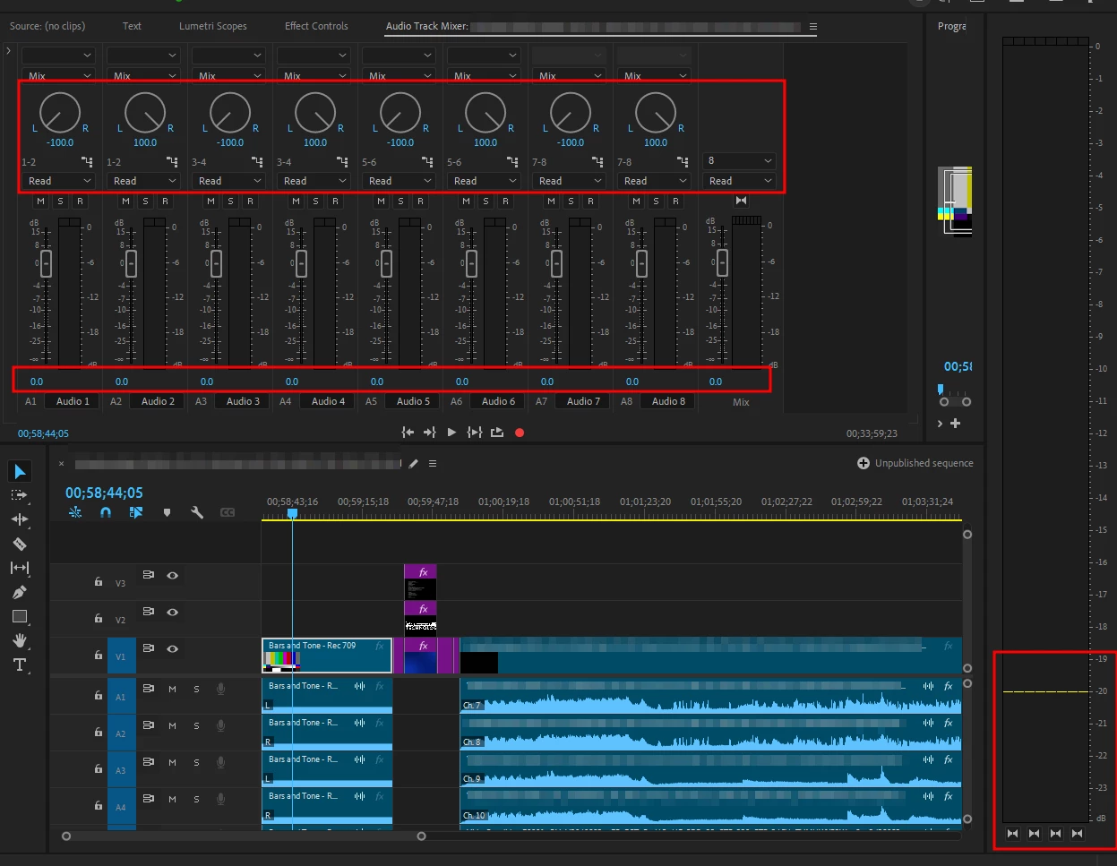

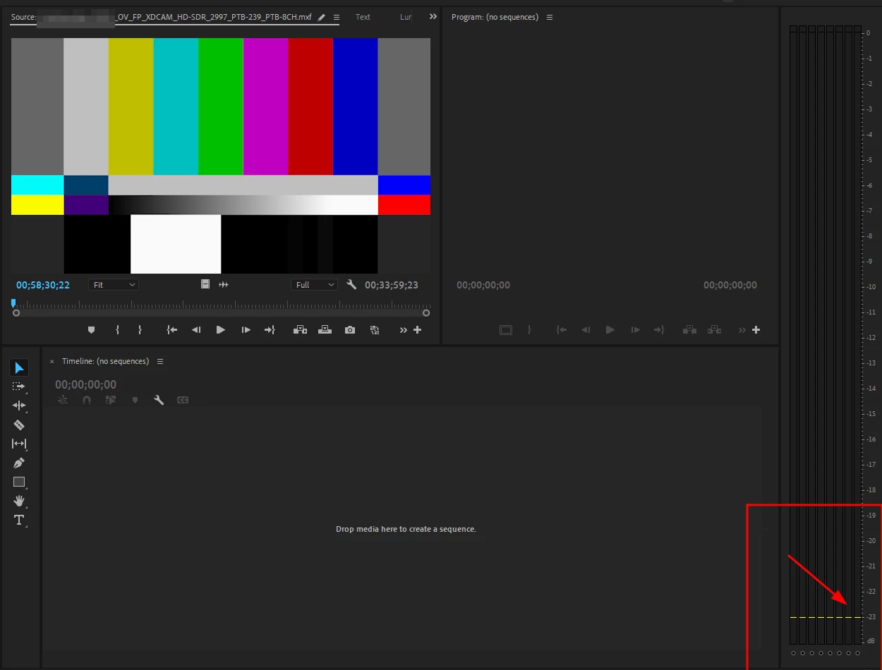

About the Audio with -3dBFS
The sequence has 8CH, all Multichannel as you can see below:
The 1kHZ signal is at -20dBFS as you can see in the meter.
After the export the same 1kHZ signal is -3dBFS lower as you can see below (this happens for all tracks):
Sensitive informatation has been blurred. Worth mention that the original content is 23.976fps.
