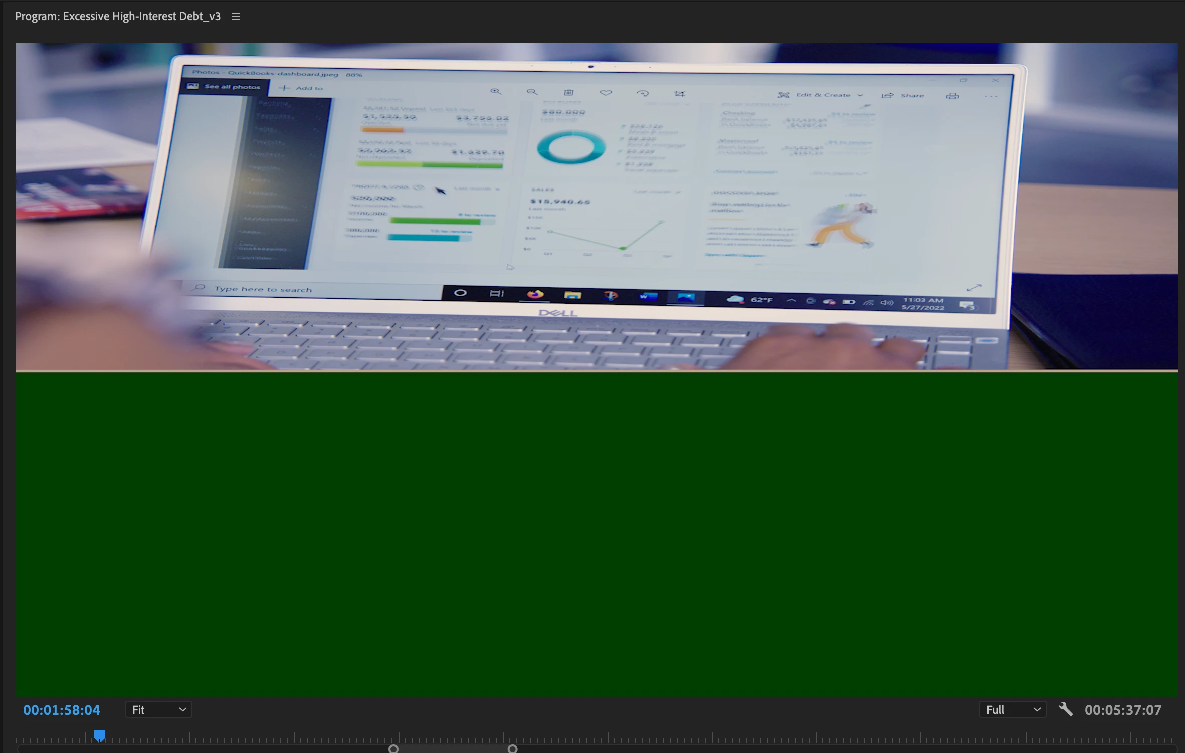

I just opened my projects after updating to the latest version of Premiere and all my MXF files are showing up squished with half the frame green.  I have no idea what happened.  When I open the files from Finder they look fine, and everything was working perfectly before the upgrade.  See attached image.  Same problem when viewing clips in After Effects as well.  HELP!  I'm on deadline and not sure what to do.  May try downgrading to the last version to see if that fixes it for the immediate project.

Hi Kartika, thank you for the reply!  Turning off Hardware Decoding in the Media preferences of Premiere did make the footage show up normally.  (I tried changing the setting in project settings, but that was grayed out in my project.)
Before trying this I also tryed clearing the media cache, which did NOT solve the issue.
It seems that turning off Hardware Decoding will result in much slower performance so this is not a real fix.  I'll keep working in v 22.6.2 until a real solution can be found.

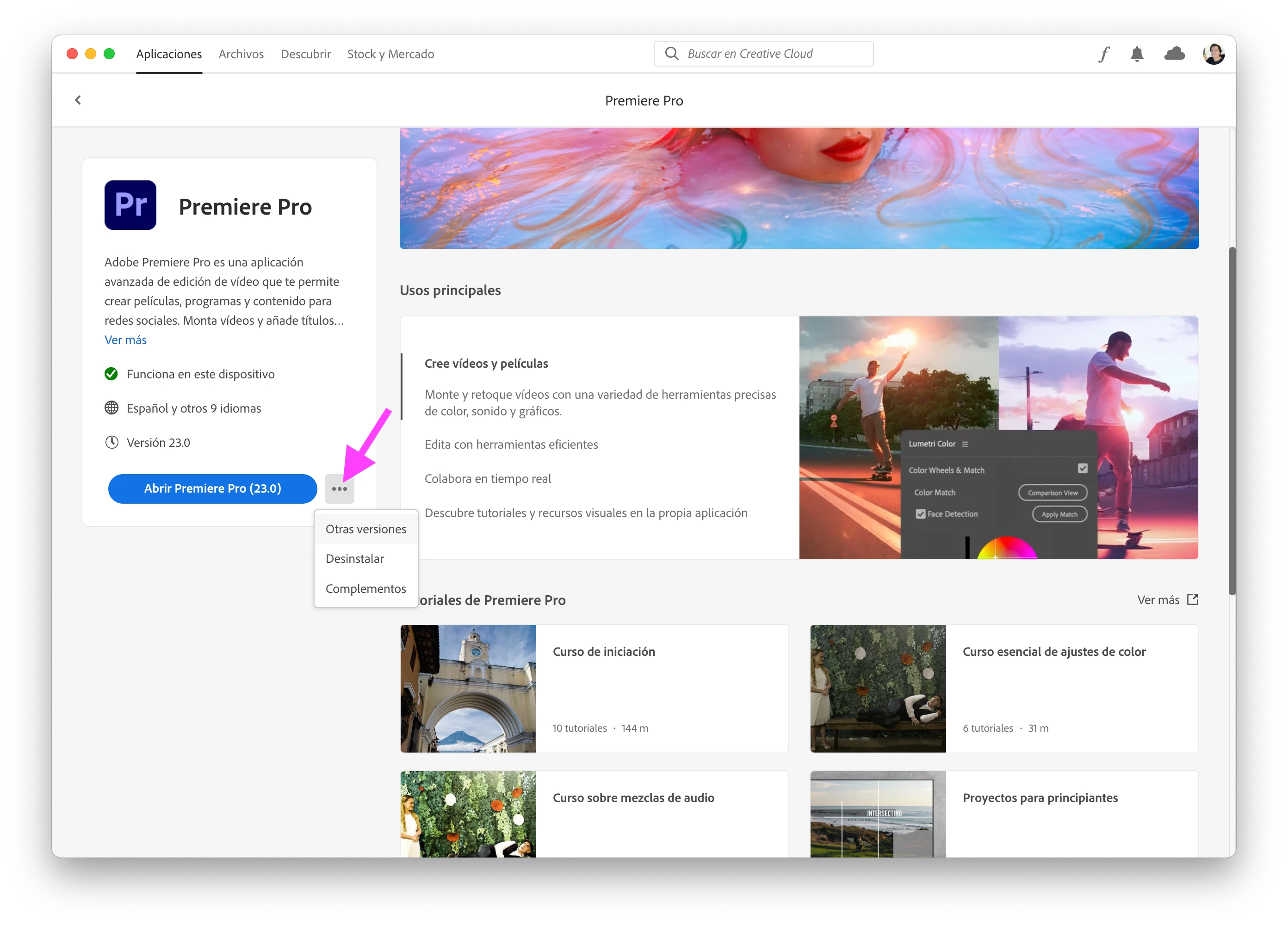

In the Creative Cloud desktop application click on the video tab and in Premiere Pro click on "More info" and this window appears, click on the three dots again and choose "Other versions" so you can install the version again 2022, at least until you can work properly on 2023 (screenshot). Before you do that, you could try going into Project Settings and changing the Renderer in the General tab.
Byron.

Thanks Byron! Yep, I was able to downgrade which fixed the immediate problem.  Weird issue. Guess I should know better then to upgrade in the middle of a project.  Always thinking it will make things faster not break them, as I think I saw Premiere Pro was supposed to render AVC-Intra footage 2x faster on Applie Silicon.
