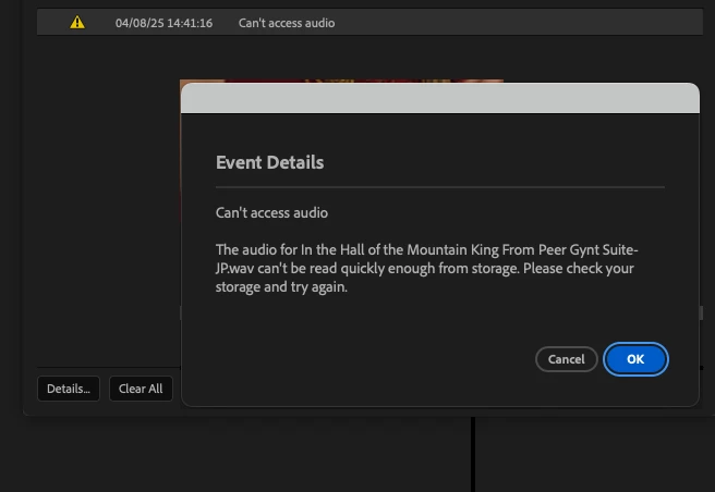

P: Audio "can't be read quickly enough" from storage

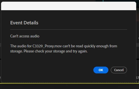

Just started getting this error window today while working on a very simple project that only has a couple After Effects motion graphics clips, and three tracks of audio: VO, music, and light SFX:
Event Details:
Can't access audio
the audio for _____.wav can't be read quickly enough from storage. Please check your storage and try again.
Build:
Windows 11 Pro 26100.3624
12th Gen Intel i7-12700K 3.60 GHz
32 GB of RAM
NVIDIA GeForce RTX 3060
The local C drive is an NVME SSD, but the file in question is stored on a Synology NAS with IronWolf HDDs. Both the computer and the NAS were built from new parts this year.
Premiere: 25.2, installed this week.
The same error happened on a second computer (same build, also connect to the NAS).

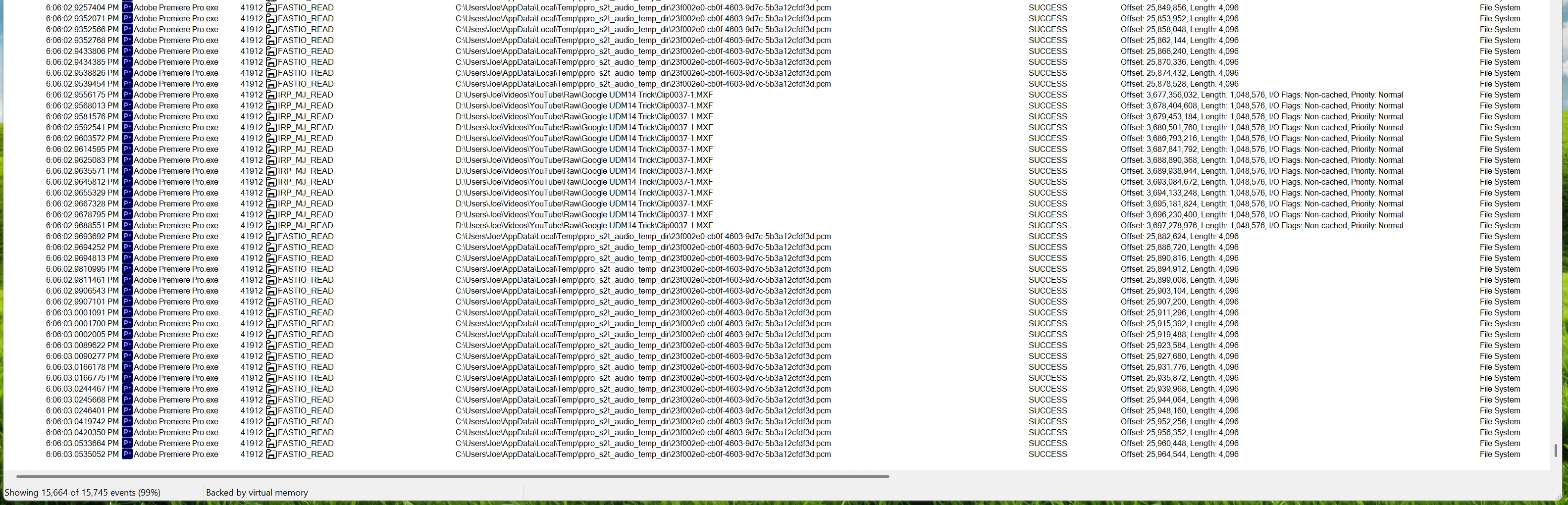

Reposting my reply from another similar thread, but same issue here.  Never had this problem before. After importing a video file, my CPU spins up to like 70% and just sits there. My waveform looks like it processed a tiny amount then stopped:
The first time I opened the project and tried to add the file, it said the storage wasn't fast enough or something similar. I cleared the cache and re-imported it as a different name. It spun up the CPU for like 5 minutes then it stopped, but the waveform never generated.
In ProcMon it looked like it was slamming some temporary audio file the whole time.

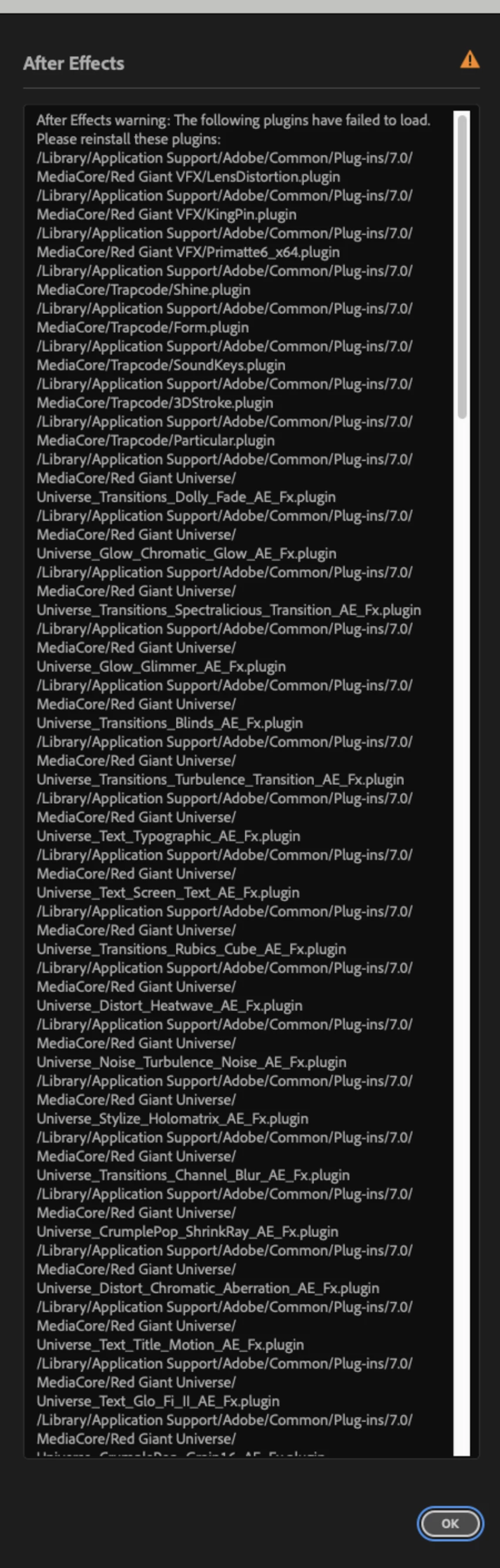

Confirming same issues in 25.2 and higher -- All sorts of failing to read errors not just in premiere but extending to my Maxon/RedGiant plug-in and in After Effects 25.2 as well. If you try to reinstall, it doesn't fix the error. I even tried to manually delete the plugins to reinstall and messed up my Red Giant stuff further. Wish I had know it was an adobe issue before doing this.
