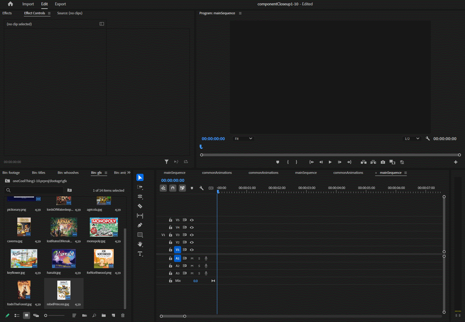

Mar 30, 2025 3:23 PM UTC
1. Drag a 32-bit PNG image from a Bin into the sequence timeline
2. In the Effect Controls panel, drag left on the "100.0" Scale parameter until the number is less than or equal to 50
Expected:
The PNG should scale gracefully, just as it does when it's over 50% Scale
Actual:
Once the number is 50% Scale or below, the PNG image as seen through the sequence in the Progam panel "pops" dramatically to a visual size well below 50% scale. When you release the mouse button, it "pops" back to the expected size. Scrubbing the timeline makes the image pop back and forth between its "true" scale and the visually incorrect smaller scale, making it difficult to place and animate the image.
This bug is reliably reproducible 100% of the time, across multiple machines and installs, and has existed in the software for years.
In the attached gif, you can see me perform the reproduction steps above. You'll see the image "pop" when i drag back and forth between 51% scale and 49% scale, and you'll see it "pop" when i scrub the timeline.  i do not know if this is only a problem with 32 bit PNGs, or whether it affects any asset, but i exclusively use 32-bit PNGs and am plagued by the issue.
