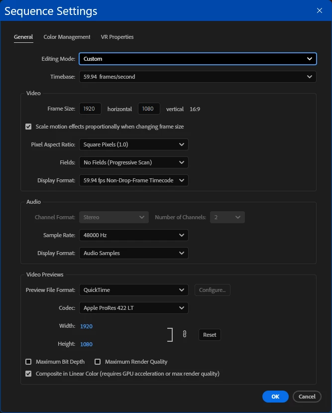

Another thought I had was that, as Kevin et. al. have pointed out, the native format of the source material (AVCHD) is not a good format at this time.  He has suggested transcoding the source to ProRes LT (I don't know where to start to do that) before importing it.  There are several AVCHD settings available for Editing Mode under Sequence  and here are mine.  I note the Editing Mode in mine is "Custom".
The source file information is in a post on Dec 30th.  I thought I had read somewhere that the sequence settings were auto  adjusted to the first input file's settings, but I'm probably wrong about that.  What do you suppose would be a good selection to use for these files from the dropdown?  I don't know enough about AVCHD to be able to intelligenly select an option.  I can barely spell it!
In general, going to the beta version seems to have fixed the major destruction of the audio in my first clip.  The other clips seem to have also survived the import process.  I have not tried to export the raw, full sequence yet, perhaps I should.  Any suggestions for a suitable output.  This is a perforomance archive, only the actors AND ME, will be annoyed if it is a "little" out of sync.

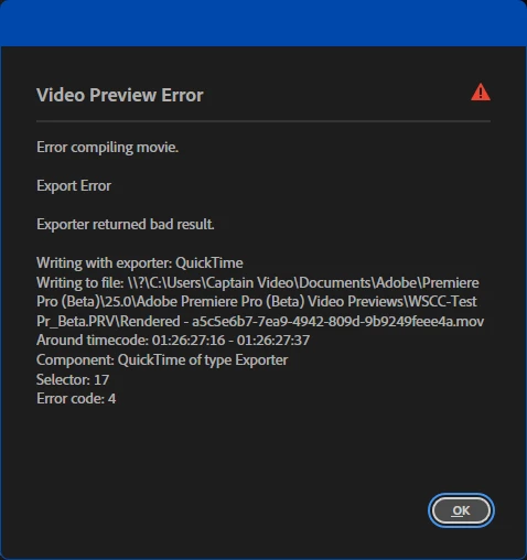

Thanks, Mitch_98 and Averdahl. I located the Beta, installed it, and imported the troublesome clip into a new project.  It survived!  I was able to render both audio and video.  So I imported the other two clips and set them to render in to out.  I got the following error:
I don't know exactly what any of it means, but the three files in my project timeline end at 1:1:42:39 -- I don't know why it's working in the stated timecodes.  Ideas?
