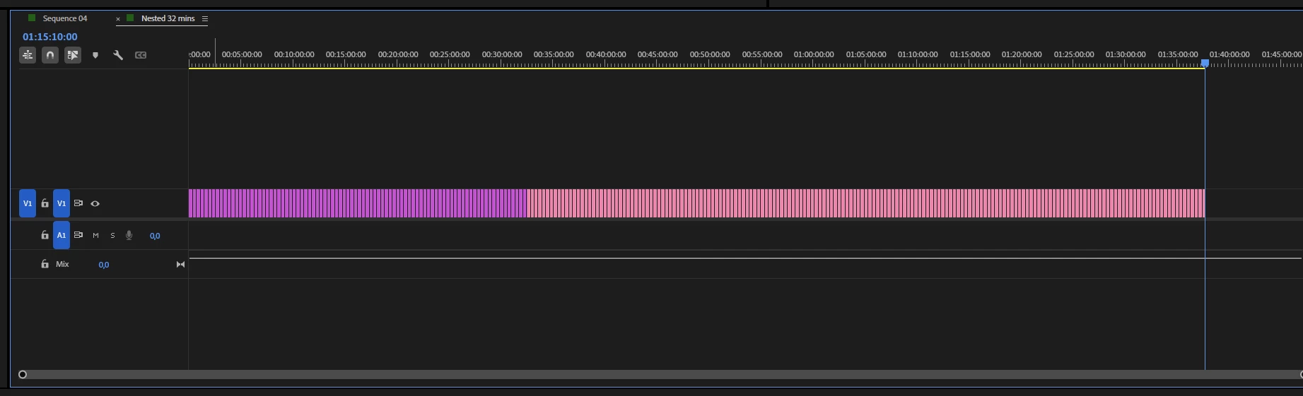

I wanted to make a sequence of images gradually speeding up. A simple task when you put your images on the timeline, nest them and use a time-remap curve to speed it up:

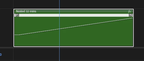

In the example above I have 32 minutes of images5 seconds each. So I switched on the time-remapping graph and made this curve and it turns out in this scenario Premiere shows only half of the images:

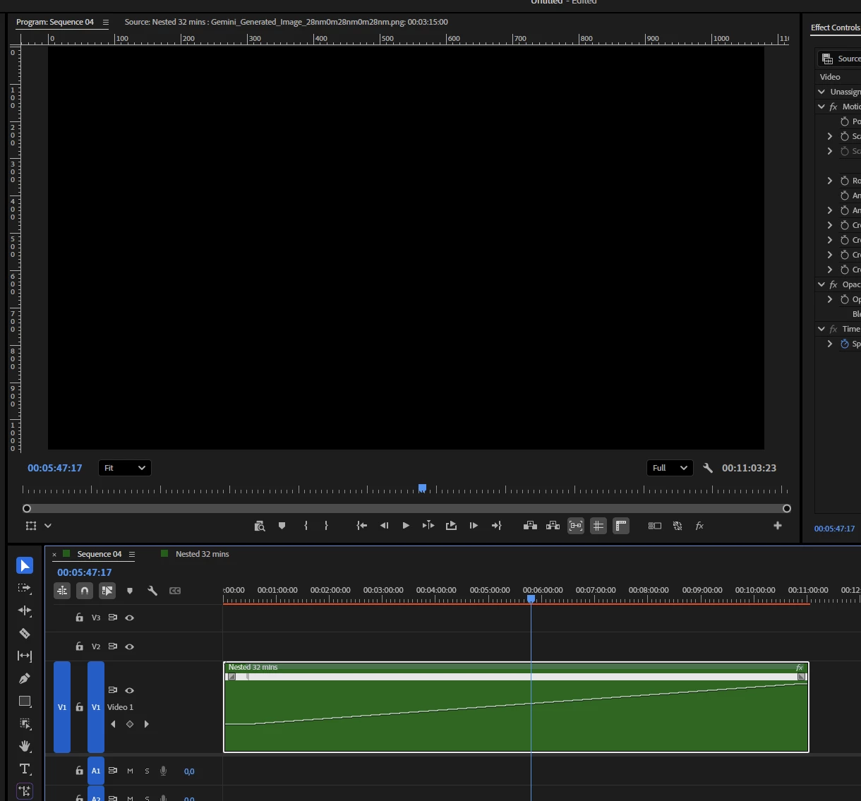

Your normal reaction would be - ok, it sped up so much (it’s only a 500% speed curve) that the images just ended before the sequence ended, right? Well, first of all, when you pull up this speed up curve the sequence gets shorter accordingly. Second - I went inside the nest and trippled the amount of pictures there (the purple ones are the original quantity):
… and guess what, nothing changed - the images just go black at this timestamp:
Steps to reproduce:
  • Create a sequence, put the needed amount of images in it
  • Select all the images and nest them
  • Open the Time-remapping curve, place the marker somewhere at the beginning of the nest and drag the curve up to make it speed up. See the result.
