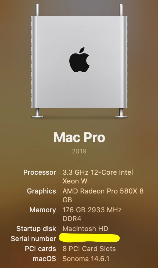

Thanks for the note. That's a little weird, but it's good to know, @jmohan00. I'm always suspicious of Xeon-based Macs. They were only out for one rev and may not have the goods you need for specific formats. For example, are you using H.264 or HEVC? I cannot verify if the CPU has Quick Sync, which is crucial for video processing in that format, especially when compositing or creating video effects.
See if changing to an editing codec like ProRes might perform as expected. Hope to hear back from you soon!

September 19, 2024
Hello Kevin, thnks for responding...
I am working with 4k 60fps videos.
The unexpected solution was to nest 1 final time (the final nest is 3 deep)
Bit bizzare , or my inexperiece with editing (vfx artist). or a bit of both.
I'm on Mac.
JMohan
