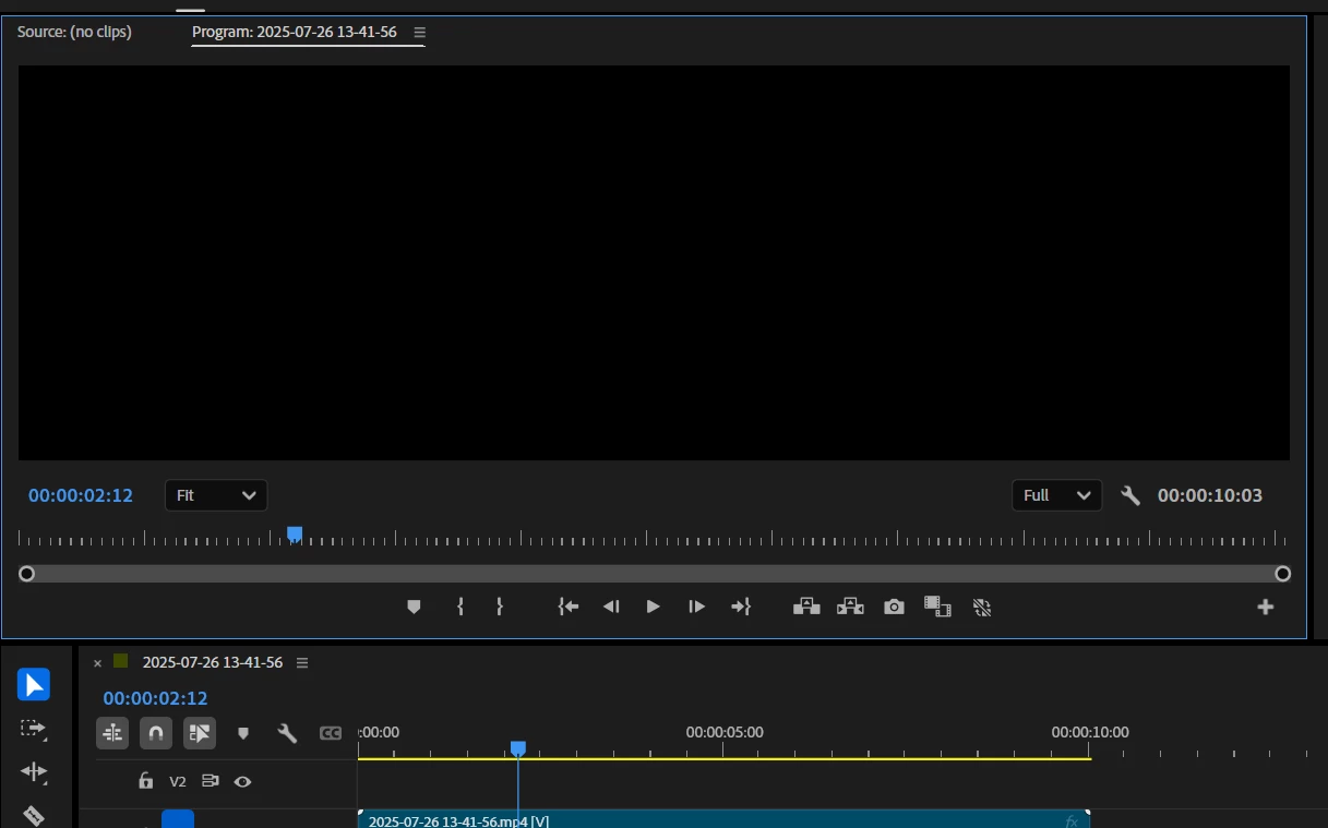

I just installed a fresh copy of Adobe Premiere, (Version 25.3.0 Build 84) and it's not playing/display any video files in the Program Monitor or Source monitor.
The clips also don't scrub through when I mouse over them in the project bin.
My specs are:
HP Victus 16-r0073cl
13th Gen Intel(R) Core(TM) i7-13700HX (2.10 GHz)
32 GB DDR5
Geforce RTX 4060
Windows 11 Home 24H2
Here's all the things I've tried that haven't worked:
Updating Studio Drivers for graphics card (And doing a clean install)
Updating Gaming Drivers for graphics card (and doing a clean install)
Running Windows Update and intalling all updates.
Disabling GPU Accelration UI Rendering
Setting the GPU preference to only use the GPU or CPU in graphics settings,  especially for Premiere.
Setting Audio Hardware default setting to None.
Disabling /Enabling all options in H264/HEVC Hardware acceleration
Changing the video rendering playback in Project settings to Mercury Cuda or Mercury OpenCl.
Any ideas of what I can do? I'm really frustrated here.

Editing on Premiere Pro and I have edited on this laptop before (Victus).
I put my footage into the Project Panel but when I double click or attempt to drag and drop into the Source Monitor window, it won't play the video visual. The timeline will scroll and the audio will play as normal, but I can't actually see the clip.
I've updated Premiere, I've updated my laptop. I've uninstalled and reinstalled. I've restarted both the software and my laptop. I've cleared my media caches. I am out of ideas to try.
Any help is appreciated
July 23, 2025
If I drage the clip into the timeline it also does not play back the visual in the program monitor. But if I were to export it, it would export as normal and work.
