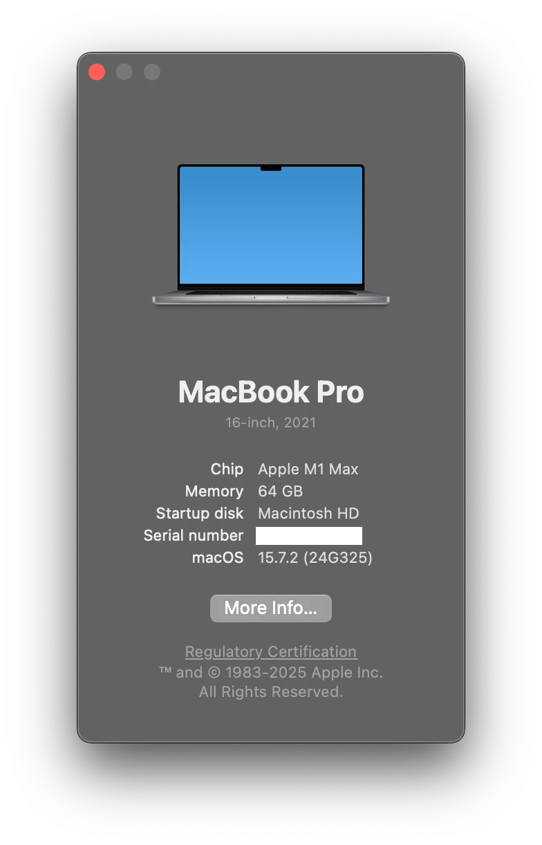

I have mapped "Enable Transmit to command-` and have had it reliably there for a couple years now. Even had it successfully mapped on my StreamDeck. This would play back on my second monitor which is plugged into my 2021 16-inch Apple M1 Max MacBook Pro unning macOS 15.7.2 (24G325) and Premiere Pro 25.6.4 (Build 5). If I had to guess, this started sometime around 25.1-ish

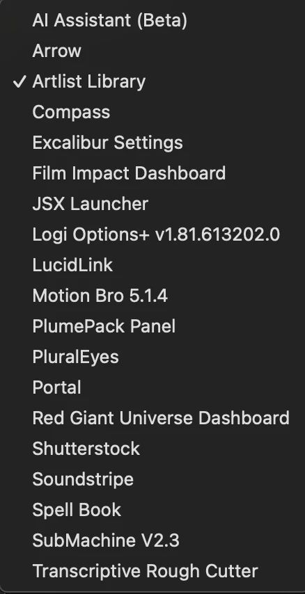

Do you have any third-party plug-ins or panels installed (even if they aren't being used when you encounter the bug)? Attached
Please include your hardware specs and the exact name and version of your operating system.
Attached
David Parke | Freelance Editor — Los Angeles, CA | System: MacBook Pro 16” (2021) · M1 Max · 64 GB RAM | OS: macOS Sequoia 15.6 (24G84) | Premiere Pro: 26.3.0 (Build 93)

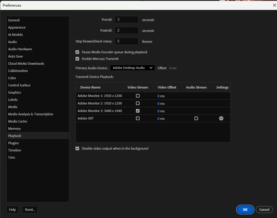

Dec 22, 2025 6:42 PM UTC
I am running the current version of Premiere Pro; 25.6.3 on Windows 11 Pro 24H2. In the past when using the the playback stream to a 3rd monitor, the output would re appear after closing the program and then opening it later. Now I have to go into EDIT_Preferences_Playback and uncheck the monitor box; close it; then open back up and recheck the monitor box. Something changed in the latest update of Premiere as I did not have this problem in the previous versions. Could you please fix this???

Dec 10, 2025 1:58 PM UTC
In Premiere Pro 25.6.3, the program fails to display the preview window on a secondary monitor when starting the application. The preview only appears if I go into Preferences → Playback and manually uncheck and then re-check the secondary monitor.
This issue did not exist in previous versions and significantly disrupts workflow for users working with dual-monitor setups. Previous suggested workarounds, such as resetting workspace or updating graphics drivers, do not resolve the problem.

Good morning,
I use a 3rd monitor as a playback stream monitor. It seems with the last update that whenever I close Premiere project then later open one; the playback monitor does not have video in it. I have to go back into preferences uncheck the box, close it, open it back up, check the playback monitor box again, then it works. It used to always stay connected. Any fixes???
