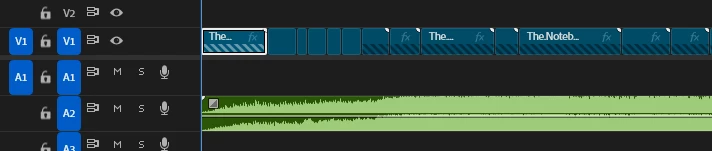

Parallel lines on video clips and all video clips order messed up.
Everyone, please help me. I edited the videos and everything was okay until this morning. I definitely saved the project. But when I reopen it, the timeline was like that, the video clips with parallel lines can't be seen and video orders were all messed up. Do you know how can I fix this problem?

Thanks for reaching out.  I'm sorry you're having a problem.  Did @theok1234567's solution work?  That would be my first guess as well.  Please share more specific info about your system and media specs if that didn't work.
Hopefully, that first trick worked.

Problème résolu de mon côté, j'ai dû renommer les clips qui posaient problèmes et les recharger dans le projet.

your clips are linked to other clips with the same name.
This can happen if drive letters changed with external disks.
- try to set external drives to the earlier letter with diskmanagment
- You can try to relink media
