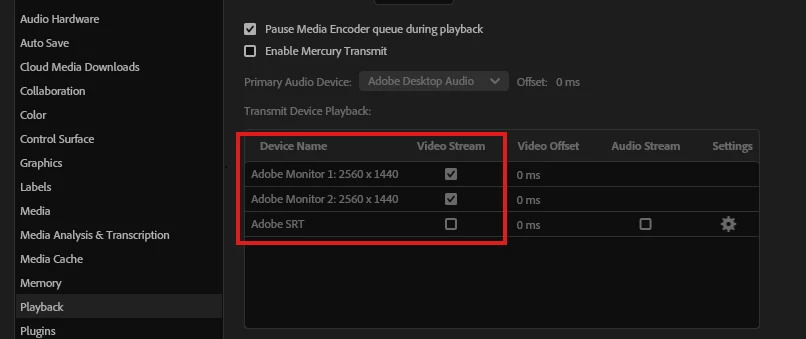

    Also, my Premiere always ends up like this: With both monitors checked, though I only checked the one.

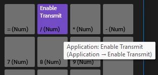

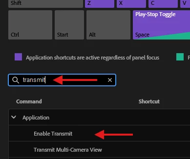

    BTW: That’s my shortcut (numeric /), as it matches AE’s default shortcut. You’ll have to set one for yourself.
    MyerPj
    Feb 28, 2026 9:39 PM UTC
    I’m on Win11 - 25H2 (clean) using Pr 26.0.1, and it works for me without having to go into Preferences. I do have a shortcut mapped to Enable Transmit, if you don’t have a shortcut, you need one! 😊
