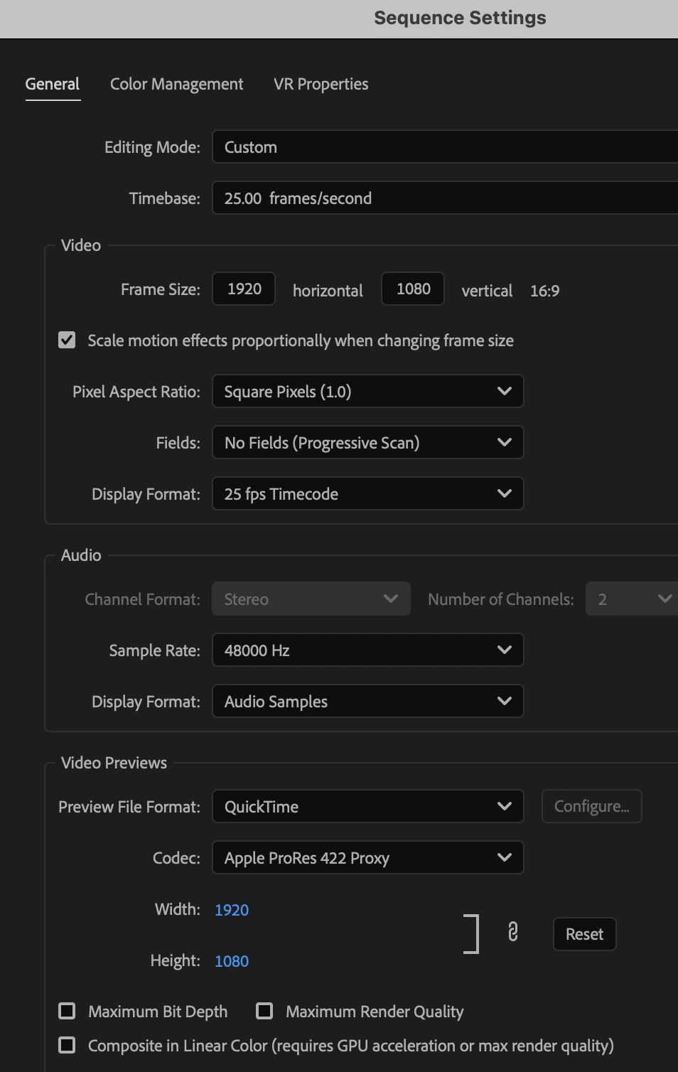

Sequence settings 1920x1080.
I was advised to change my Preview codec to Apple ProRes Proxy. (Should I try Apple ProRes LT instead?)

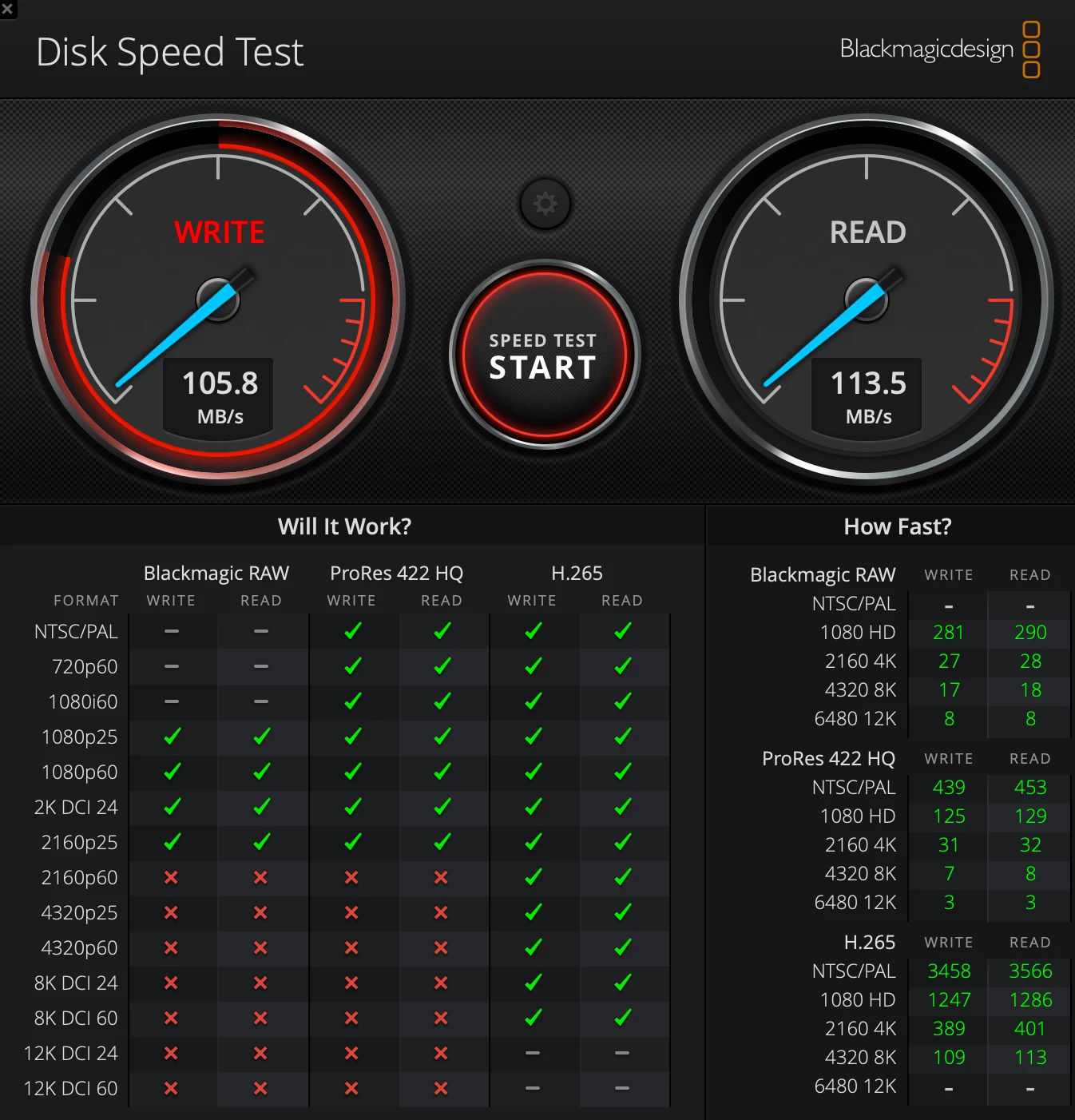

Jul 31, 2025 12:30 AM UTC
Thanks Peru Bob,
I've tried setting the audio input to 'No Input'. Will see how that goes.
The supplied external drive is ExFAT. I've attached a speed test.
Thanks R Neil Haugen; definitely agree I would never choose to work with H.264 media. I will try to run a test.
R Neil Haugen
Jul 30, 2025 4:16 PM UTC
Ok, long-GOP media is nasty stuff, and even if a system is good enough at it to handle one or two tracks, basic playback, you start adding effects and scaling ... and you're throwing a ton of per frame computational work at the computer.
Which is why going to ProRes/DNx/Cineform proxies may help immensely. May, again, you'll need to test of course.
And sustained data reading over time is a lot different than the optimal speed that an external drive connection can show. I've seen things where once the cache was filled ... performance dropped by 30% to 50%. So that means data in/out for all that computational work is not coming in after the first minute or so of playback at the speed it started at.
The drive will show a lowered speed, and people go ... well, it's not using the full speed of the drive connection! I get 150Mbps connection, it's only using 80!
Well ... that again might be that after the cache is loaded, that is all it can sustain in a constant running.
And as to the long-GOP ... I've had a lot of people who were stunned that their computer, which balked at 2 tracks of UHD H.264, could get good playback with 3-4 streams of 6K or 8K RED media ... but that was on internal drives of course.
Everyone's mileage always varies ...
Peru Bob
Jul 30, 2025 2:58 PM UTC
quote
Media, Projects, media cache etc is on a supplied external HDD.
By @magpiemel
What type of external drive?

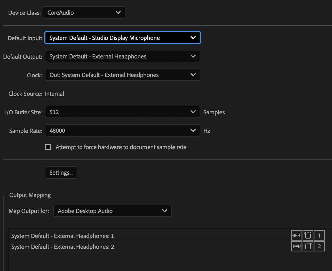

Jul 30, 2025 10:39 AM UTC
These are my current (default) audio hardware settings.
Should I try changing the Audio Hardware Default Input setting to No Input?
It comes up with a warning message when I go to change it.
Peru Bob
Jul 30, 2025 2:57 PM UTC
quote
By @magpiemel
Yes.
