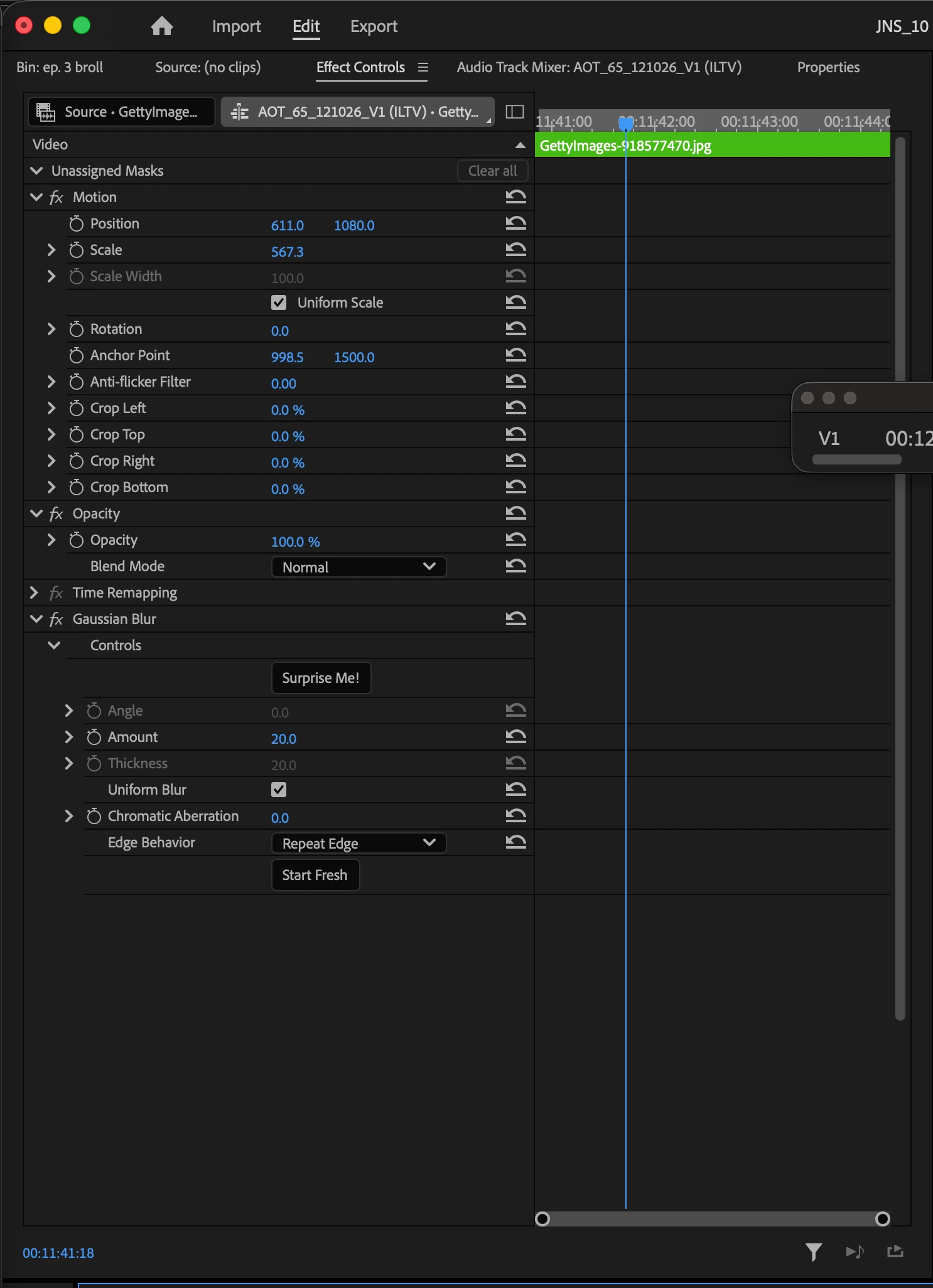

A number of times now I have exported my sequence using AME and the background video of a graphic/still has not rendered on export. Usually these backgrounds are duplicates of stills that are scaled up with a gaussian blur effect applied in order to provide background for a vertical picture or graphic (see attached pict). This was not happening in previous versions of Premiere.

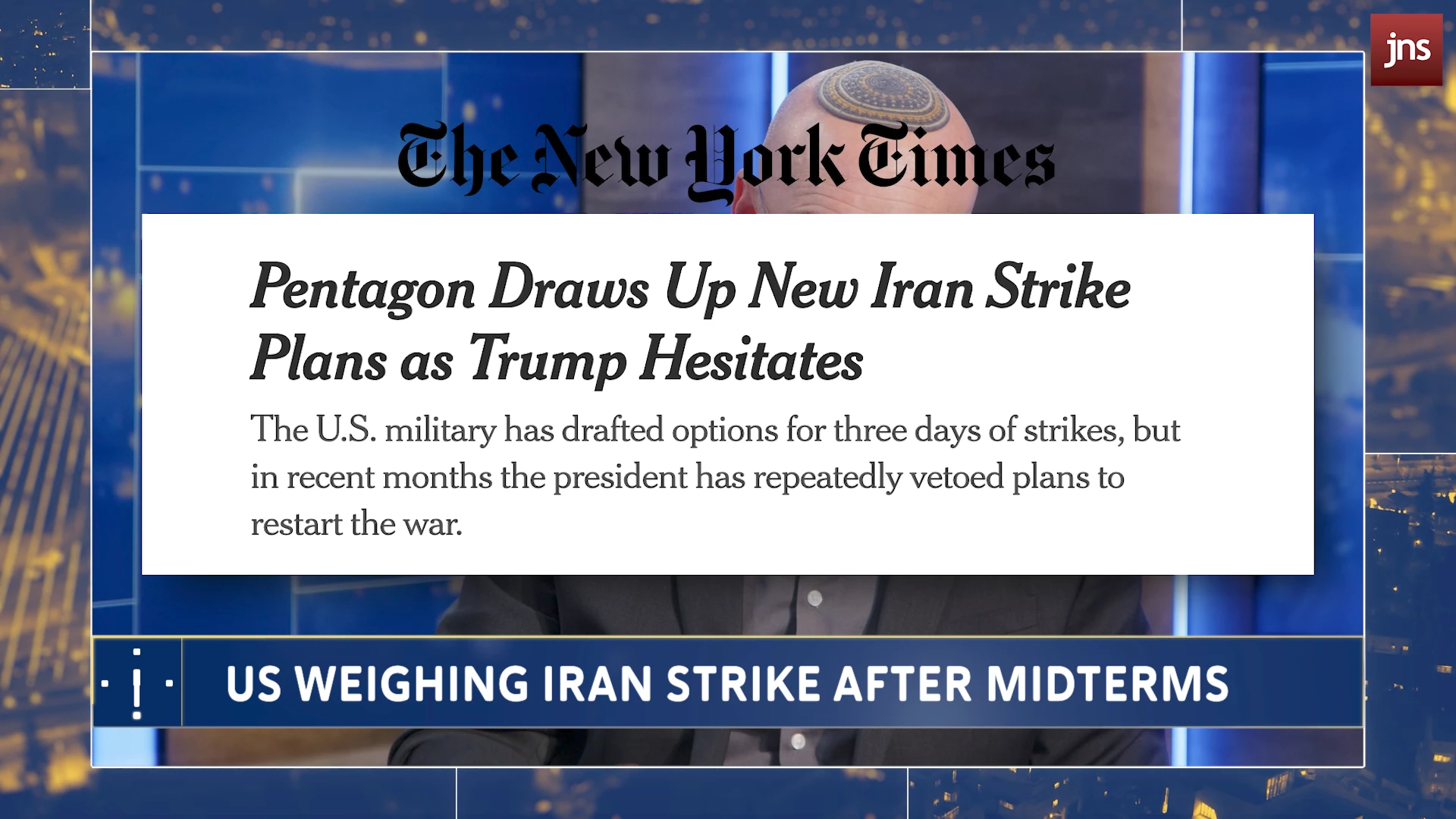

    ​@Amy the Stuv  Here’s another example where the video looks fine in my timeline, but when I go over to my export window you can see that the background channel is not there.

    ​@Amy the Stuv see above.

    I will post some screenshots so you have a better idea what I’m talking about. Everything looks and plays fine on my timeline but on export with AME the background is missing. This has happened a few times now after upgrading. When I park on this effect in AME I can see that the background is messed up, but I cannot be expected to check every layered graphic each time I need to export. I did not export directly from Premiere.

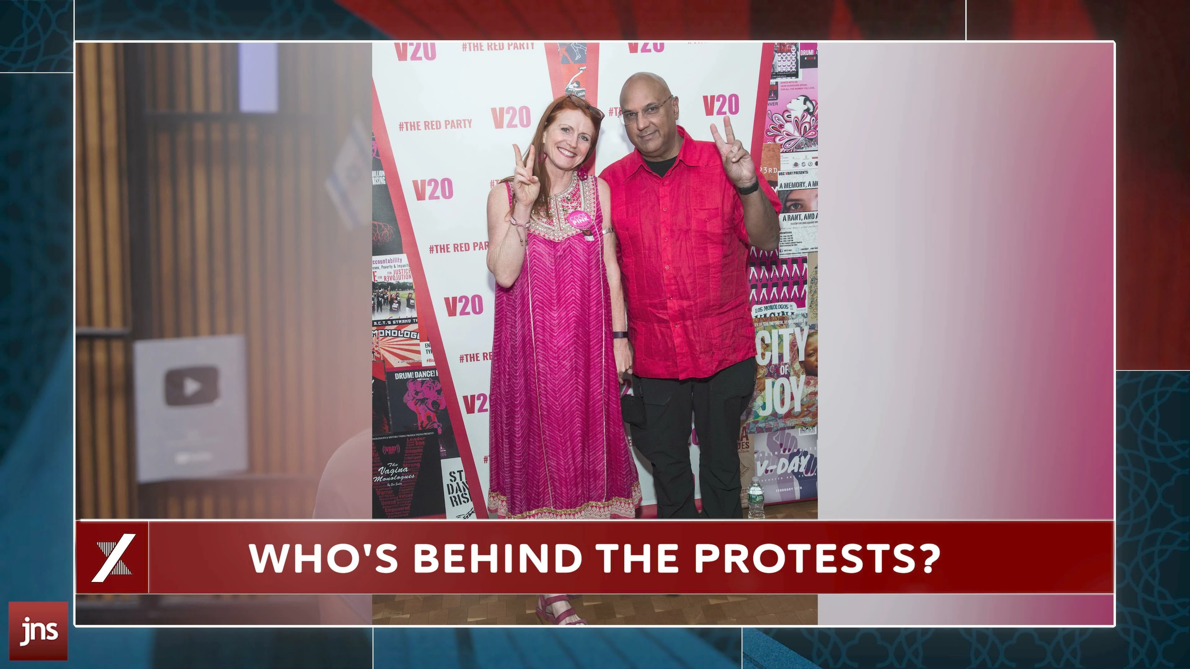

    This is how the effect should look:

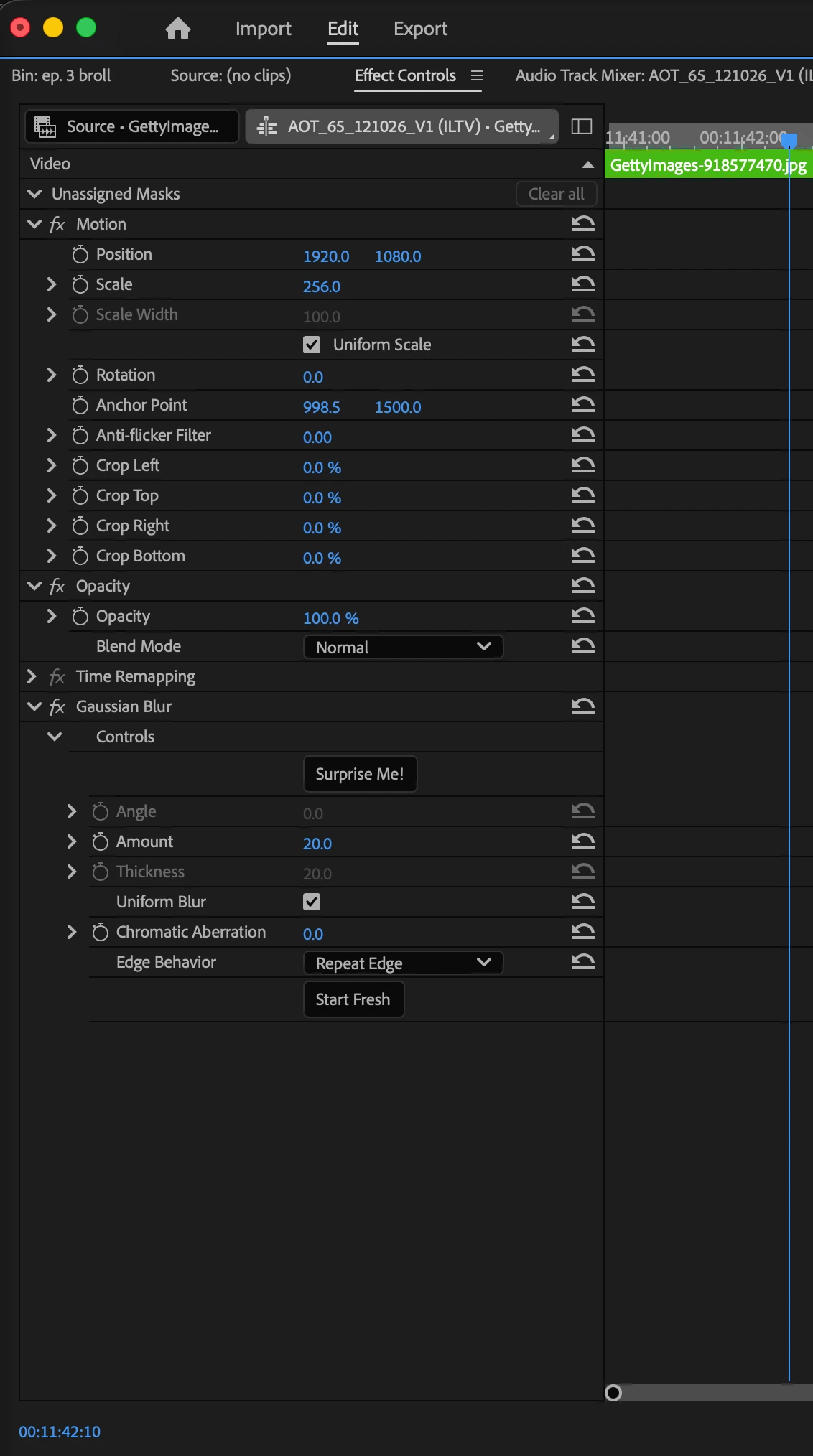

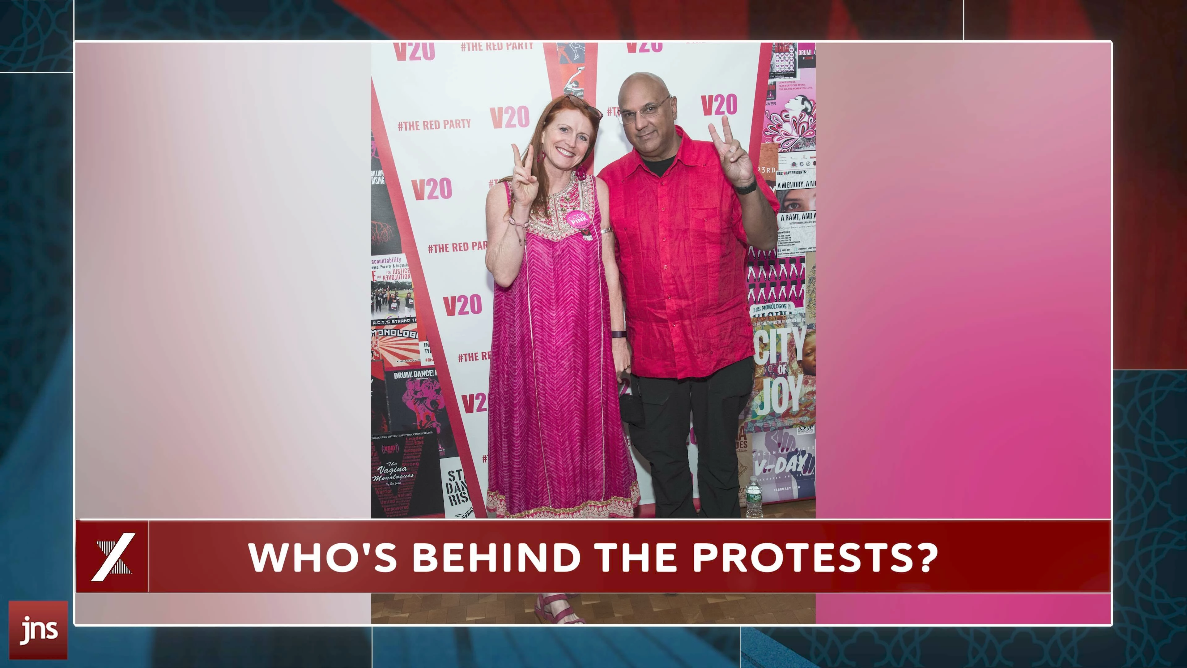

    This is how it starts off when I scale up the bottom, duplicated layer and then have to shift the x-position over:
    Here is the beginning control panel settings before x-position shift:
    And here is control panel after shifting to the left and scaling up so the background is covered:

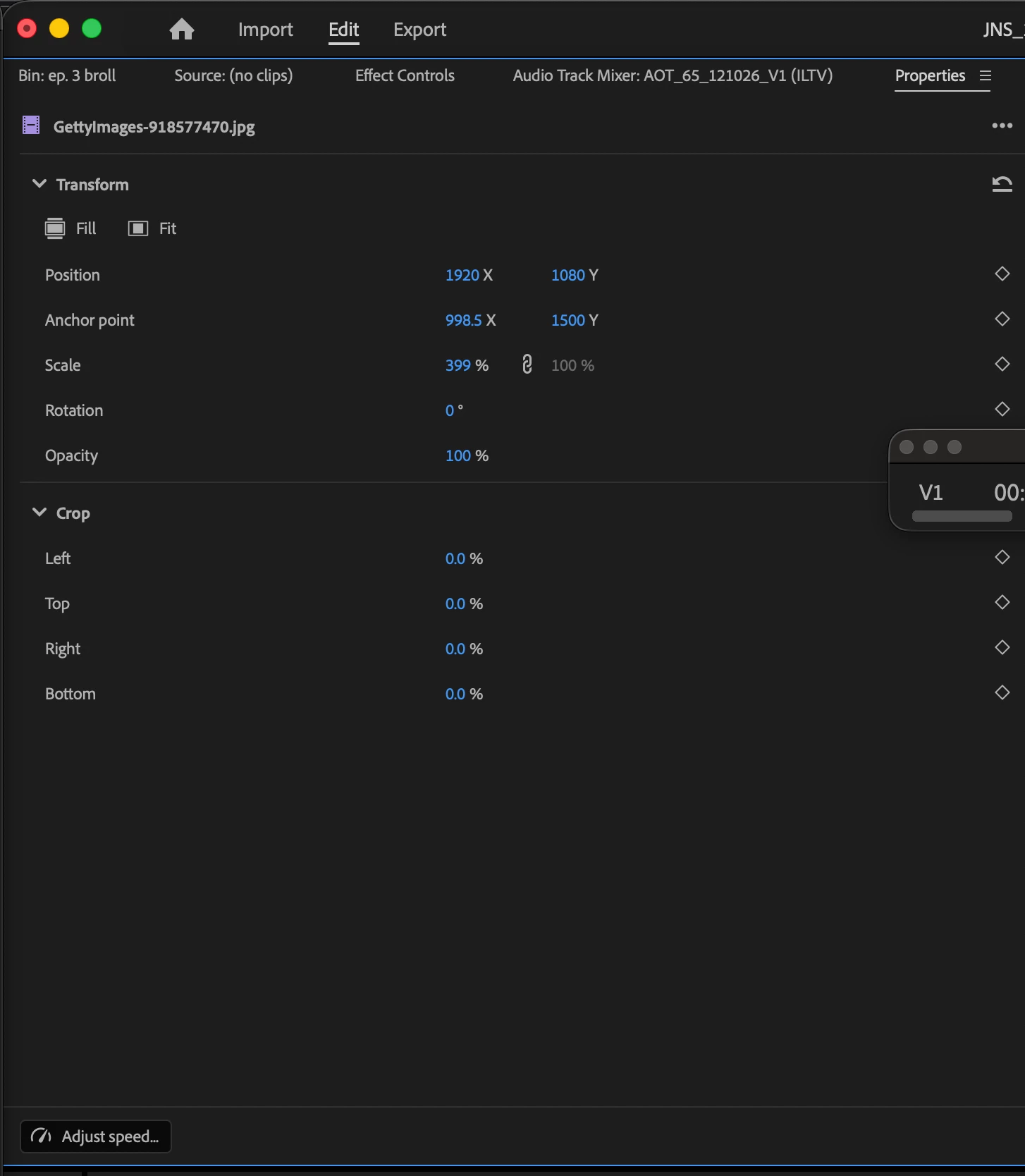

    Properties panel (unadjusted):
