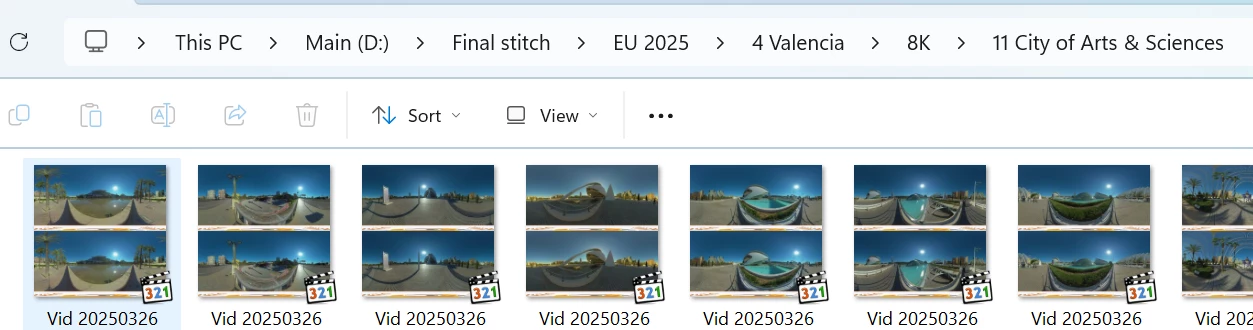

  1. Import any 7680×7680 HEVC MP4

Hi @dsob - I see you have 13 clips are they all the same codec, bit rate, and chroma sampling as the one you uploaded?
Can you send your project to jamiec@adobe.com so we can take a look.

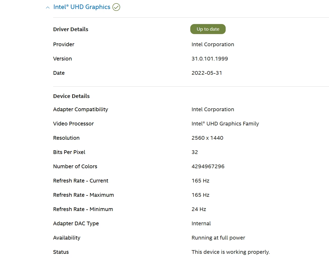

Dec 11, 2025 9:37 PM UTC
I did update the driver and Intel driver support page is showing it up-to-date - see screenshot.

Hi @dsob -  The latest Intel driver is 32.0.101.7082, which may explain why an older version like 24.x works on your system. I tested playback and export in 25.5, 25.6, and both correctly use the iGPU without falling back to software decoding.

My current Intel driver is 31.0.101.1999

Hi @dsob -   Can you let us know what your integrated GPU (iGPU) driver version is?  You can find this information in device manager > display > iGPU > driver tab
