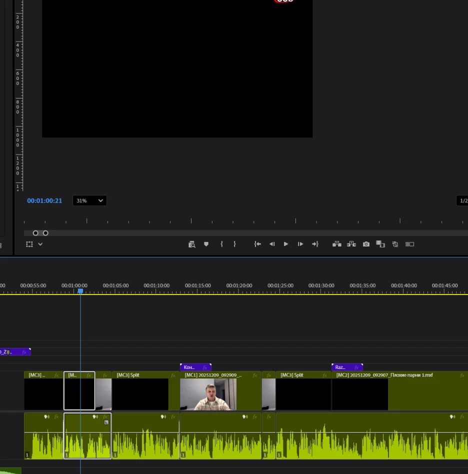

2) This one is even worse. At some point Premiere Pro starts showing black screens in the clips corresponding to certain angles. It looks like this:
And before you point it out - no, inside the multicam all the clips are enabled. So you can see them in the multicam and you can see black screens in the main sequence where the multicam resides. Moreover, if you switch the angle - some angles are shown fine, some are black.
I first thought that might have been related to the first issue, but in the next project I did not color-grade anything and still got it. I do not use any effects inside the multicam, so I thought it was the Lumetri Color to blame. I was wrong. Then I thought it happened because of some other changes inside the multicam. I normally correct the people's position in the frame by moving the position property and scaling them up. One thing I noticed is that it only happened when I did this in on the Properies panel, not the Effect Controls where it was fine. But yesterday I tried to reproduce the issue on purpose and I failed too - changing the properties in the Properties panel did not cause it.
I also sent my project to a colleague and he had no issue while it happened in my Premiere Pro.
Two more things to mention - I completely reinstalled my Windows 11 24h2 and installed Premiere Pro with no plugins and this issue happened again. And I could fix the issue several times without the need to remake the multicam sequence from scratch having flushed the media cache. At the same time resetting Premiere Pro did not help. So I conclude that something causes cache corruption, but I have no idea what.
