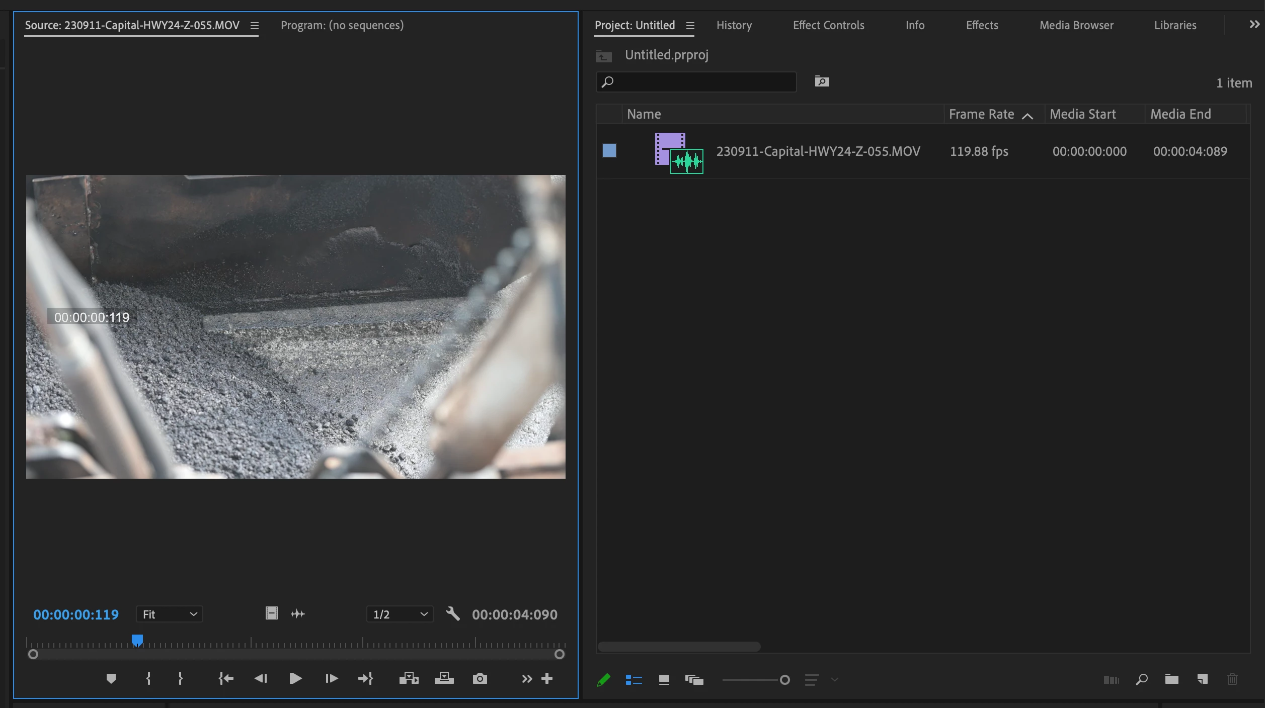

Currently any footage shot above 99 fps shows a timecode of 00:00:00:000 which is ridiculous. Premiere Pro should be able to read timecodes that are formatted with 3 trailing zeros properly so we can organize footage by timecode.

@esemze I apologize, I think I see what you're saying – is your issue that the TC is starting at 00:00:00:000 rather than 10:46:25:118?
mattchristensen
September 14, 2023
@esemze This is supported in Premiere Pro. Could you share which version you are using? Here's a screenshot from my end using your media and you can see Project panel, Source Monitor, and Overlays all use three digits for the frame counter.

esemzeAuthor
September 14, 2023
Just create a project, import footage that was shot above 99fps and you have recreated the issue.
If for some reason you are still able to see the correct timecode after doing that ( I cannot ) then interpret the footage to something like 23.976 and you will most certainly get a timecode of 00:00:00:00
Here is a clip that was shot at 120 fps with a timecode in the metadata that you can test with:
https://misctemp.s3.amazonaws.com/230911-Capital-HWY24-Z-055.MOV
