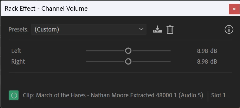

When I send an Adobe Premiere sequence over to Adobe Audition it is adding +9.0 dB of volume on Audition's yellow volume graph/line on each clip AND a clip effect on each clip, called Channel Volume, which sets each channel to +8.98 dB.  The result is inaudable and burries the needles.

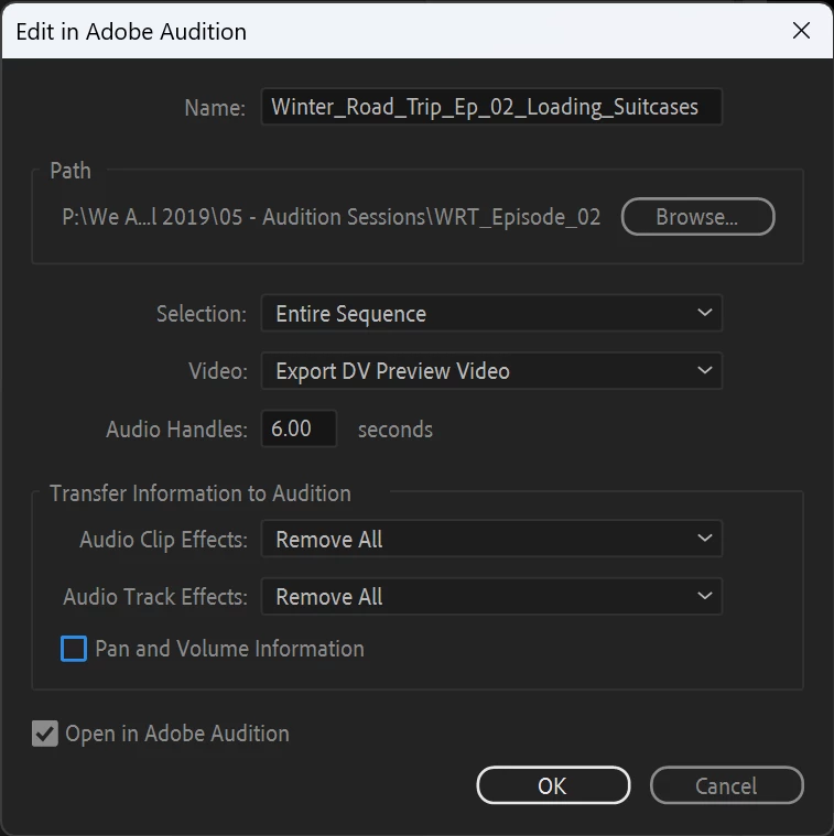

I've used the Remove All Clip Effects and Track Effects options and unticked the Pan and Volume Information.
Before I can start audio mixing in Audition I have to manually click on each and every clip, one at a time, move the yellow volume graph/line back to 0dB, then click in Clip Effects Rack and remove the Channel Volume effect.  EVERY SINGLE CLIP - ONE AT A TIME.

Which option in sending the sequence to Audition did you use?

Premiere’s Channel Volume parameter is one of those cases.  There is no similar channel volume in Audition, so the engineering team created a custom effect  (that you cannot find in the effects menus by the way) called Channel Volume.
The Channel Volume effect is applied to a clip in Audition if it is detected in the Premiere sequence.  I’ve tried this again, to see if there was anything broken, and confirmed that it appears to be working correctly.
Your Premiere sequence appears to have the Channel Volume effect set to add 8.98 dB of gain to each channel, when you that sequence to Audition that is added as the Channel Volume effect.  This is just a guess since I haven’t seen your Project.

And as to the post in Audition, the OP is Richard Knight, a very solid longtime troubleshooter here, and of course, SteveG, one of the Meisters of Audition ... and quickly got to a the apparent conclusion that the Pan & Volume checkbox was involved.
So ... have you tried the fix listed?
