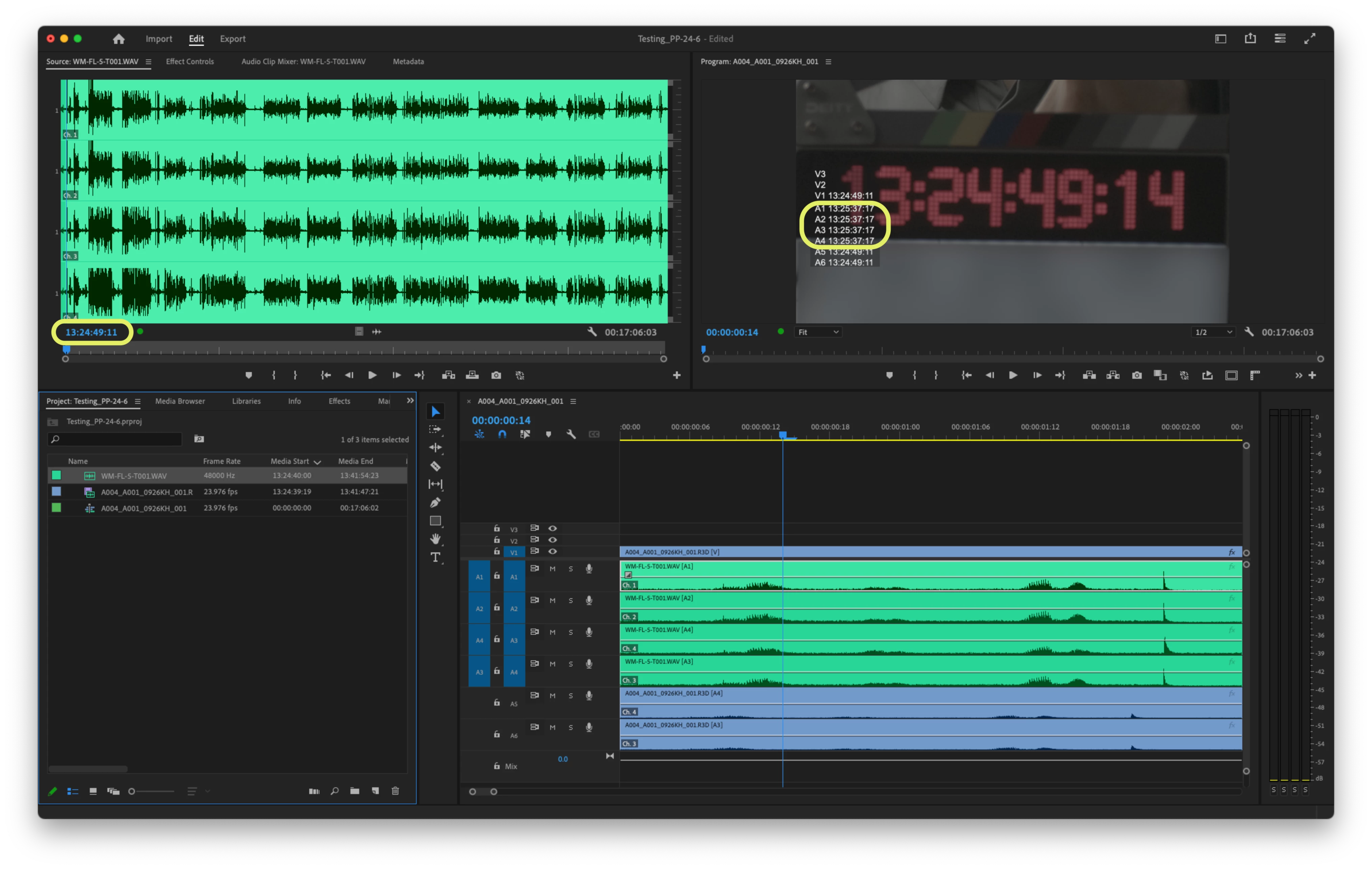

Collin K
Aug 28, 2024 5:41 PM UTC
I just downloaded and opened PP 24.6.1 (Build 2) to do a quick trial.

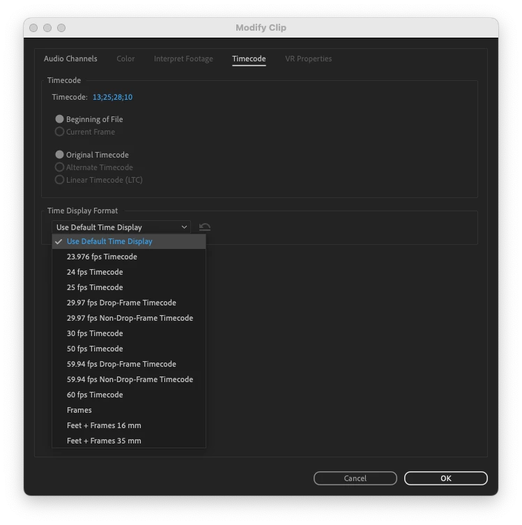

I imported one .R3D file and one separate sound file that syncs together nicely for an interview. When I did a manual sound sync by matching the timecodes of both files, I was able to replicate the SAME PROBLEM I had in the previous Premiere version where the timecode from the sound file in the Source Monitor did not match the timecode shown in the TC Overlays of this same file.
I did figure out a fix, though. When I right-clicked the sound file in the Project, I went to 'Timecode' to see what the file was showing. Time Display Format was showing '23.976 fps Timecode' (without me changing anything) which should have been correct. I changed this setting over to 'Use Default Time Display'. Upon changing from 23.976 to Default, the timecode "fixed" itself and the TC Overlays were now correct and matching the Source Monitor.
Hope this helps anyone running into this. I've attached a bunch of screenshots for reference.
