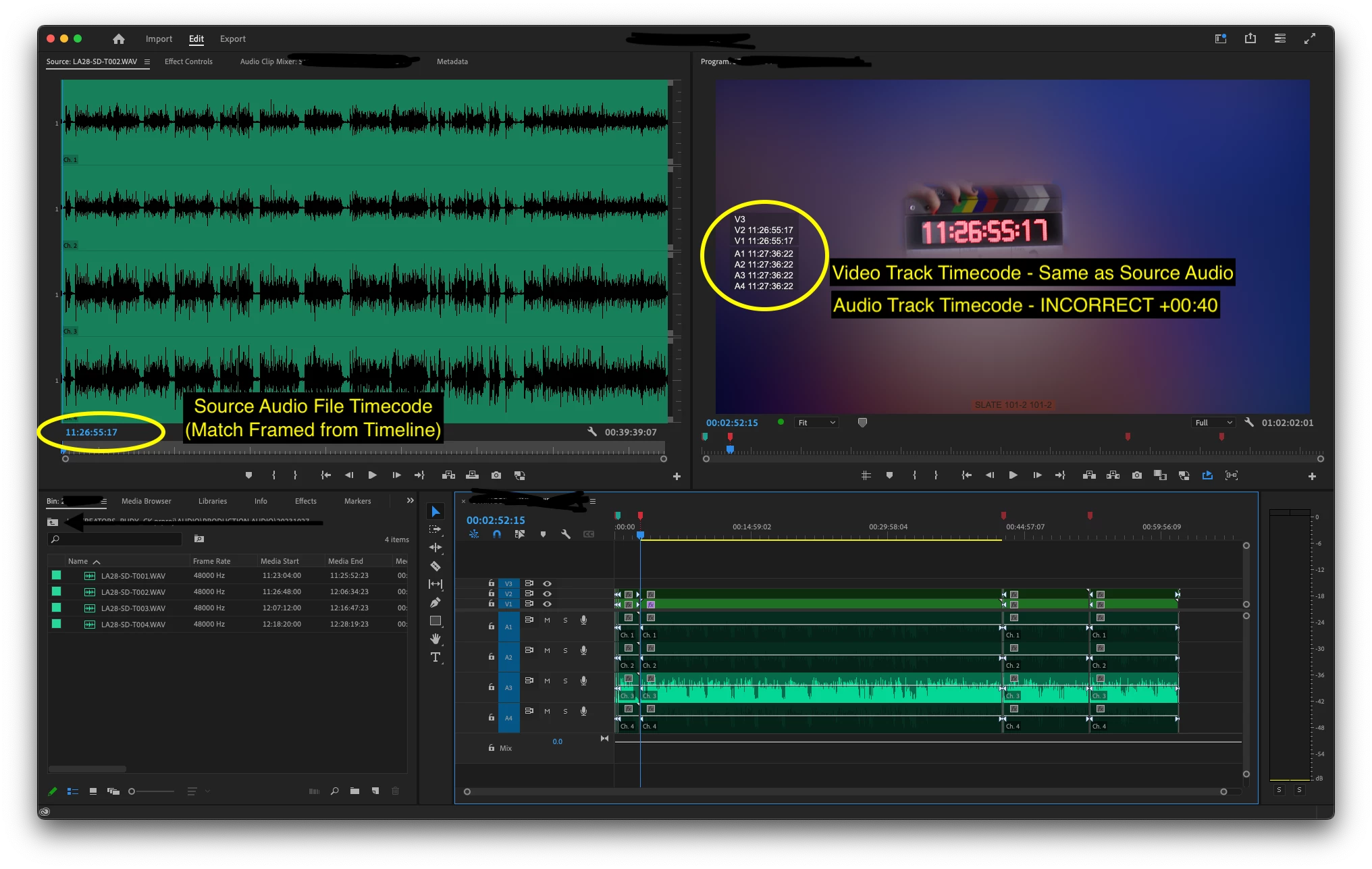

Nov 10, 2023 2:14 AM UTC
I have the same exact issue. First time working in PP 23.6.2. On Mac Mini M2 Pro - Ventura OS 13.5. I'm attaching a screenshot that also shows the same issue; roughly off by :40 when using TC Overlays in the Program Monitor. I'm glad others are also speaking up about this bug or issue.

Tim Snider
Oct 26, 2023 12:03 AM UTC
Here is a screenshot that I marked up to show the discrepency in the V1 and A1 overlays.  I've also highlighted the actual timecode which I achieved by clicking on the audio track in the timeline to open in the source window.
