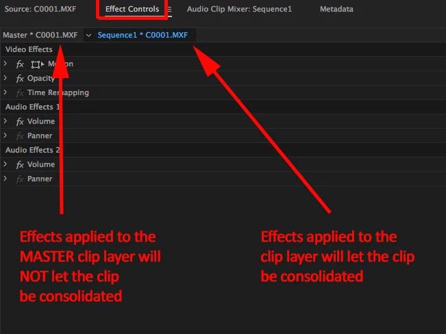

  • Master Clip Effects are not supported, and will be copied without no warning. This includes all the formats that now have source settings as Master Clip Effects (e.g.: R3D, ARRI, etc.)

B   "Master Clip Effects are not supported, ... source settings ...(e.g.: R3D, ARRI, etc.)". So all raw media.??!!!
Not just raw media, ALL media. If you have any sort of video clip and you apply an effect on the Master Clip level and attempt to consolidate, that file will be copied regardless of your consolidate settings and it will NOT give you any sort of error or message that the file was not consolidated.
