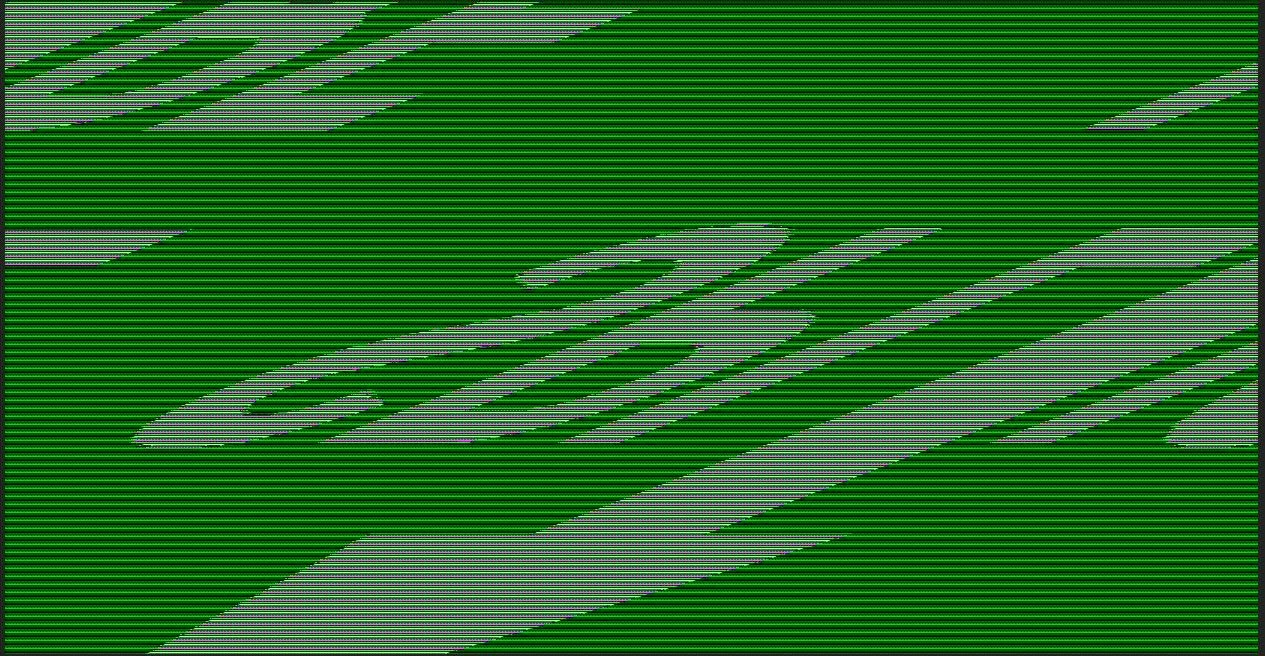

PAL Quicktime YUV 10bit Uncompressed exports have corrupt video
Source video: PAL 720x576 4x3 Uncompressed YUV 10 bit Quicktime, uncompressed PCM Audio
Export format: Match Source (Uncompressed YUV 10 bit, Quicktime)
Adobe Premiere/ME 24.6.1
OS Sonoma 14.6.1
M2 Mac mini Pro 12 Core 32GB RAM
Internal HD for Premiere/ Stornext SAN fibre storage for media
AJA IO X3 Thunderbolt 3 for monitoring (v17.1)
Steps:
1. Load a PAL Uncompressed YUV 10 bit Quicktime into Premiere 24.6.1 project
2. Set in/out points
3. Right click on source clip and Export Media
4. Choose Format: Quicktime, Choose Video Codec: Uncompressed YUV 10 bit 4:2:2, Match Source
5. Export
Expected results: Trimmed QuickTime files to same spec as source that import and play video and audio fine in Premiere and Quicktime.
Actual result: All exports complete successfully but resulting files open with green scrambled video in Premiere and black video in QuickTime Player.
Exports attempted from master clip in project and from sequence made from clip, also tried exporting via ME.
Have tried turning hardware acceleration off in prefs as well.
Exporting the same clips in Premiere/ME 23.5 works correctly.
I HAVE to export to Uncompressed 10bit mov Prores etc not an option.
Adam.

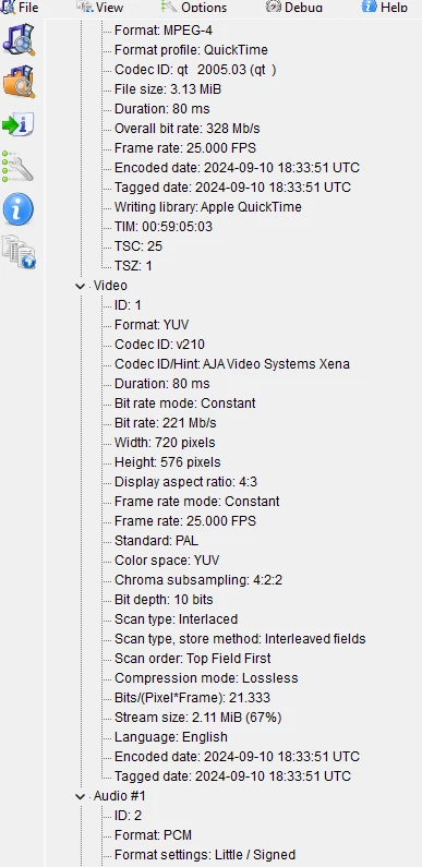

I had an editor at another facility test this issue on a Silicon Ventura mac running Premiere 2024.6.1 and he experienced the same fault. Could you please confirm Adobe is addressing this problem.
Av0101Author
September 10, 2024
Thanks. That's good to know that there is nothing wrong with the source file and that match source exports work on a PC. It must be an OSX Premiere 24.6.1 issue. Kevin, could Adobe now please test this issue on a Silicon mac? Should I message you the test file download link? Cheers, Adam.
MyerPj
September 10, 2024
BTW: I tried in in Both Beta 25.1.0 b5  and shipping 24.6.1 - Screen shot below from 24.6.1

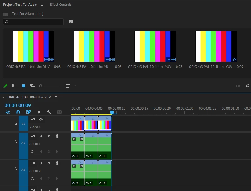

September 10, 2024
Hey @Av0101
It looks like it's working here. Every time I tried it it works.
Followed your instructions (it's hard to set in/out points in the project window with a 4 frame source clip, so I had to set the in/points in the source monitor. I loaded up your preset, even though it's just pretty much stock for the format you've selected. I exported via premiere and Media Encoder and all was well

Corrupt video export also occurs if exporting an uncompressed 10bit Quicktime from a 1080p25 sequence with just an Adobe Universal Counting Leader in sequence. The resulting file is digitally garbled when imported back in. Could anyone running Premiere 24.6.1  on Sonoma Silicon mac please check? Much, appreciated. Adam
