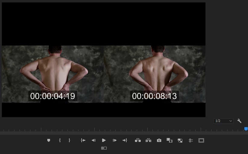

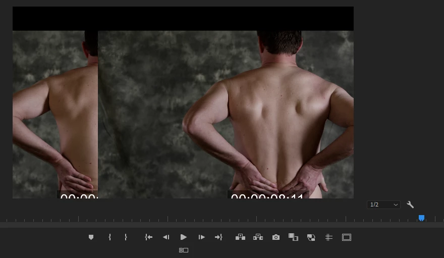

This bug is back in the latest Premiere Pro 25.2.3 and latest Premiere Pro 24.6.5! In PR24 if you use "set to frame size" you don't get this bug. But when you use "scale to frame size" and use the slip tool, both 24 and 25 latest version have the scaling glitch. See picture. What I notice is that in PR25 "fit to frame" does not have this bug. I'm not sure why they removed "set to frame size".
It is better becuase it acts the same as scale 1080p clip 200% to fill a UHD sequence, then nesting that, so it has the same 100% scale on the motion control in effect controls window. But nesting lower res clips so they can have the same scale amount as the higher res clips, does not make sense and would be awful.
SO TLDR:
1. bring back "set to frame size"
2. fix the "scale to frame size" slip tool program viewer bug
