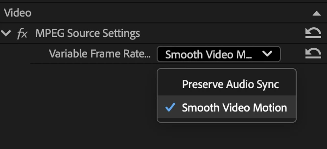

    Hi ​@salazar_murilo,
    If your DJI Mavic2Pro.mov files are Variable Frame Rate (which is common), Premiere will default to “Preserve Audio Sync” instead of “Smooth Motion” which can cause stuttering on the timeline. You can change this setting by loading the clip in your source window and opening your Effects Control Panel and changing the dropdown there.
    Be advised that the sound of Variable Frame Rate footage does tend to go out of sync with the audio. This is a known issue across all NLEs if you do not first conform it to Constant Frame Rate using Media Encoder.
    Please let me know if this solves your issue.

    Jun 27, 2026 8:59 PM UTC
    Thank you for the suggestion.
    I tested this on exactly the same DJI footage and the same computer.
    The key point is that the footage plays perfectly in Premiere Pro 26.2.2, but becomes extremely choppy immediately after updating to 26.3.
    Nothing else changed:
    • Same Windows installation
    • Same NVIDIA RTX 3000 Ada Laptop GPU
    • Same Lenovo workstation
    • Same project
    • Same DJI files
    Downgrading back to 26.2.2 immediately restores perfectly smooth playback.
    Because the exact same VFR files work correctly in 26.2.2, this seems more like a regression introduced in 26.3 than an inherent Variable Frame Rate issue.
    I will still test the "Smooth Video Motion" option and report back with the results.
