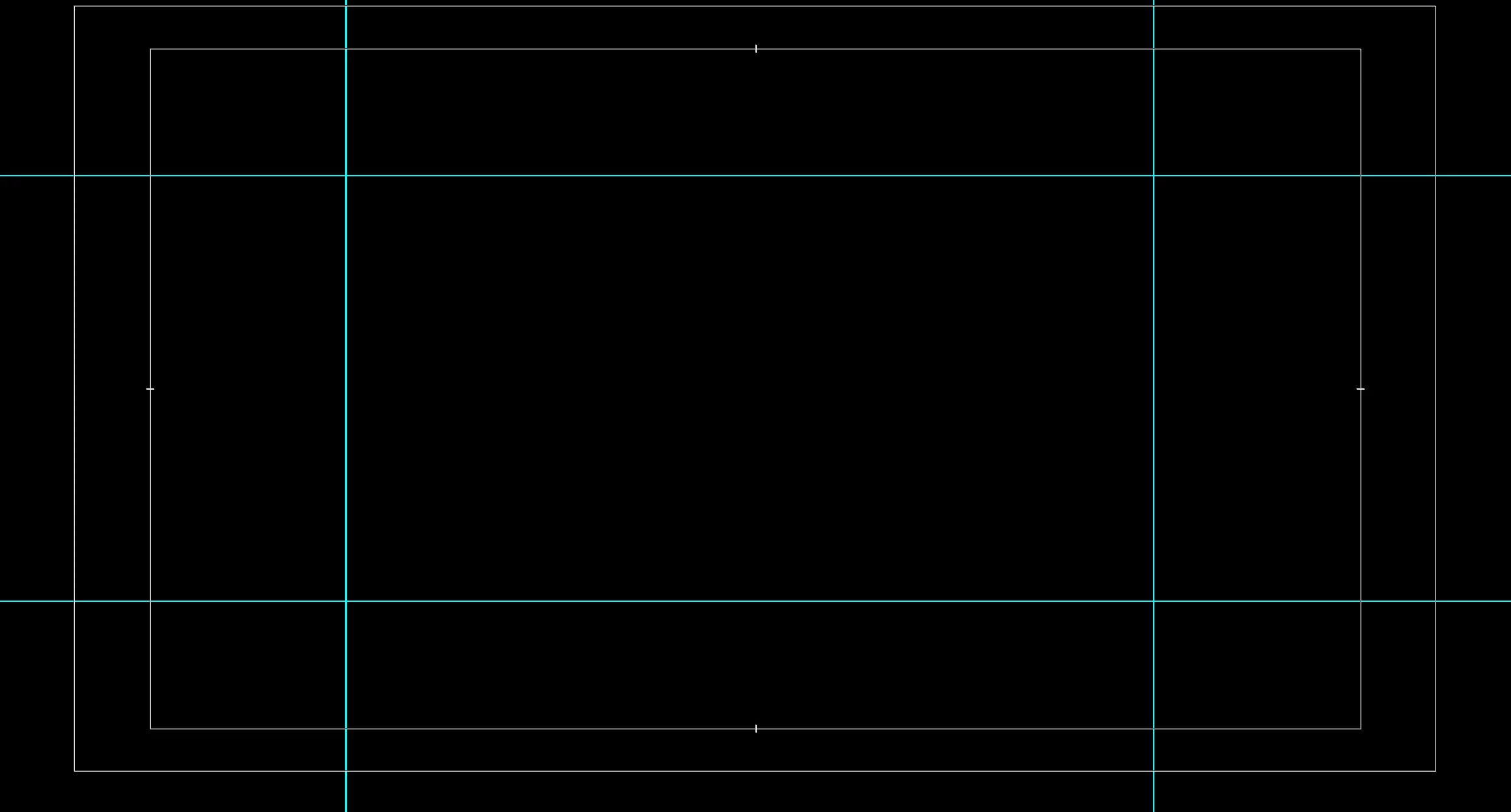

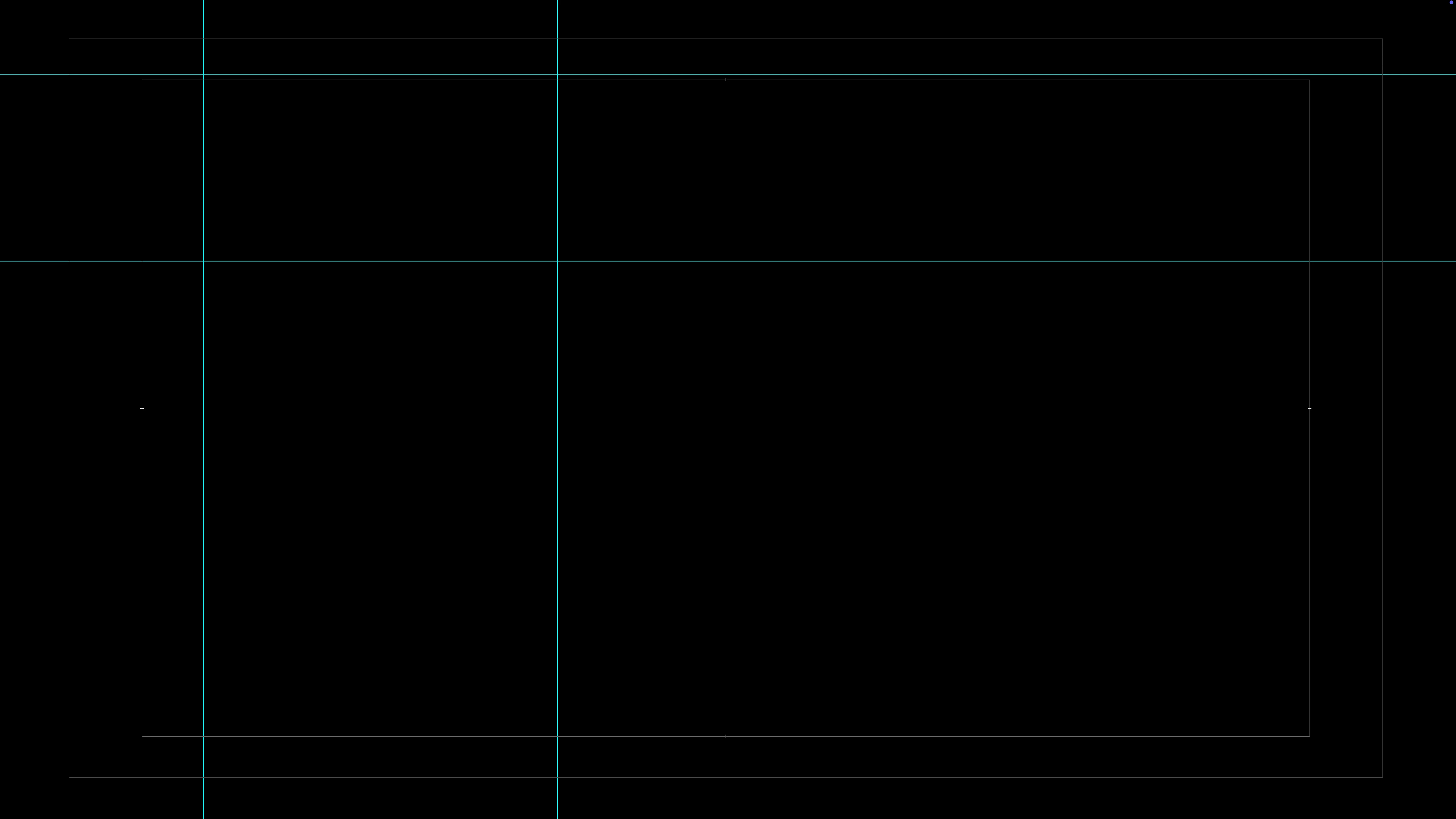

"Show Guides" not working correctly in full-screen mode
In Premiere 26.0.1, when I create guides in the program monitor, they work fine. But when I switch to full screen, the guides are present but they are not correct.  See attached.  Running Premiere 26.0.1 on a 2025 Mac Studio running Sequoia 15.7.4

    As a workaround, until this is fixed, create an image with guides and transparency in Photoshop and place it on a video track in Premiere Pro.
    IanB_360
    Feb 19, 2026 11:28 PM UTC
    Hi ​@dcs1977
    Welcome to the Premiere community. Thank you for taking the time to report a problem. I can reproduce this on our end with 26.0.0, 26.0.1, as well as the BETA v26.2. We are currently looking into this and will have an update as soon as possible.

    I confirm that behavior, V26.01, win 11.
    But, I wonder why you would need to see guides in the full screen mode, which is intended for previewing final video. Anyway, you can’t see masks, transform controls, crop controls and all other visual aids.
    dcs1977
    dcs1977Author
    Feb 15, 2026 11:12 PM UTC
    Glad to see it's not just me.  It's useful to toggle full screen mode with the guides on when I’m lining up text and graphics to the guides so it helps to toggle full screen on so I can see everything bigger.  Either way, its clearly not working correctly
