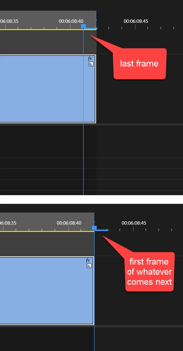

In Premiere 2026 whenever I insert paste, even though I position the playhead on the last frame of the outgoing clip, a single frame of that clip (the one I am positioned on) gets moved the end of the clip I am inserting. Then I have to go to the end of the newly pasted clip and remove the single frame at the end of the edit.
Weirder issue - If I advance the playback head one more frame to the right, so that it is now on the first frame of the clip which is about to be moved right after the paste insert command, then there is STILL a single frame artifact….and this is the weird part, the single frame is pulled from the B side clip of the clip that follows the pasted clip in previous location (wherever I copied it from).

R Neil Haugen
Apr 4, 2026 5:19 AM UTC
Just a note ... the playhead never floats! It is always connected to the next frame.
So if you go to say the end of a sequence, and export, there will always ... correctly! ... be one ‘extra’ black frame.
You need to go to the last frame of a clip, not past it, with the CTI. That surprises a lot of people.
