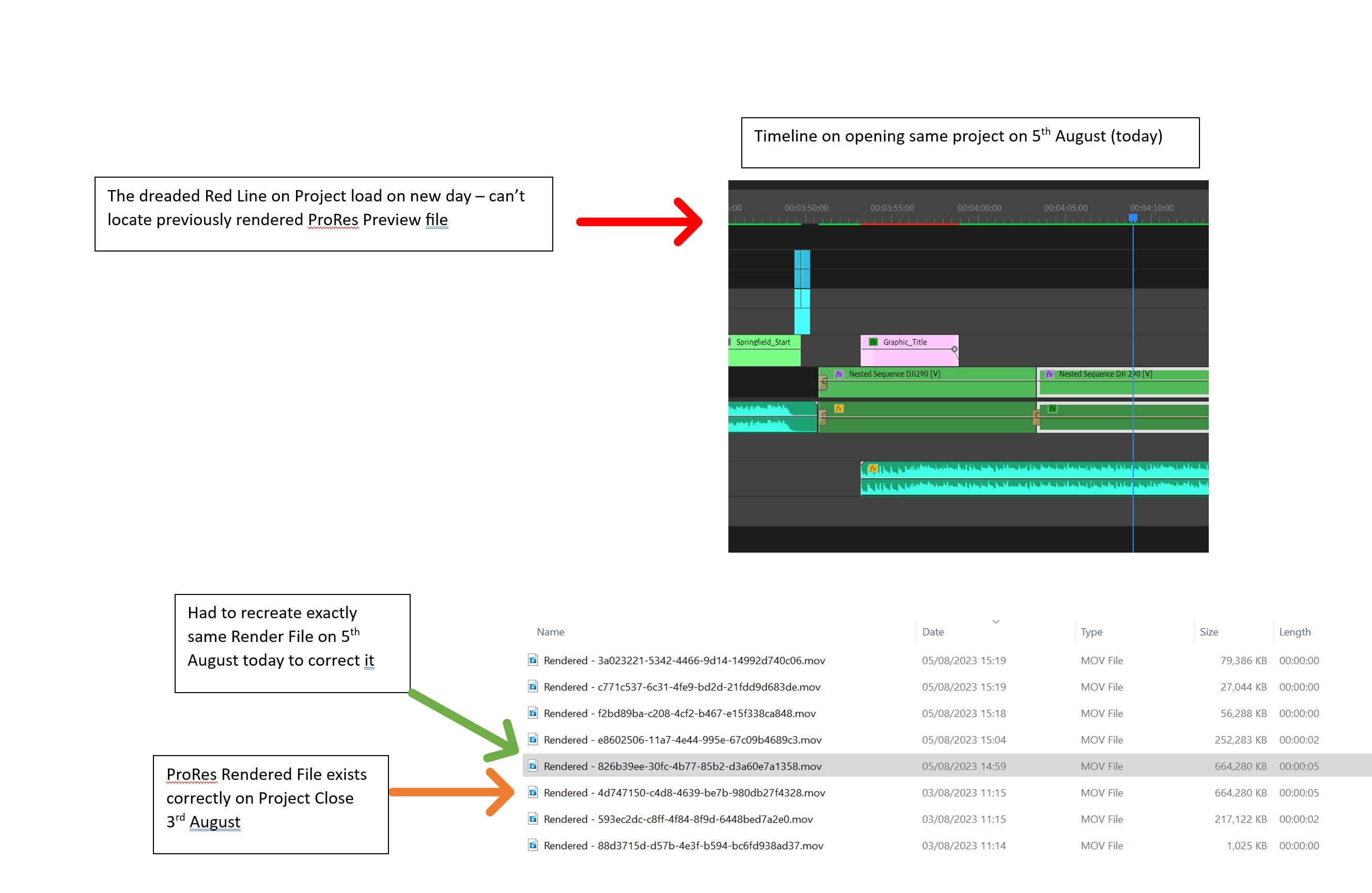

JonesVid
JonesVidCommunity ExpertAuthor
August 5, 2023
Just to illustrate an example today see attached pdf.
I opened the latest Premiere project I am working on and guess what - the dreaded Red Line on timeline which means Premiere cannot locate the ProRes preview file already created.
I had to create yet again the same file to fix this.
It is becoming annoying.
Hopefully someone from Engineering will respond ?
