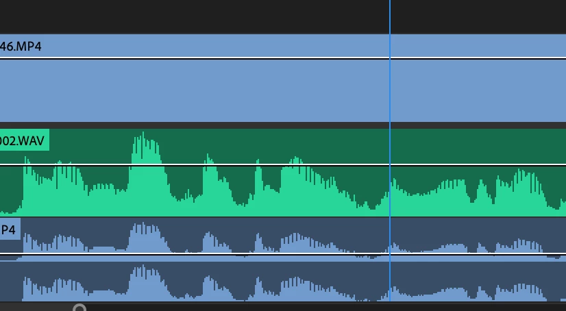

Hi, we record our footage on a Sony A7s3 in the 4k HEVC 10-Bit. Whenever we import the footage into Premiere Pro, the audio is out of sync with the footage by about 1 frame. We noticed this because we also use the H.264 proxies recorded by the camera. When we toggle the proxies, the footage stays in the same spot, however the audio waveform shift by about 1 frame. The thing is the proxy's (h.264) waveform is correctly synced with the video, but the original media's waveform is not.
I did a test by recording  H.264 on our Sony A7s3, and that footage was synced correctly when we imported it into premiere pro, so it seems it is only an issue with the HEVC Codec.
I importat the HEVC files into DaVinci resolve, and they are correctly synced there. So it seems to also be any issue in premiere pro.
Right now our solution is just to manually sync the video to our external audio recorder's audio file.
We'd like to continuing editing in premiere because our workflows are based around it, but this issues causes alot of errors and slows us downl. Does anybody have recommendations on if this issue is common, and/or if it can be fixed?

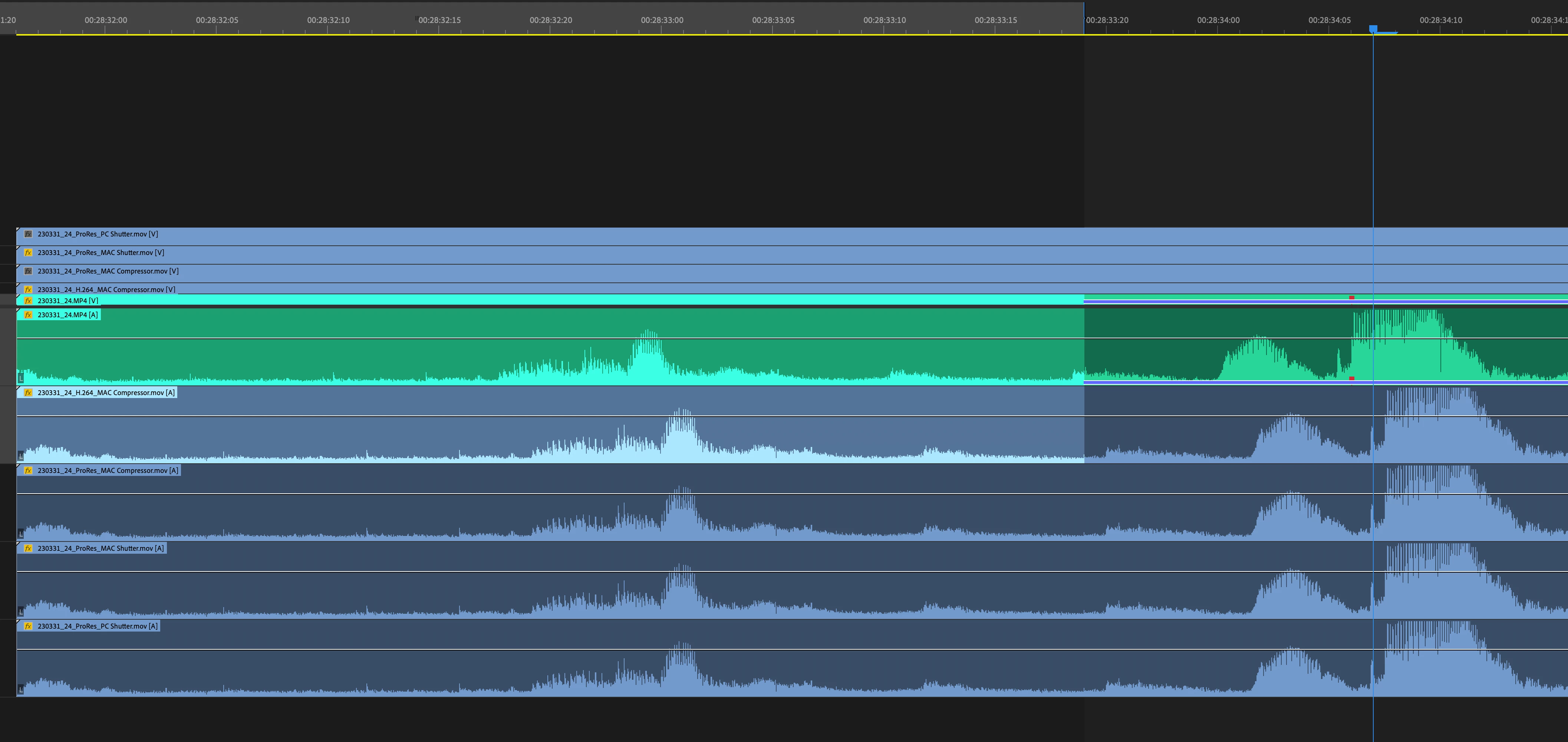

Hi I have same problem with editing Sony FX3 files.
I want to make proxy files and editing with them, but I can't make proxy with Media Encoder, because it doesn't support mov with h264 codec.
So I must make with different program and there is the problem. When I convert-make proxy, audio in resulting file is with 1-2 frame delay.So when I finish editing and watch with original file I was very surprise that audio cuts and keyframe is not in the right place and some parts of word are cut.
I have PC and MAC and the problem is on both system.
Software for proxy that I try on MAC is: Final Cut, Resolve, Shutter encoder
Software for proxy that I try on PC is: Edius, Resolve, Shutter encoder
Then I start to compare audio waveform of Source-Original(not proxy) video file on every program, and then I see that on Final Cut, Resolve, Edius audio is in the same position except in Premiere pro, where is with 1-2 frame desync. In the screenshot in Premiere you can see audio waveform on Track 1 is "ahead" and cut from beginning, compare to all other tracks.
I check different version of Premiere v23.3 and v15.4.5 on PC and MAC and it is the same.
I think the problem is how Adobe implement Sony XAVC decoding.

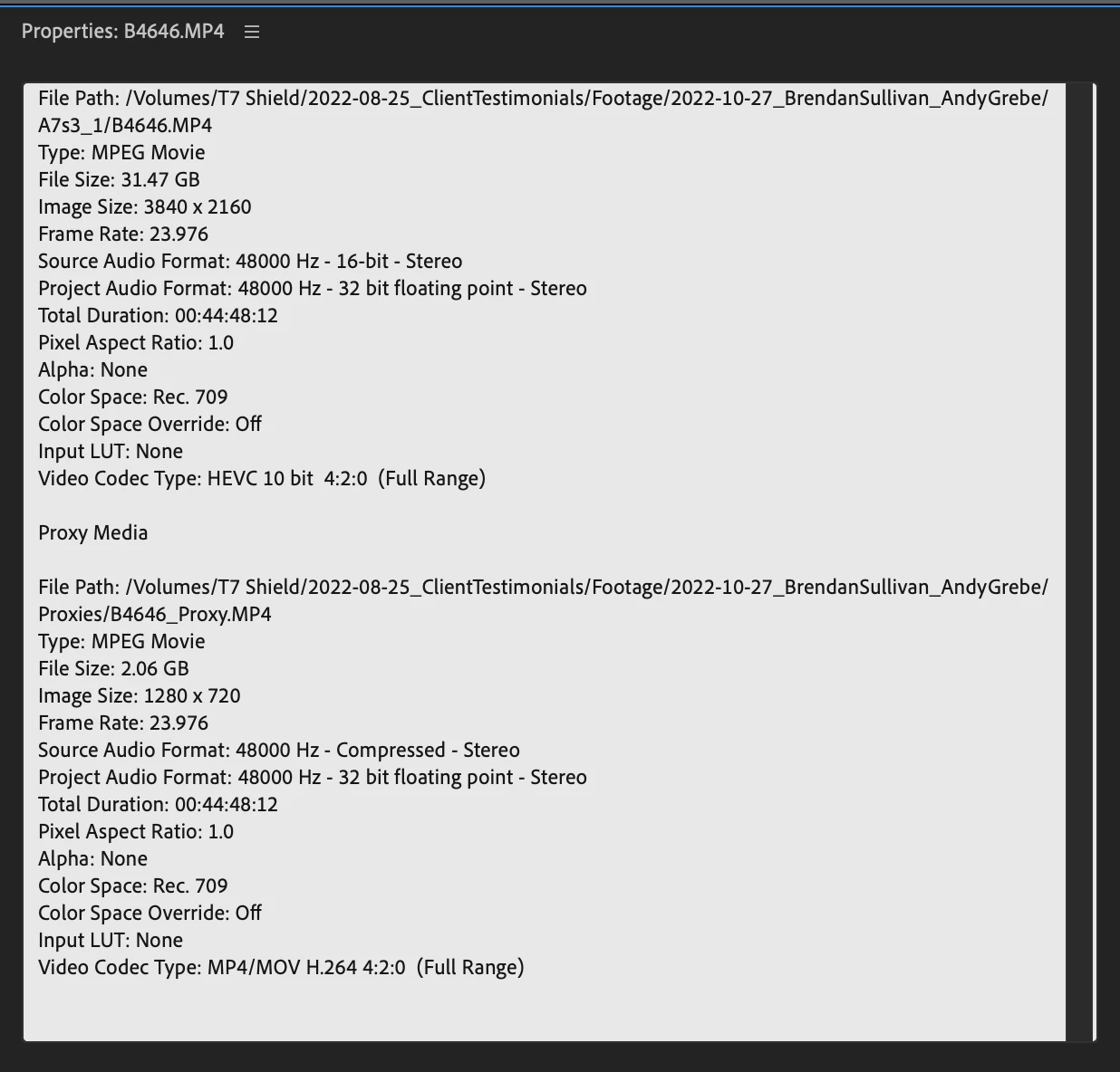

...the H.264 clips that are in sync have their video and audio in Media Info off by about 3-5 ms as well. other editing programs seem to have both H.264 and H.265 footage in sync.
Ah, interesting. Thanks for letting me know.

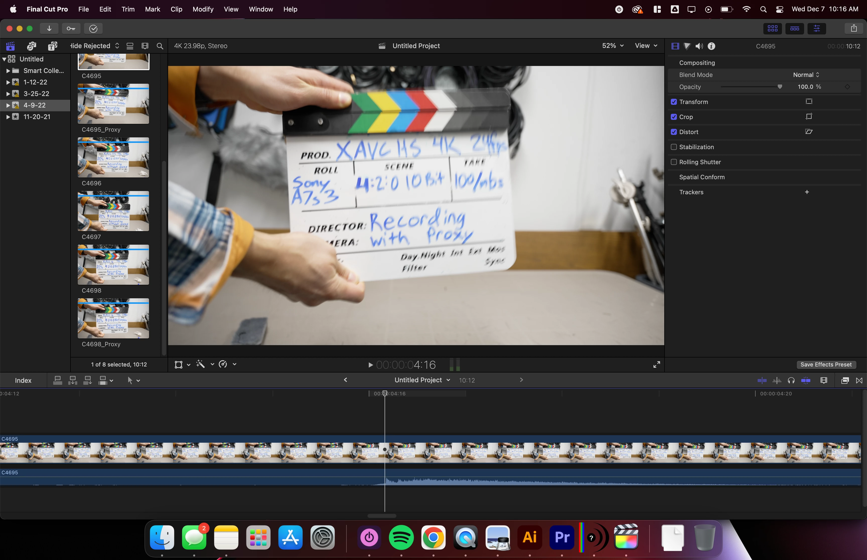

I just tested importing the footage into Final Cut Pro X and the H.265 footage is in sync there.
Thanks, the devs will appreciate those findings. Other NLEs and Premiere Pro are not always aligned in how long GOP footage is interpreted or handled. Check out this bug report; It leaves me curious about what's going on in those labs.

Unfortunately I don't think that's the issue because the the H.264 clips that are in sync have their video and audio in Media Info off by about 3-5 ms as well. And other editing programs seem to have both H.264 and H.265 footage in sync.
I just tested importing the footage into Final Cut Pro X and the H.265 footage is in sync there, which is why is why I think it something specific to the way Premiere Pro is reading the footage.

Thanks for doing all the screenshots. MediaInfo shows that the audio and video streams have different durations. Do you suppose that could be the issue? Let me know.
