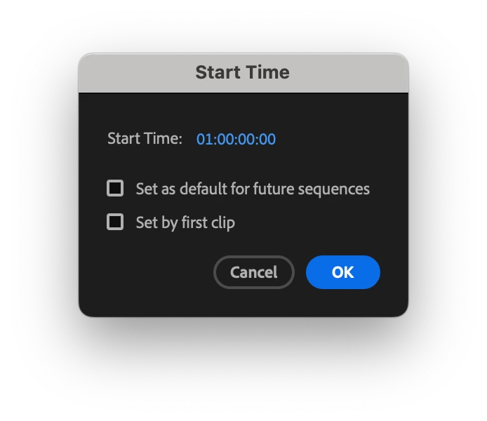

Warren Heaton
May 2, 2025
@dmehalik
What are your Start Time settings for your Sequences?
dmehalikAuthor

dmehalikAuthor
May 1, 2025
yikes, well if that 's the case, I def. don't have the know-how to fix it.  I think I'll just have to work around the issue.  Thanks for your time!
