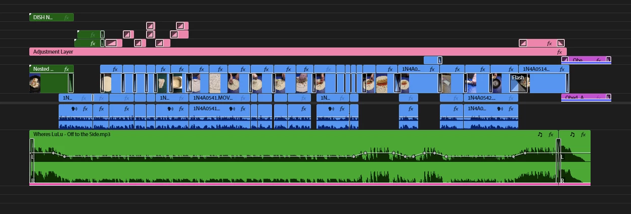

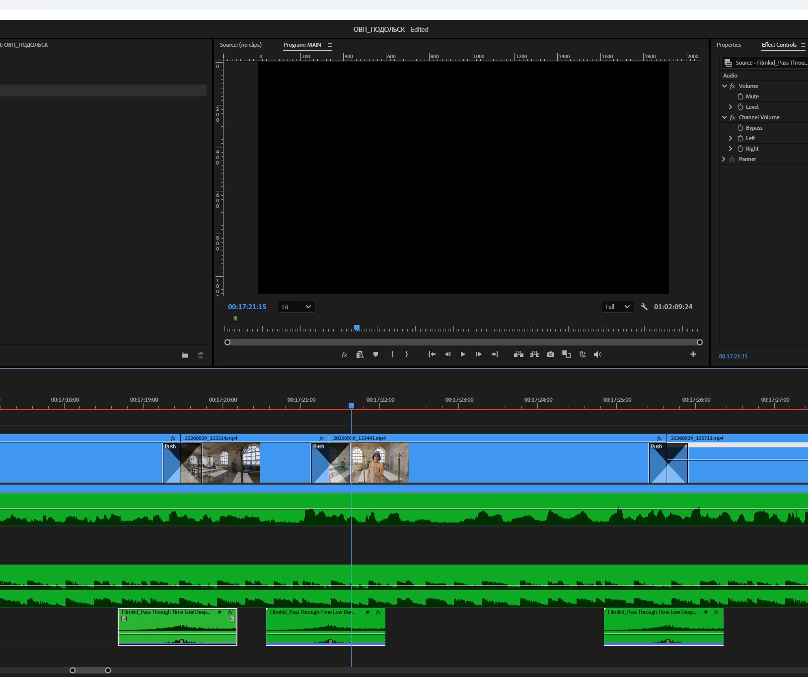

I’ve started to get black frames at the end of transitions. I know that there was this problem in Premiere 24, but I have never had this issue, but now I do in Premiere 26.0.2.
  • It happens randomly and I could not define the circumstances.
  • It happens bot with third party transitions and the native ones. I first saw the black frames in the Production crate transitions, so I emailed them but they could not reproduce it. Now it turns out that it can happen with Premiere’s own transitions like dissolve or ex-FilmImpact, Push for example (you will see it in the video below, that it happens with Push bit BorisFX transitions immediately have no issue, and thew issue comes back when I apply another Premiere Pro transition)
  • It happens with normal clips, nested or time-remapped ones.
Here’s how it looks:
Steps to reproduce: start Premiere, work on a project, add a transition.
Pr 26.0.2, Win11 25h2, RTX 4080 with latest NV drivers, i7-14700K

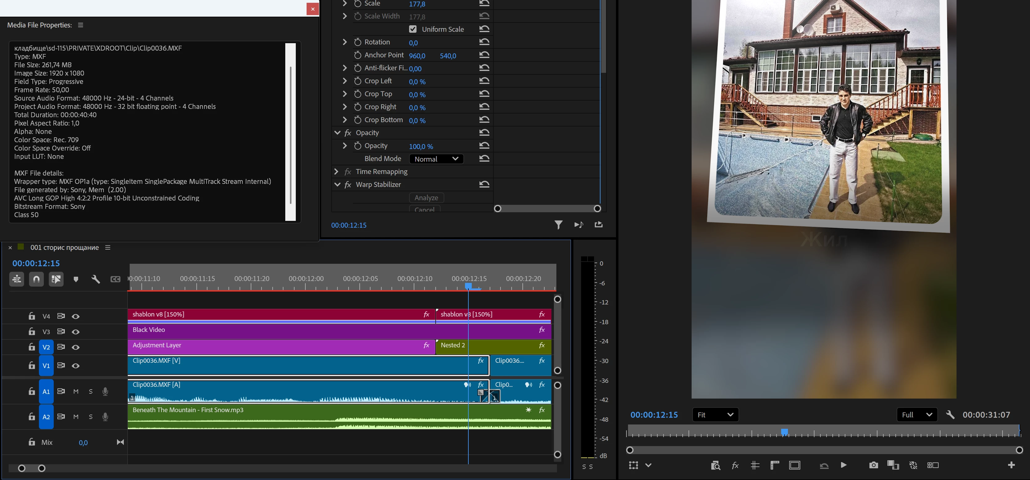

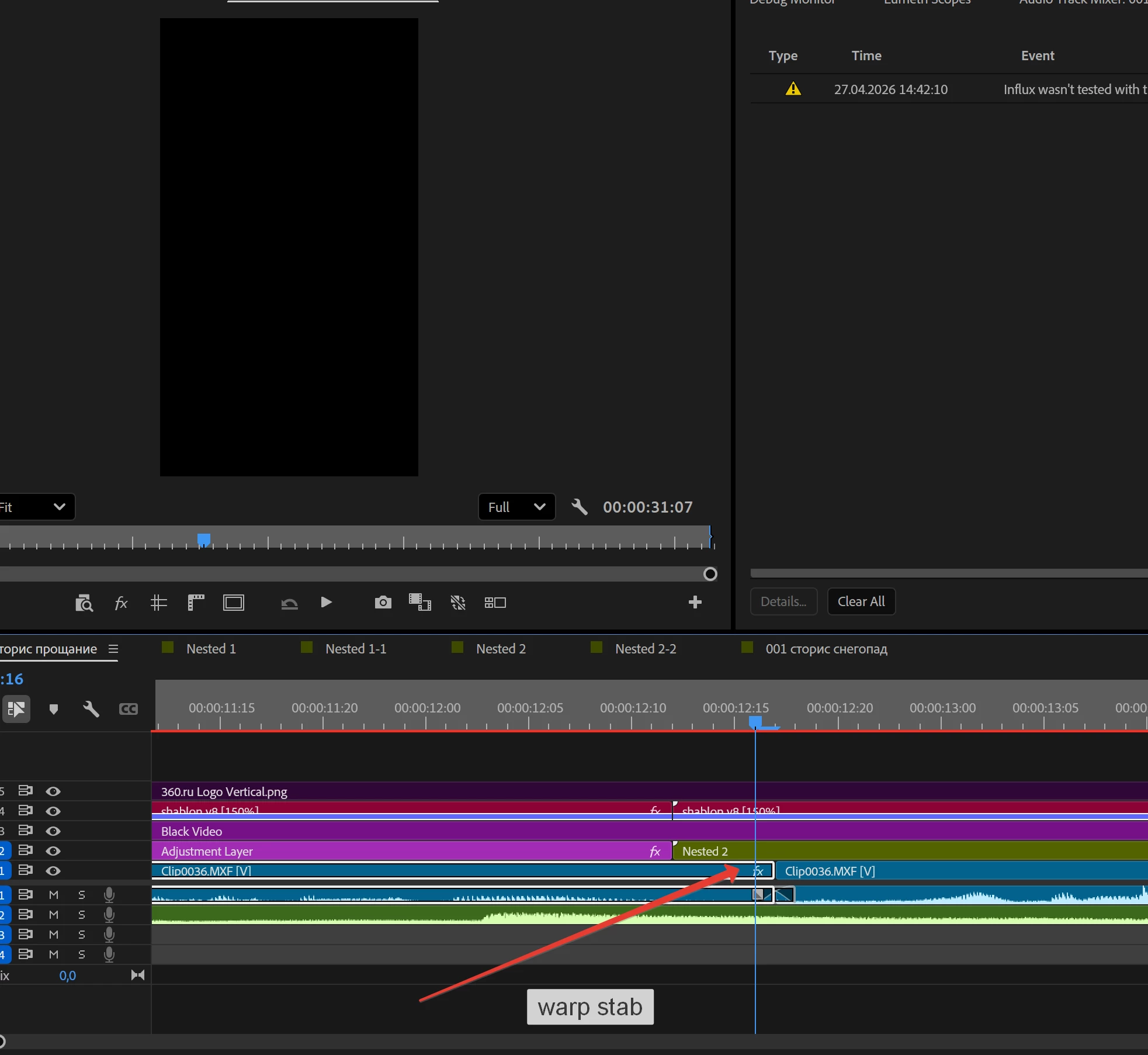

    I occasionally run into the same issue when I apply stabilization.
    But today was very unusual. A black screen appeared over the top (non-transparent) layer, completely covering the image. Opacity is set to normal. There’s no alpha channel. It’s just a full-resolution image. But the black frame from the bottom layer v1 is covering the image from the second layer v2.
    In the screenshot:
    v1 - video from phone + warp stab
    v2 - nested 2 - full-screen PNG image
    v3 - semi-transparent mask for text
    v4 - text layer
    v5 - disabled

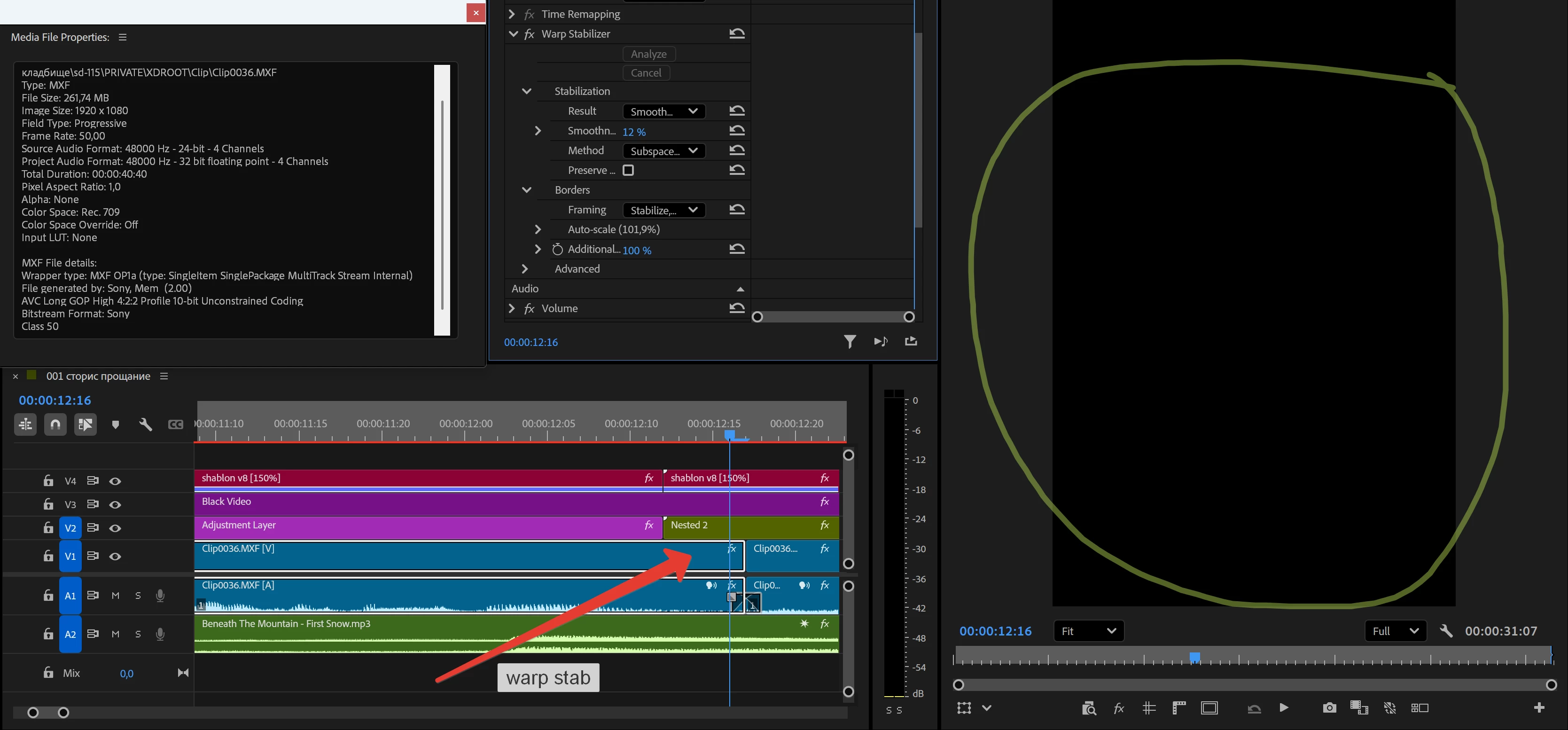

    Vibrant_A1983
    Apr 27, 2026 1:56 PM UTC
    This way, you can see it better. Two adjacent frames.
    Premiere 26.2
    Windows 11 24h2
    14900k+rtx5080+128Gb ddr4

    An update. I’m on v.26.2 now and now it started to happen with… Warp stabilizer! This is bad… It’s a new project I started today, it’s empty - just the cut video on the timeline.

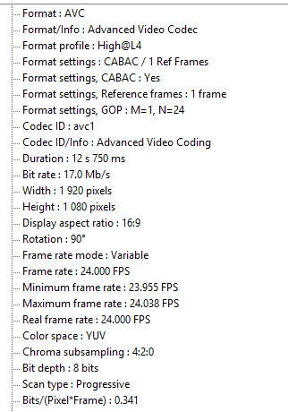

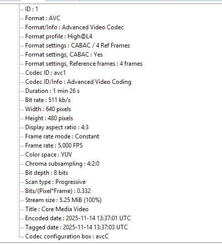

    AndrewTheGreat
    Mar 31, 2026 4:10 PM UTC
    Hi, ​@Rach McIntire
    The media it 100% happened with was this (this is where the Production crate transitions gave the black frame):
    and this - yesterday’s project with the Push transition used:
    I tried to copy and paste the media into a freshly started project and the black frame appeared there too. I should also mention that it did not happen on every clip. Here you can see this project still has transitions - all of them are Push and they worked. Once I came across one cut there the transition gave ma a black frame I had to use another transition:
    All the black frames that appeared could be seen during scrubbing, playing back and in the final render.
    Stop trying to edit and EDIT!
    Apr 1, 2026 5:44 PM UTC
    hi ​@AndrewTheGreat ,
    Thanks for MediaInfo!  I see a couple of interesting things.  The first clip is 5 fps, which is an unusual framerate but constant. I’ll have to test to see if that's part of it.  The second clip is VFR, which might also be a contributing factor.  Would you be able to send me those specific clips to test with?
